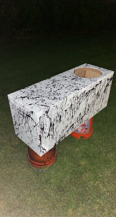

Dafaseles Posted August 9, 2021 Report Posted August 9, 2021 1 hour ago, Mattc43 said: Already got both sundown 15s!! Yeah I'm starting to see that electrical is hella expensive. Whole reason I picked the taramps smart 5k is because people said it's a great bang for the buck amp and will do 5000watts at 2ohms which is what both my dvc dual 2 ohm subs will be wired to (wish I would've bought two 4ohm dvc 15s to wire down to 1 ohm but did not realize this at the time I bought em 😒). I would love to do a build log! You've got me sold on that and I will definitely have some questions and will get stuck at certain points. Already got the box building skills down too hehe (look below (double baffle, 3/4 mdf, 1 5/8" drywall screws every two inches, screw holes topped off with bondo, 3 coats of binz shellac based primer, splattered black "oil based" paint to finish it off)) That is a nice looking box! Did you model it on a computer program? I wish I could understand box modeling programs lol. 2011 Chevy Silverado under construction My build log here. Check it out!
Mattc43 Posted August 9, 2021 Author Report Posted August 9, 2021 15 minutes ago, Dafaseles said: That is a nice looking box! Did you model it on a computer program? I wish I could understand box modeling programs lol. Thank you! I am pleased with how it performs too. Yes, I did not model/design it myself though. I actually had a guy on facebook design it for me for $25. I don't understand box designing either lol that is why I said to hell with it and paid for someone to do it for me
Dafaseles Posted August 9, 2021 Report Posted August 9, 2021 22 minutes ago, Mattc43 said: Thank you! I am pleased with how it performs too. Yes, I did not model/design it myself though. I actually had a guy on facebook design it for me for $25. I don't understand box designing either lol that is why I said to hell with it and paid for someone to do it for me I did the same exact thing. I paid a dude to design it right. Now I just need to assemble it🤣 2011 Chevy Silverado under construction My build log here. Check it out!
