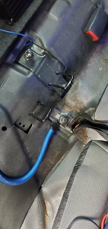

Never Enough Bass Posted September 4, 2021 Report Posted September 4, 2021 I just installed all my stuff upgraded the amp and added a battery but when I shut everything down I get a little pop noise out of the subs can anyone explain this to me 06 Charger Pioneer double din Pioneer 6.5 and 6×9's Knukoncept Krystal kable rca's 0 ga knukoncept kolossus wire Big 3 same wire ^ 1 run 8g karma ss speaker wire Sundown sia 3500d at 1ohm 2 Sundown U series 12's Duralast platinum agm H7 (Main) Xs power d3400 Trying to find a ho alt
stingray72 Posted September 4, 2021 Report Posted September 4, 2021 Check your grounds thats the first thing that comes to mind with your issue.
Never Enough Bass Posted September 4, 2021 Author Report Posted September 4, 2021 Yea all good grounds both battery's are on there own factory location sanded down with a wire wheel post back of nut got it all and the amp is grounded to the seat belt bolt sanded down didn't do this with the old amp I had only thing I added was the amp and a second battery and wires to the battery 06 Charger Pioneer double din Pioneer 6.5 and 6×9's Knukoncept Krystal kable rca's 0 ga knukoncept kolossus wire Big 3 same wire ^ 1 run 8g karma ss speaker wire Sundown sia 3500d at 1ohm 2 Sundown U series 12's Duralast platinum agm H7 (Main) Xs power d3400 Trying to find a ho alt
Dafaseles Posted September 4, 2021 Report Posted September 4, 2021 13 minutes ago, Never Enough Bass said: Yea all good grounds both battery's are on there own factory location sanded down with a wire wheel post back of nut got it all and the amp is grounded to the seat belt bolt sanded down didn't do this with the old amp I had only thing I added was the amp and a second battery and wires to the battery You could try grounding the amp to the battery. When you upgraded the amplifier, maybe that seat belt ground isn't sufficient enough for the new amplifier. 2011 Chevy Silverado under construction My build log here. Check it out!
Never Enough Bass Posted September 4, 2021 Author Report Posted September 4, 2021 06 Charger Pioneer double din Pioneer 6.5 and 6×9's Knukoncept Krystal kable rca's 0 ga knukoncept kolossus wire Big 3 same wire ^ 1 run 8g karma ss speaker wire Sundown sia 3500d at 1ohm 2 Sundown U series 12's Duralast platinum agm H7 (Main) Xs power d3400 Trying to find a ho alt
stingray72 Posted September 4, 2021 Report Posted September 4, 2021 17 minutes ago, Dafaseles said: You could try grounding the amp to the battery. When you upgraded the amplifier, maybe that seat belt ground isn't sufficient enough for the new amplifier. I was suspecting the seat belt ground as well.
Never Enough Bass Posted September 4, 2021 Author Report Posted September 4, 2021 So I'll move the ground then to the battery 06 Charger Pioneer double din Pioneer 6.5 and 6×9's Knukoncept Krystal kable rca's 0 ga knukoncept kolossus wire Big 3 same wire ^ 1 run 8g karma ss speaker wire Sundown sia 3500d at 1ohm 2 Sundown U series 12's Duralast platinum agm H7 (Main) Xs power d3400 Trying to find a ho alt
Dafaseles Posted September 4, 2021 Report Posted September 4, 2021 4 minutes ago, Never Enough Bass said: So I'll move the ground then to the battery If you do that, I would add another ground for that battery as well. Hook it up and try it, and if you still have the same issue, or you see your voltage becoming not as stable as it was, at another battery ground 2011 Chevy Silverado under construction My build log here. Check it out!
Never Enough Bass Posted September 4, 2021 Author Report Posted September 4, 2021 Yea I'm just gonna have to figure something out or what if I get a dual 0 gauge adapter and just add another ground to the amp would that work 06 Charger Pioneer double din Pioneer 6.5 and 6×9's Knukoncept Krystal kable rca's 0 ga knukoncept kolossus wire Big 3 same wire ^ 1 run 8g karma ss speaker wire Sundown sia 3500d at 1ohm 2 Sundown U series 12's Duralast platinum agm H7 (Main) Xs power d3400 Trying to find a ho alt
Dafaseles Posted September 4, 2021 Report Posted September 4, 2021 15 minutes ago, Never Enough Bass said: Yea I'm just gonna have to figure something out or what if I get a dual 0 gauge adapter and just add another ground to the amp would that work If you do that, I wouldn't put the new ground in that seat belt bolt. Someplace else, as close as possible 2011 Chevy Silverado under construction My build log here. Check it out!
