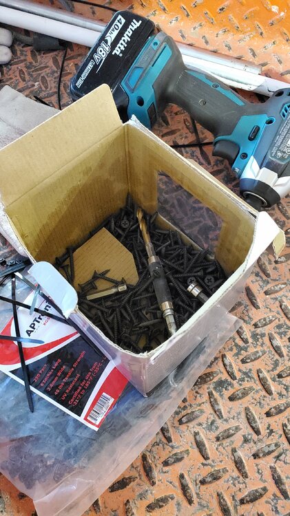

I stopped off at the home store on my way back from my PT appointment to grab some more nails as I was running low.  Hard to imagine that I've already run through almost 1k nails:
I think after I finished the work I did today, I have 1 or 2 strips left.  Going to have to break into the new box tomorrow.

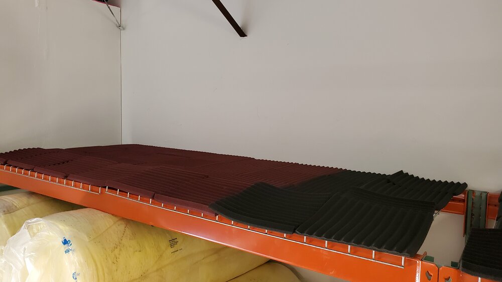

I ordered some cheap foam sound dampeners for the office so it doesn't sound like I'm in an underground dungeon when I'm on my DJ calls.  They come super compressed and you have to peel them apart and let them sit for a day or two in order for them to expand and off-gas:
I laid a bunch more of them out and still have more to sperate, I think it will be an on-going task for the next week or more.

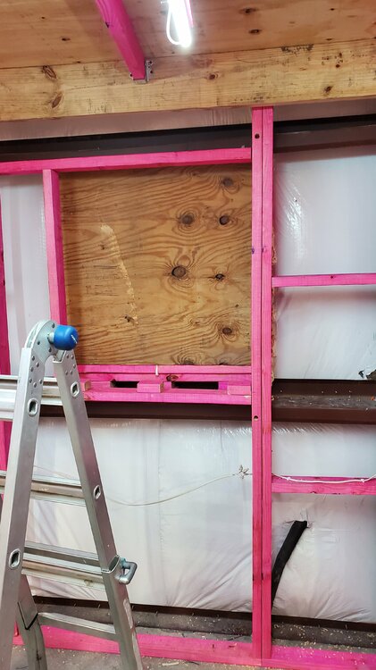

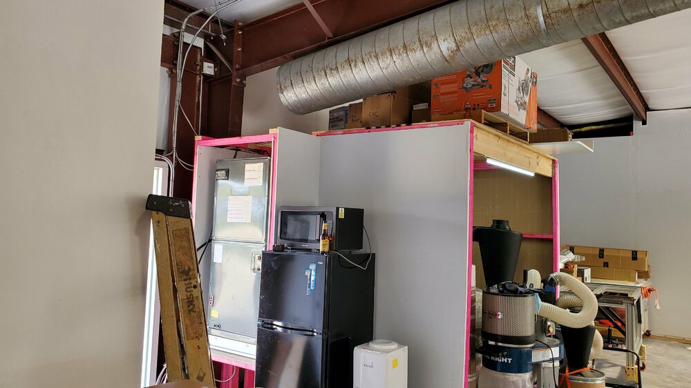

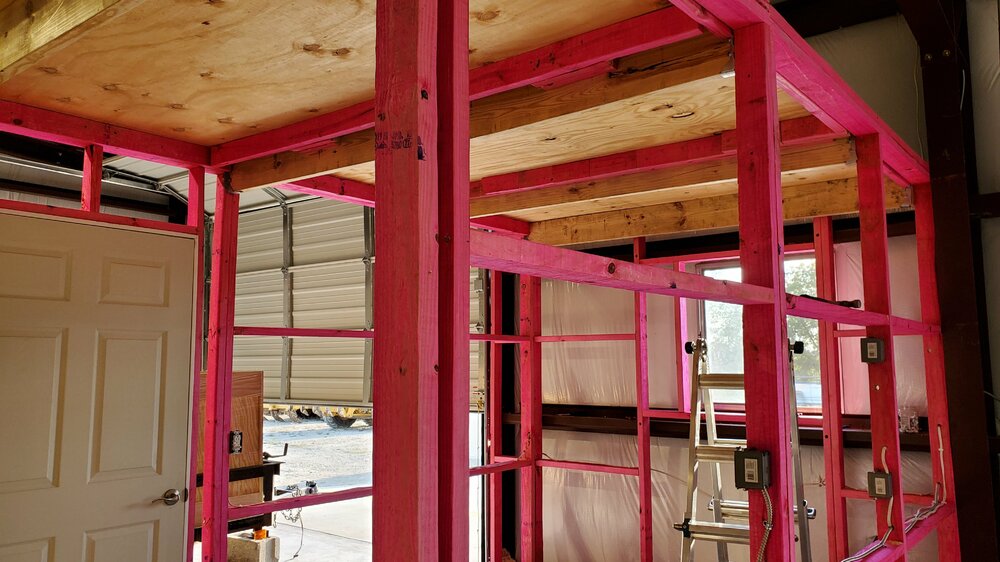

I was able to get the laser room studded out, the joists up, the door in and almost finished the electrical:

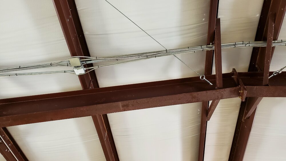

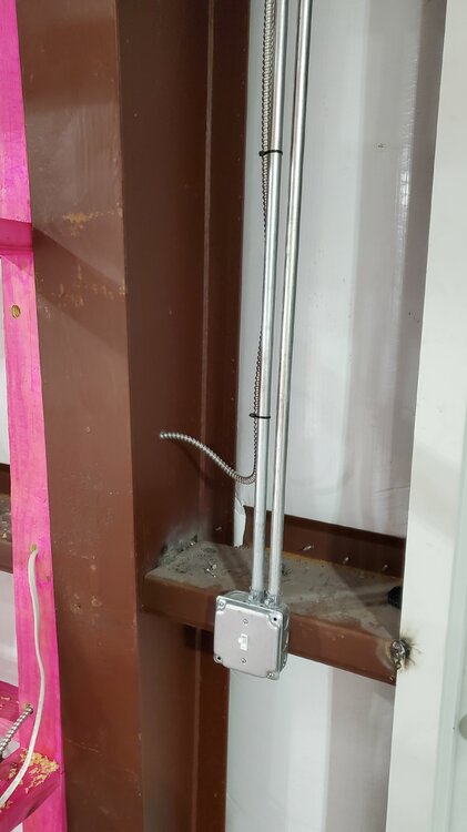

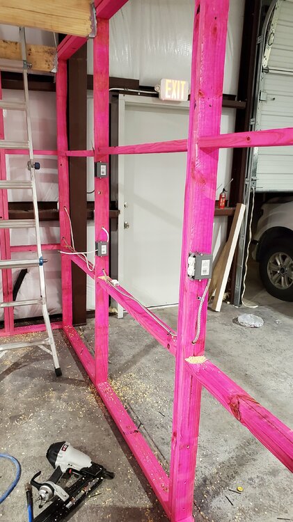

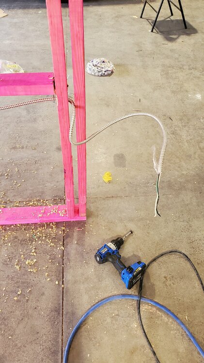

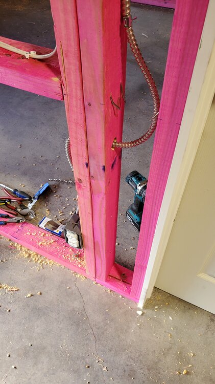

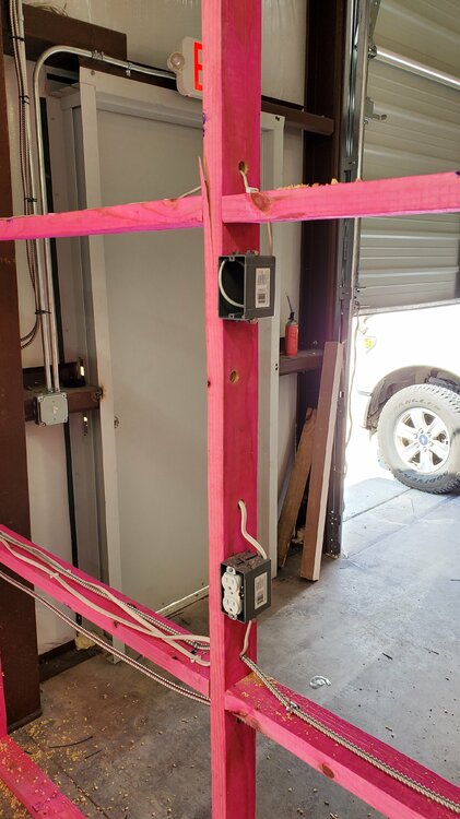

I pulled a run of MC 12 AWG for a 20A circuit and re-purposed the metal conduit I pulled off the south wall to run some 14 AWG romex for a 15A circuit:
I still need to run a pair of network cables (one for a security camera at the front door and one for the computer that controls the laser) and finish roughing in the laser room's electrical.  Then I need to build a big gate style double door on the end that will make putting the laser in there a lot easier (need to do the same for the dust collector room).  Hopefully that will go fairly quickly tomorrow.

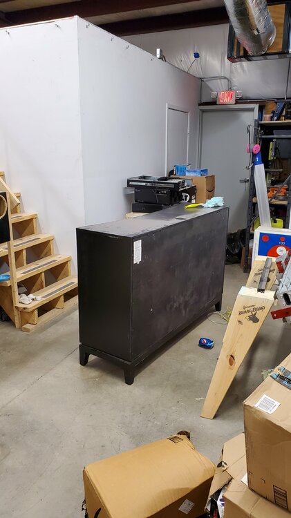

 This dresser was nearly the death of me:

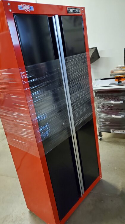

 And got some more stuff ready to move:
I even managed to get a couple of the cabinets loaded on the trailer along with the sheathing I picked up from the home store:

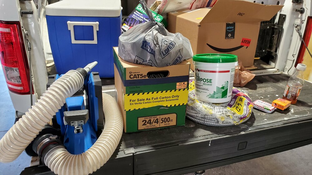

Picked up some more power and data cabling, finally found the 40A 2-pole breakers I needed and some assorted other stuff:

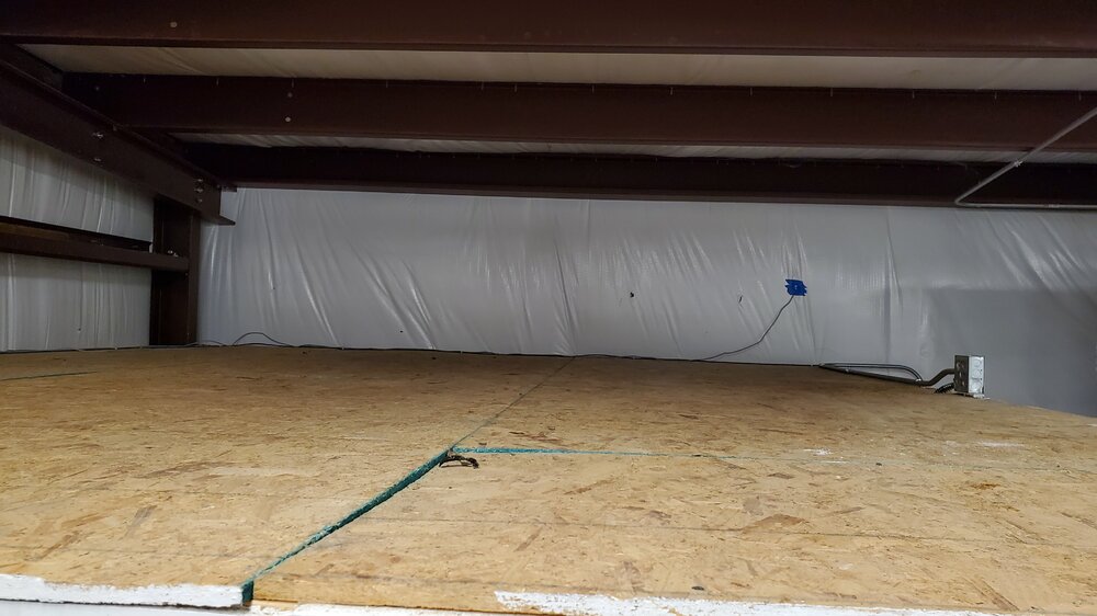

Got the sheeting up on the laser room:

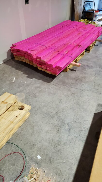

And I'm steadily burning through building materials:
Over 1k framing nails down...
At the bottom of a 5lb box of drywall screws...
Starting to run low on 2x4s...

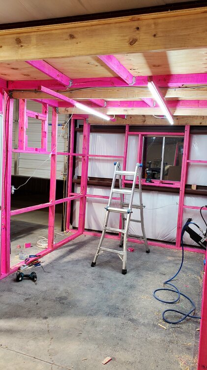

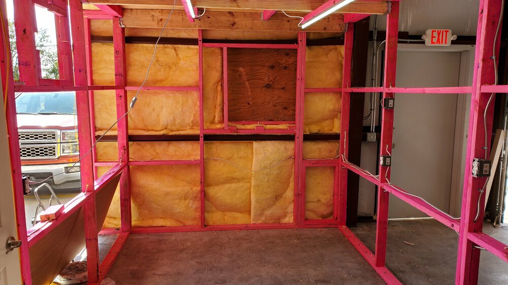

Was able to get the 2x4 joists up on the laser room:
And threw another outlet that will face outside of the room off the 20A plug:

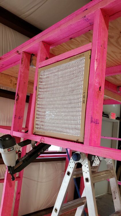

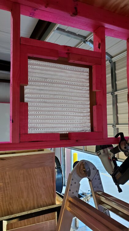

Built the filter box to filter air coming into the room when the exhaust is on:
Got some lights in:

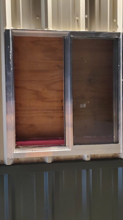

And secured the window where the portable A/C will vent out:

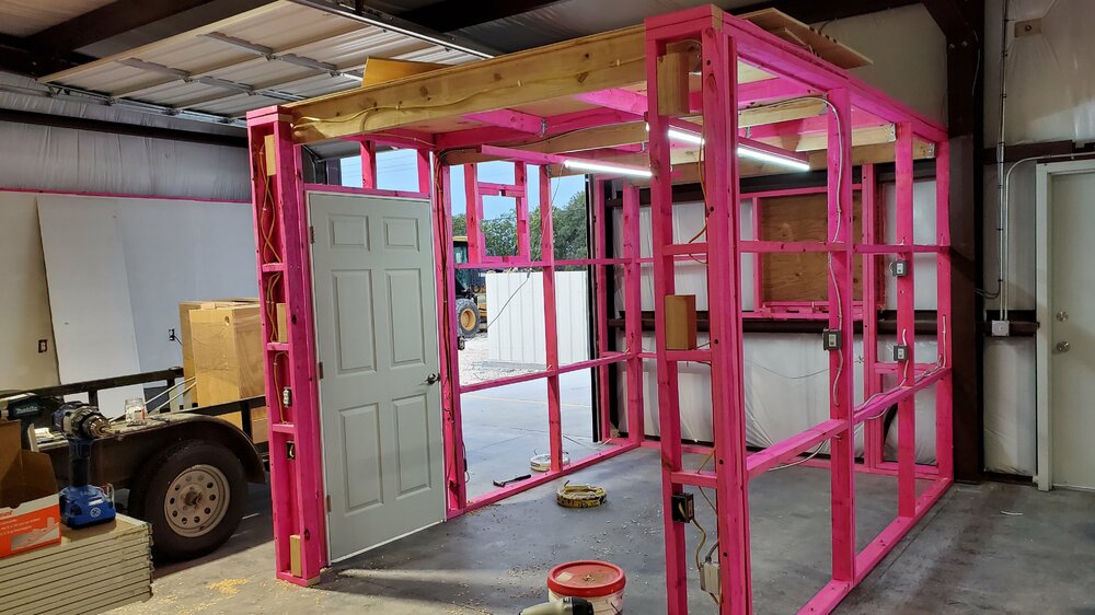

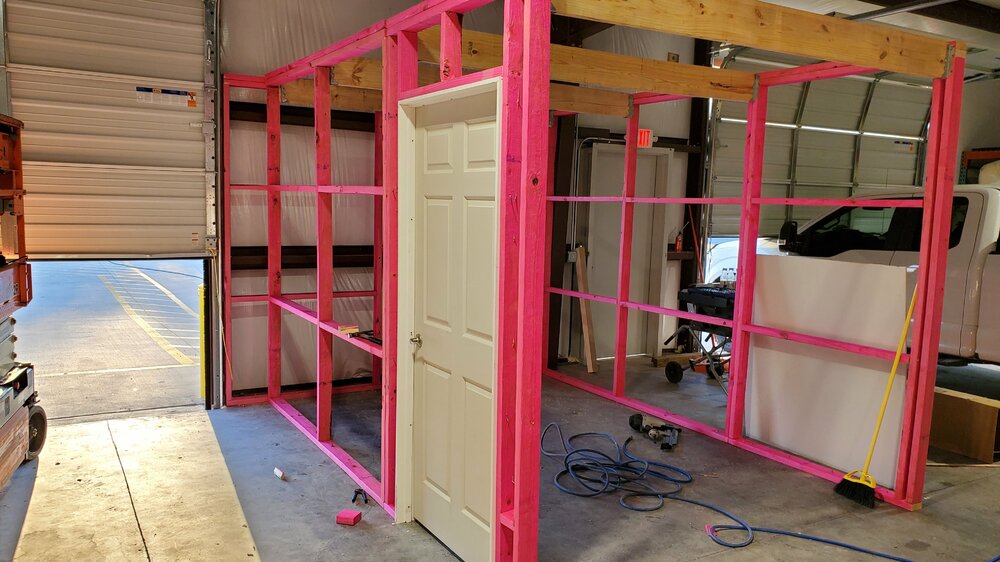

Got the last power run pulled to the laser room along wit the 2 data lines:

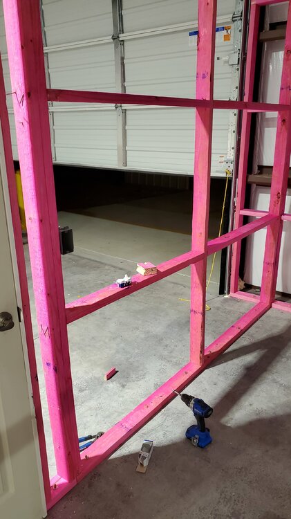

Got the framing more or less up for the "gate" style big door:

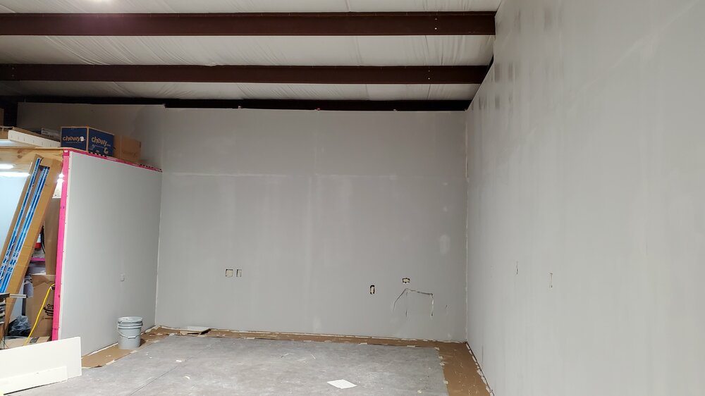

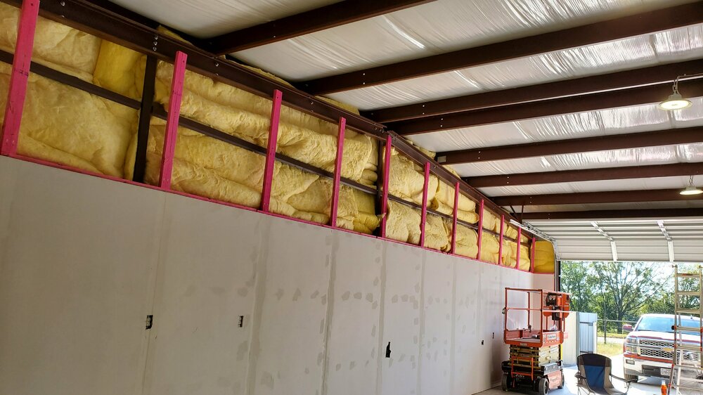

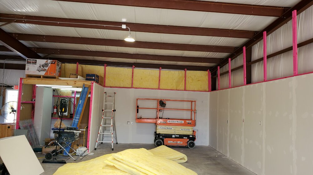

I managed to get the insulation in on the west wall of the laser room before he arrived:

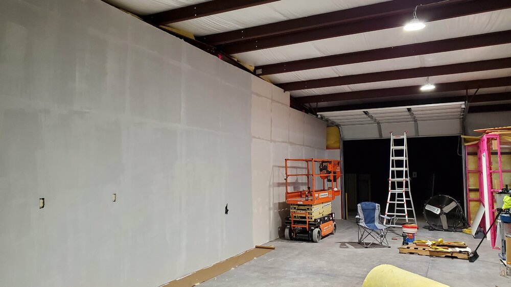

Got studs run up the east and west walls, insulation pulled, drywall up/taped/bedded and partially painted:
We'll see where the walls need a little more TLC in the morning.  Here's a short recap video:

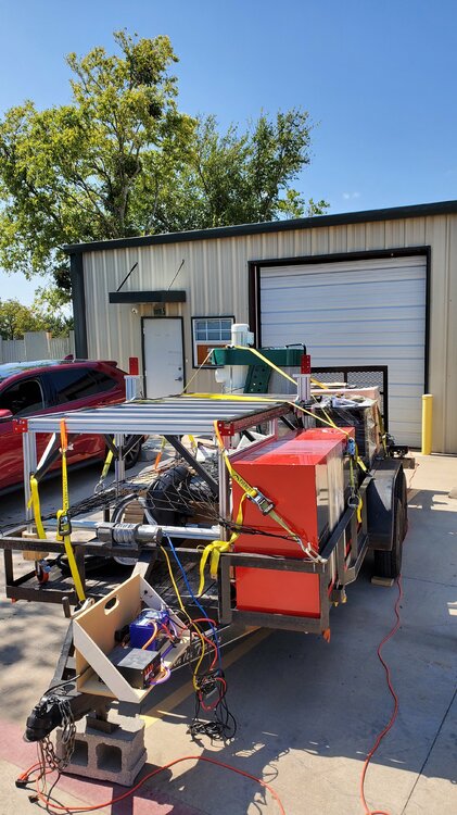

Got going this morning and my little helper (his name is Barf Garbage) loaded up and was ready to get to work:

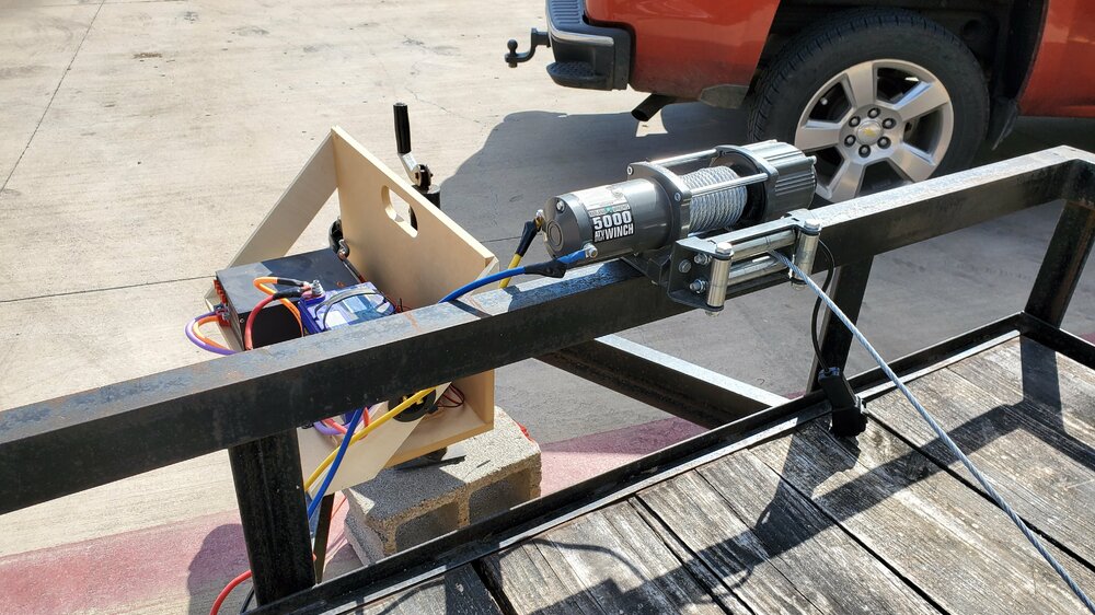

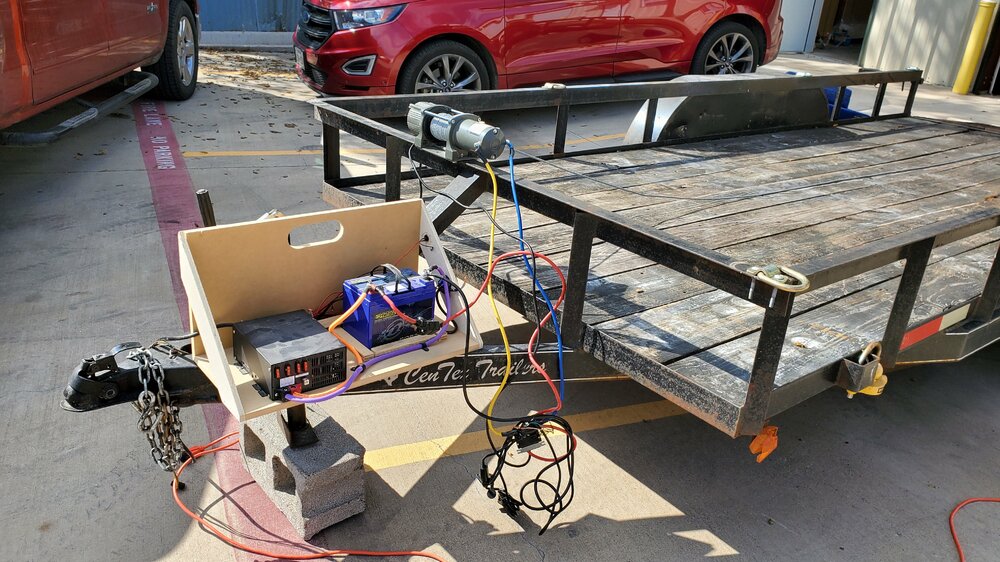

Here is the small winch we used to hoist things on wheels up onto the trailer, I powered it with my old bench supply.  It's a 100A RV charger/supply with an old SoundQuest AGM:
The winch bolts onto the front of the trailer with a pair of 1/2" bolts:

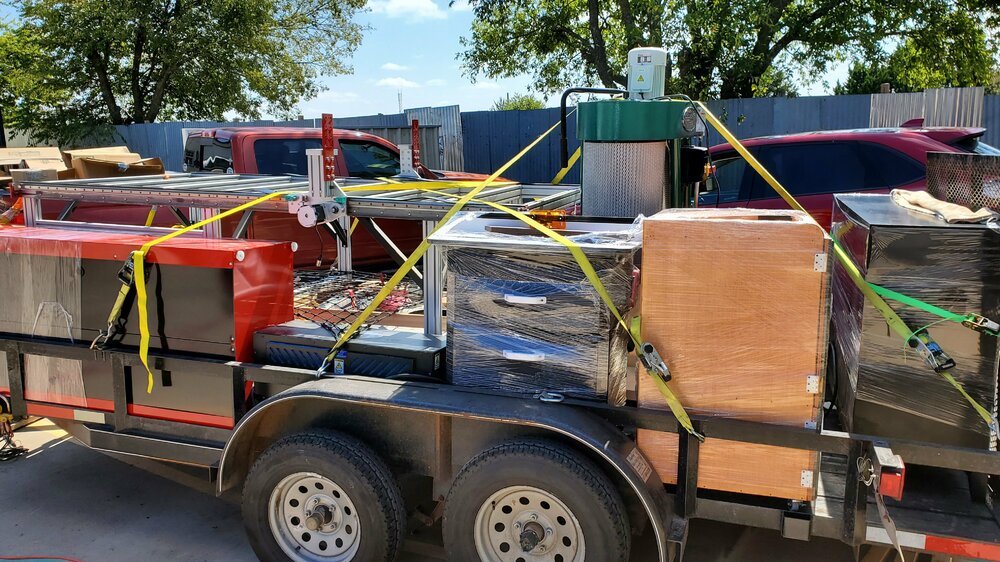

Here's the 1st trailer load:
And the 2nd load:
I didn't get a shot of the 3rd or 4th loads as there was a thunderstorm rolling in and we were hooking and booking.  The 3rd load was the assembly table, the big CNC gantry and some cabinets and other stuff.  We managed to get that run unloaded as the first rain drops were beginning to fall.  The final load was the pack station and some odds and ends.  It all got thoroughly rained on, so hopefully nothing was ruined.

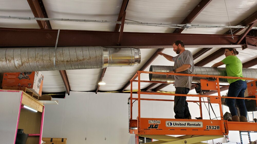

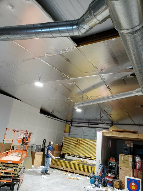

Good news!  The A/C is in and is a HUGE quality of life improvement in the shop:

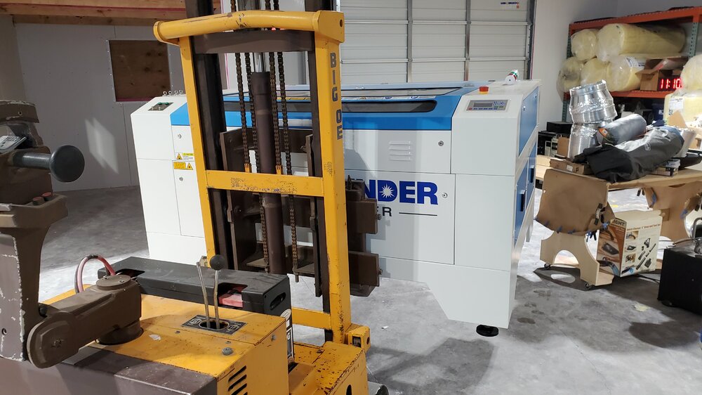

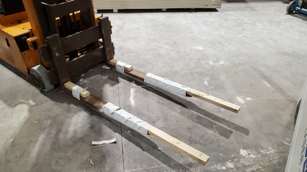

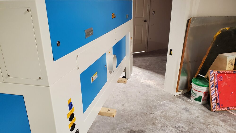

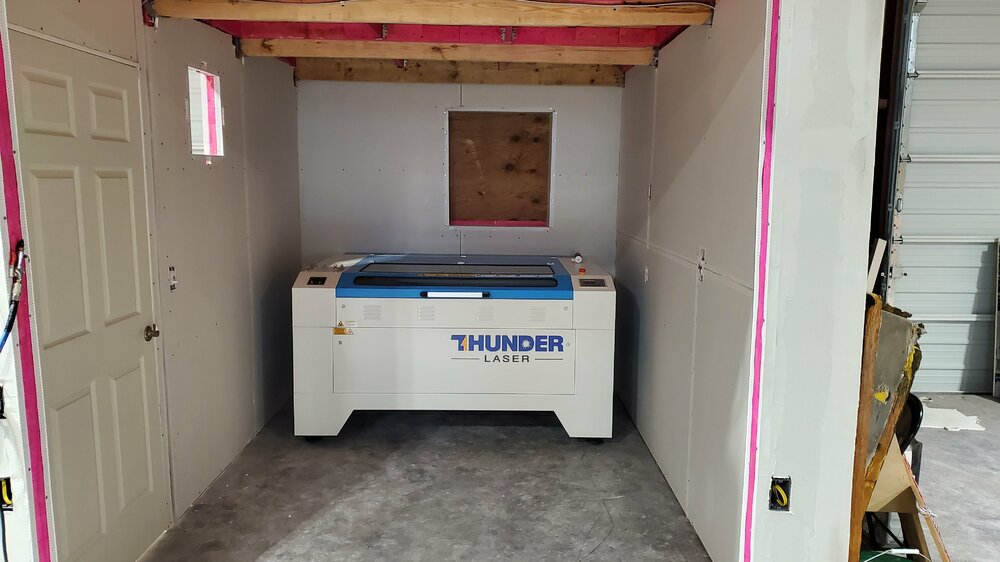

I was able to get the laser room up except for the gate-wall that will close it off from the shop (same story as the collector room) and pulled the laser of it's shipping pallet.  It certainly wasn't my best idea, but it was around hour 19-20 in the shop last Saturday and I was more trying to get something done than thinking clearly LoL
Forks on Crushi weren't long enough, so I used Gorilla tape to add some 2x3 runners (2x4s would have probably been better - or longer forks):
That was after getting the laser on the floor.  When I heard this start to happen I got to moving with a purpose:
Here are some shots of the laser up in the air:
All's well that end's well, I got it down without critical 2x3 failure and rolled it into the laser room:
I then proceeded to fill the rest of the room up with as much stuff off the main shop floor as I could to make room to work the scissor lift.
Here you can see some of the crap in the laser room as well as the mad board we are installing on the ceiling.

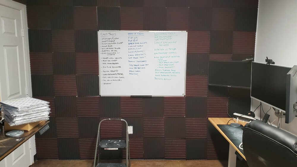

I finally have reliable (not particularly fast - but reliable) internet at the shop, so I've been able to go up there to work my Day Job and do little odds and ends work during normal working hours and then hammer out the bigger tasks after 5PM.  I started sticking sound dampening foam tiles to the walls of the office today.  They suck, they were cheap and it shows.  I'm trying to use 3M adhesive squares to stick them to the wall and they keep falling off.  I'm going to have to use some spray contact cement and permanently glue them to the walls...
I had them all lined up when they first went on, but they have fallen off so many times they've ended up crooked as my patience to align them sticking them back up faded throughout the day.
