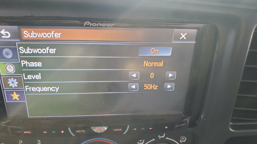

vtxcalibur Posted September 13, 2021 Author Report Posted September 13, 2021 That's where the speaker sits inside the box right? Here's a pic of my stereo settings I was speaking of

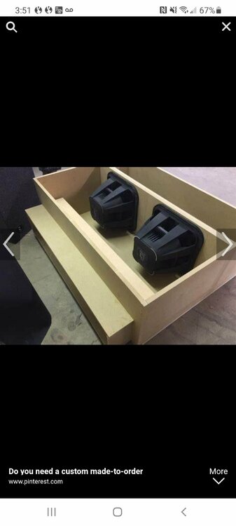

Dafaseles Posted September 13, 2021 Report Posted September 13, 2021 Ok, so keep the subwoofer on if you have your RCA cables going from your subwoofer output jack behind the head unit to your subwoofer amp (which in assuming is how you have it). Phase, just keep at normal. You could try putting it at 180°, but that's just for sound quality issues. You could try it and see if you like the sound better or not, but normal is.... well.... normal. Level is your bass boost. Keep that at 0. No need to use it. It only will end up sending a distorted or clipped signal to your amplifier. Frequency is, if you where to use your "level" (bass boost), that is the frequency that would be boosted. A 4th order bandpass is an enclosure where one side of the subwoofer (back or front) is in a sealed enclosure, and the other side is in a ported enclosure. Basically getting the best of both worlds in a sense. Here's a pictureyou can see, the cone of the subwoofers are firing into a sealed side, and the motor is firing toward a vented side. This type of enclosure would make it so you didn't have to try and fandangle your port in crappy spot, probably sacrificing output, sound quality, and subwoofer efficiency. 2011 Chevy Silverado under construction My build log here. Check it out!
