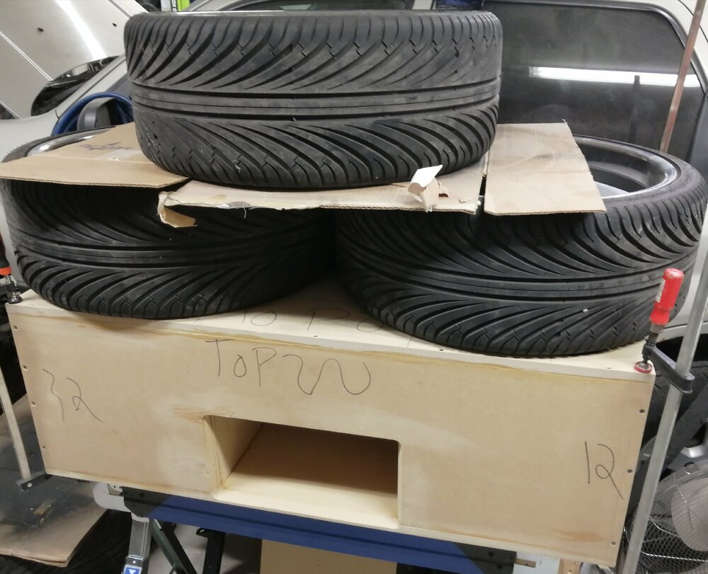

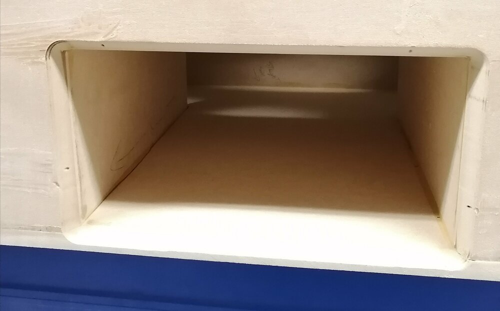

When you run out of clamps. And port 45'd. Trying to cheat a lil on length. Tuning will be 35/35.5. Rounded inside lip and put the 45 on outside . With no flair/round tuning is IMG_20211126_143001.thumb.jpg.1c5b30a19bb7fb517fbdbb5110cf2f6d.jpgIMG_20211126_142845.thumb.jpg.7aec51f3c7cd62643b3c019cafb2eea1.jpg36.
Like the home made clamps u got there

Remember it's not dumb if it works! Looking good

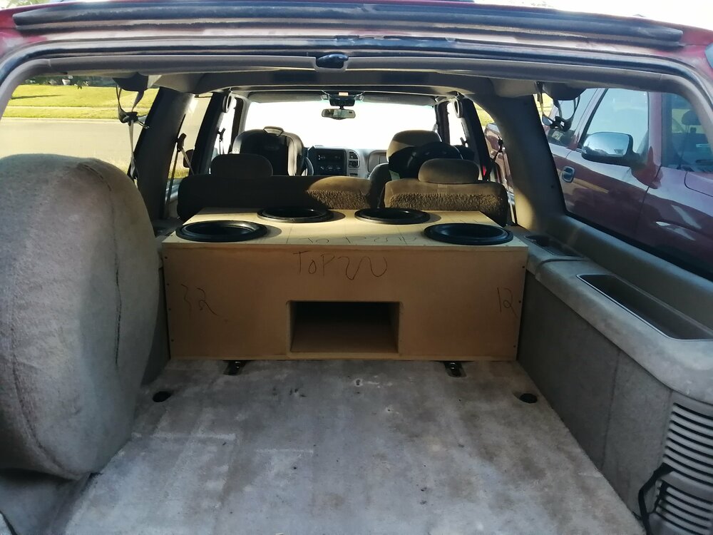

That was a heavy bitch. Box looks small in there.
You could have fit 6 more on there easy! Looks good though! And still have room for groceries
