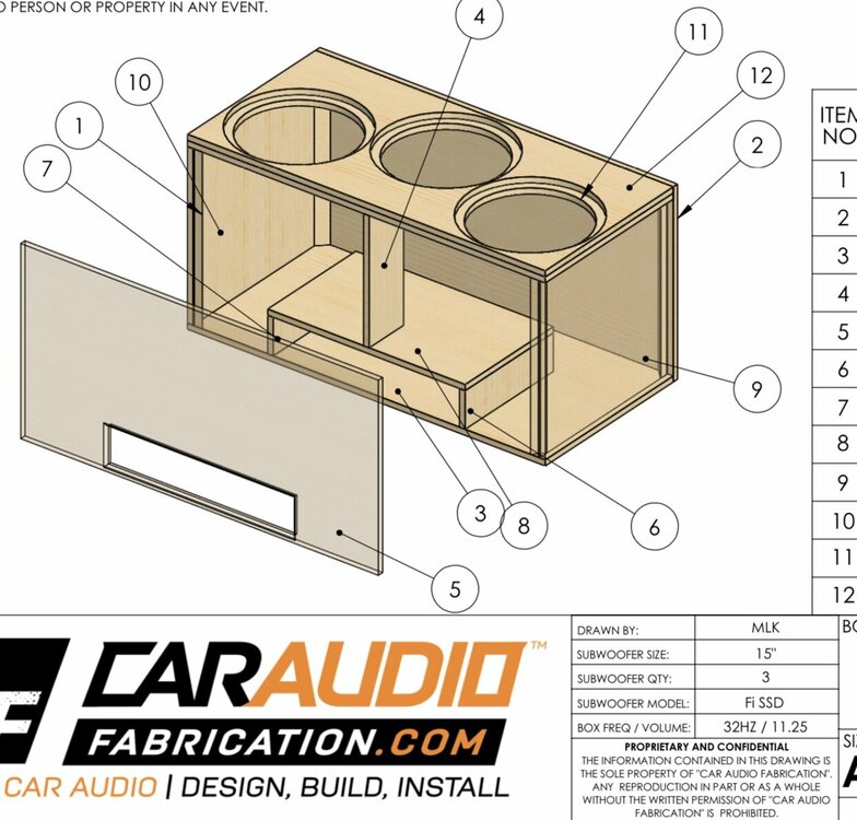

I have tried and tried multiple enclosures and 2/3 15s I never can quite seem to get past 147db on a musical build.  Just built a new enclosure for 3 Fi ssds at 11.25 cubic feet and still can hit much past 145 on music.  Running a crescendo bc6k on 3 Fi ssds.  Here is a clip on YouTube
I have a bunch of questions:
Is the 11.25 cubic ft Net or Gross?
What's your port area?
What frequency did you get your 147?
What do you have the enclosure tuned to?
Most people chasing numbers are tuned higher I've heard but I don't chase numbers I chase not being able to breathe

11.25 with out displacement could become 7 with port, bracing, and subs accounted for.  My box is a hair under 10 before and 7.5 after tuned to 36. The lower the hrz the longer the port, and the more space gets eaten.
