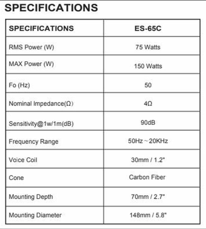

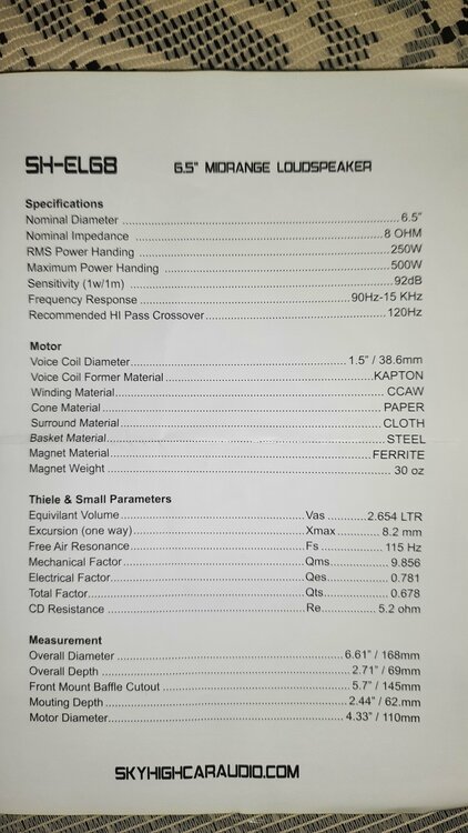

Whats being used...rockford fosgate prime r2 500.4. 75x 4 @4ohm 150x 2 bridged (set for no clip)
Pair of Resilient sounds ec65c rated 75rms 4ohm
Pair of Sky high el68 rated 250rms 8ohm. So i've been using these mids separately (specs attached) with the es65c wired an stereo and giving rated 75rms and sometimes the el68 bridged giving 150rms each on the rockford.
What i've noticed is the es65c (midbass/midrange cut at 100hz 24db slope) has a very flat response and sounds pleasing to the ear but lacks that loudness and subwoofer bass easily covers them, whereas the el68(mid range, cut at 160hz 24db slope) loudness increase only a little given double power, but sound quality dropped alot because of bridging, some tones hurt your ear but it lacks midbass. I tried eqing these an there so hard to tame but they are crisp and sometimes clean.
Your thoughts? Which will you choose? Tips to get loud,clean tonal sound from either or. The goal is a daily system, clean yet impressive for a small amount. Am planning to sell the pair that i will not use.
Thanks

Just comparing the 2 on paper, the ES-65C seems like more of an SQ type driven driver. The Fs is 50 meaning you can cross them over a lot lower even from what you are (even though there really is no need since you have a subwoofer). At least I think that means the resonate frequency (it says Fo?). The sensitivity is 2 db lower as well. Meaning at 1 watt, with the microphone 1 meter away from the driver, using whatever tone or noise they use, it got up to 90 db.
That all being said, those sky high drivers obviously can handle a lot more power than you're giving them. But that doesn't necessarily mean they will sound better.
On my journey to decide which drivers I was going to use for my truck, basically the driving consensus was that what effects how the speaker plays, and how actually reproduces sound the most was the materials that where used to make it. What metal they used for the voice coil. What material they used for the cone. Former material. What size gap was used. Things of that nature.
All in all, unfortunately, if you're looking for sound quality while getting loud, you're going to have a tough time with either, for different reasons with each. One thing that really helps, that is actually pretty hard to find on some drivers, is a frequency chart that is zoomed in so you can pick apart the different frequencies and see how the driver reacts. A lot of the time unfortunately, they post these graphs, but zoom out so far that the graph looks flat, when in fact it's peaky as all hell in real life.
You're going through now, what I went through, and I don't envy you at all! I literally lost sleep over my decision on which drivers to use. I still worry I'm not going to like them. But, those are the breaks. You won't know until you try them, or hear them in someone else's ride.
You can also run them through a DSP and EQ the hell out of them until you get the sound you're after. That's always an option.
