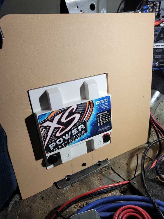

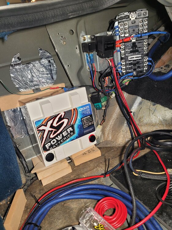

I have only run 1 battery forever.  Upgrading the charging system. Mechman 370A alt.  XS power 3400 and an XS power 925 here in the truck.

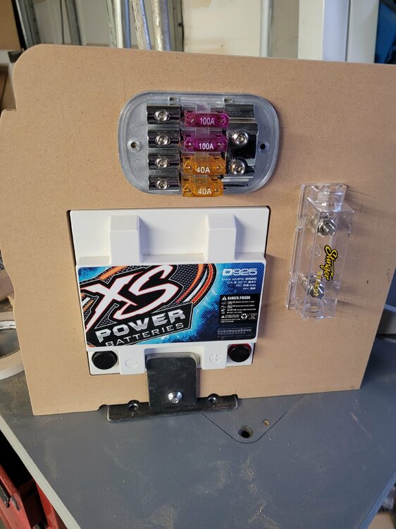

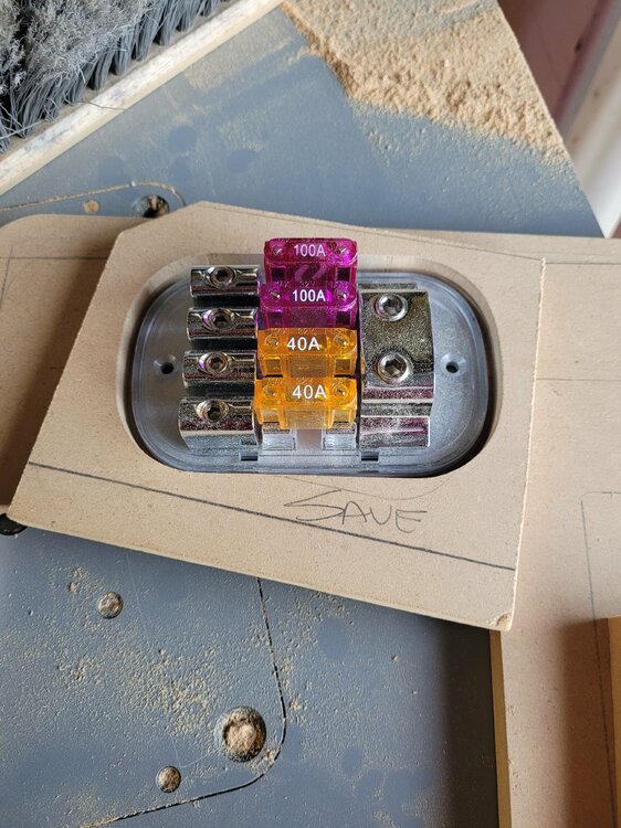

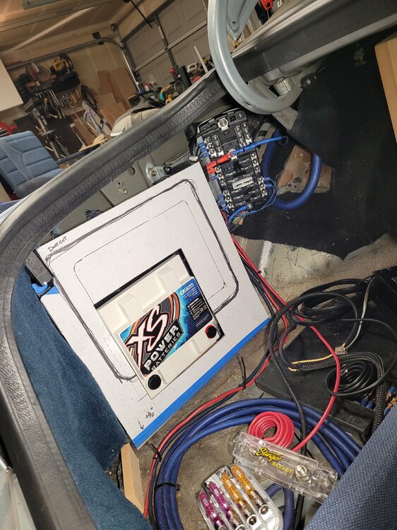

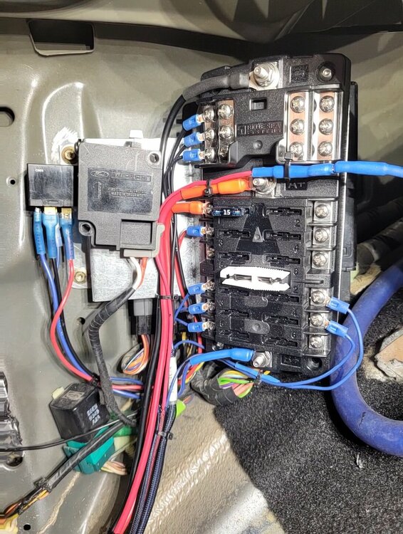

Mocking up for fit amd a added a fuse panel to power and spit up all the wiring

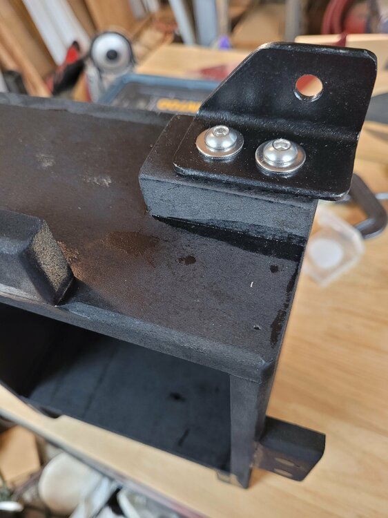

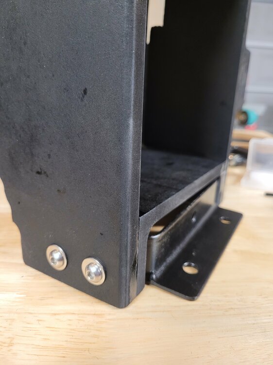

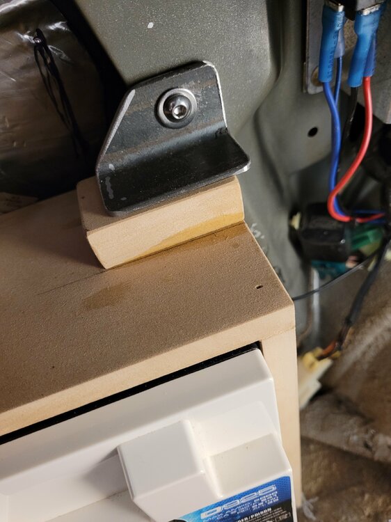

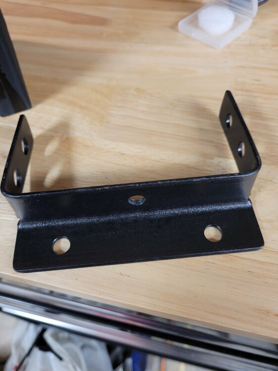

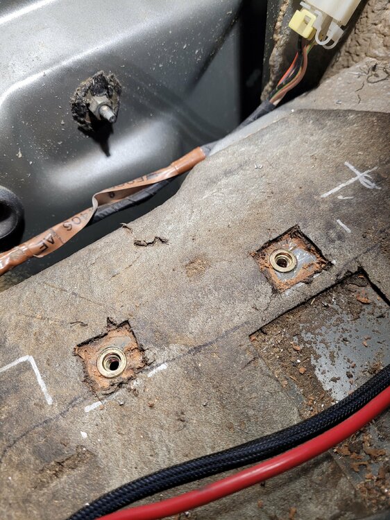

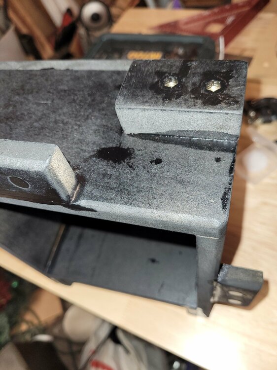

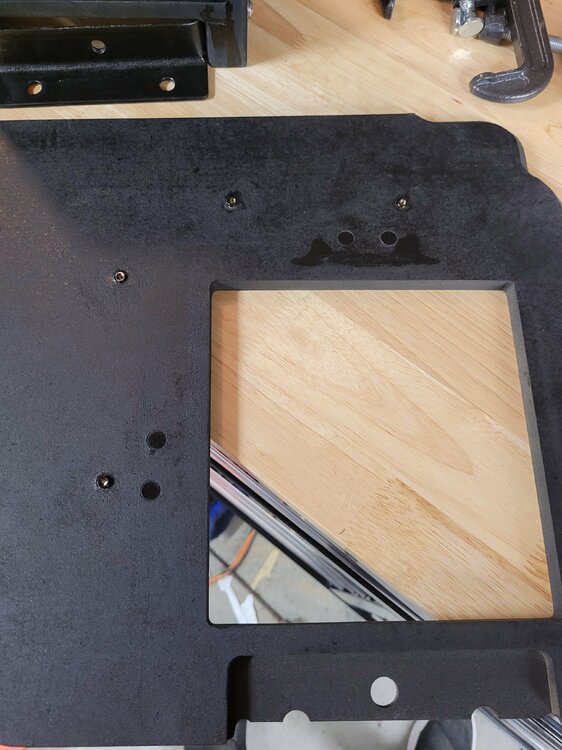

The fuse panel is on a bent up bracket over some other stock stuff mounted to factory screws.  I used threaded insert as much as I can becuase I am always changing stuff.

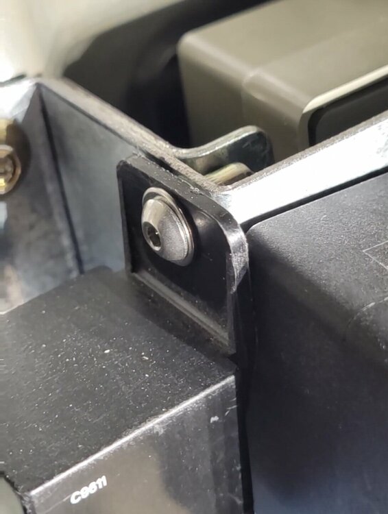

turn on relay mount

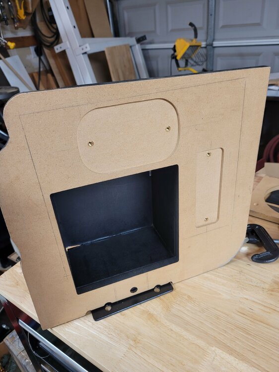

You cannot see the stock bracket in the back and the new one on top of it

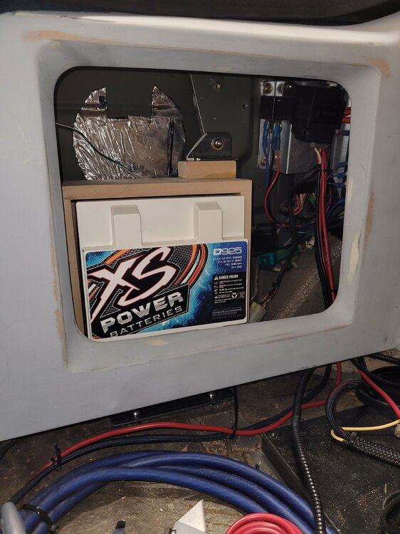

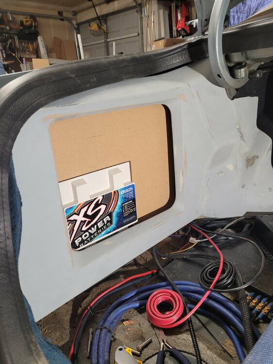

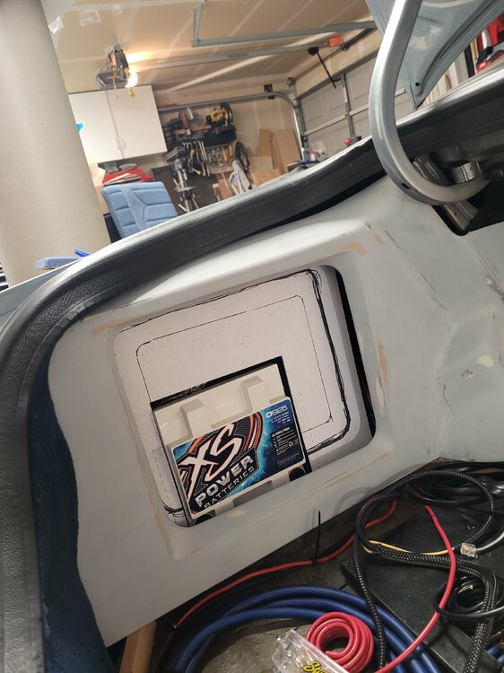

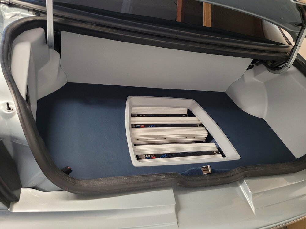

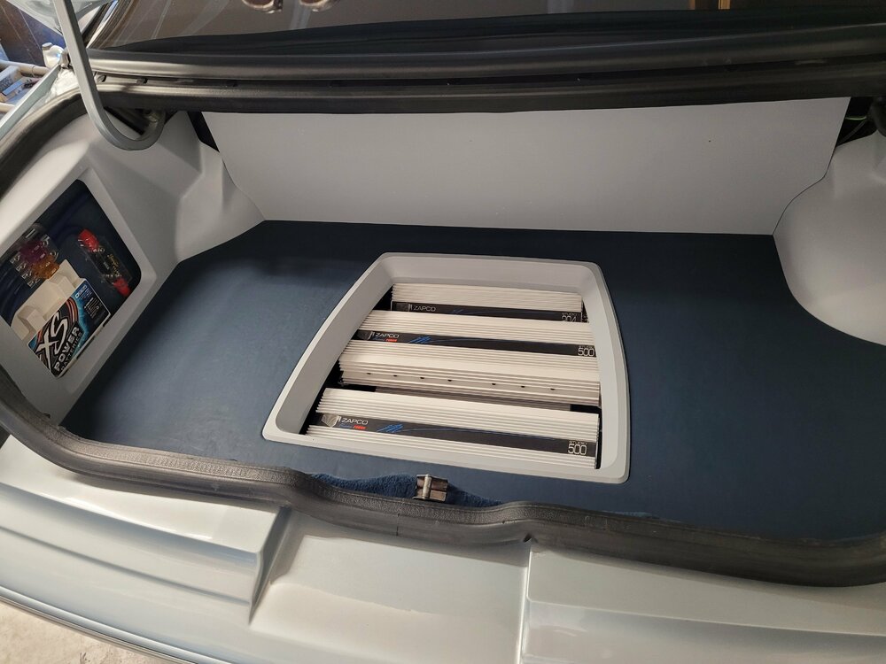

Fitting trim panel and the trunk panel, still in primer

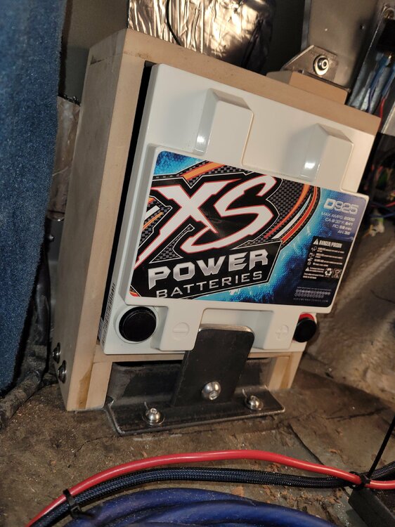

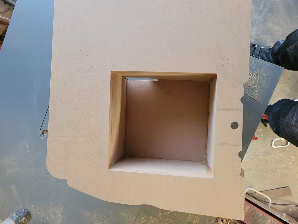

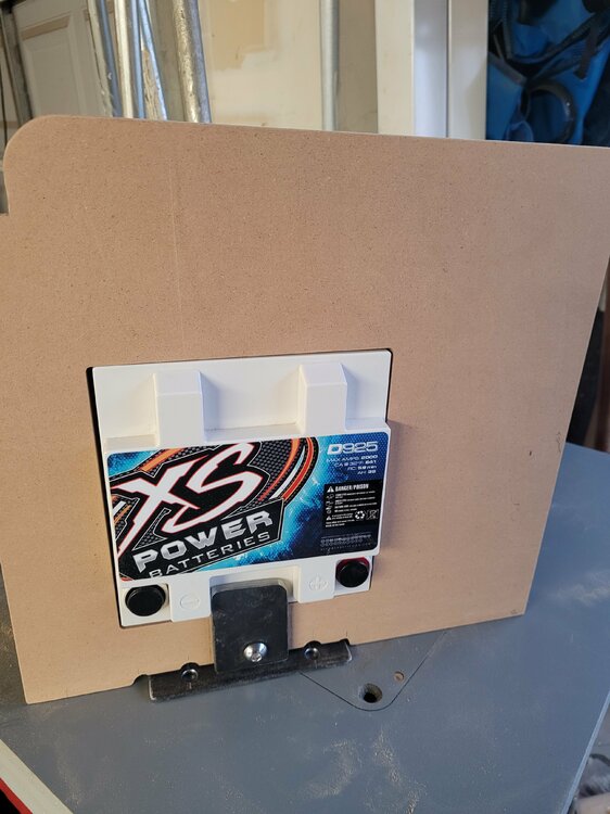

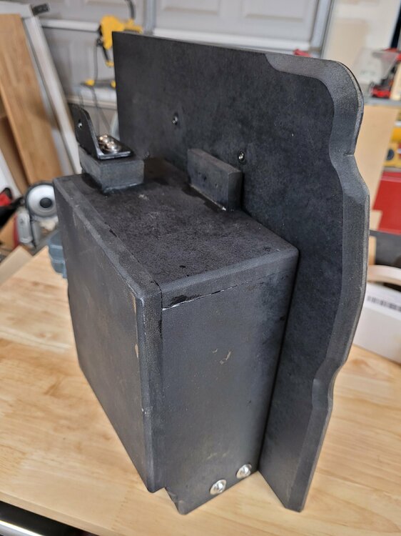

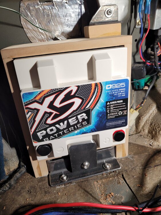

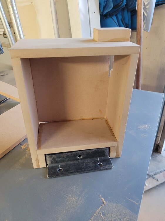

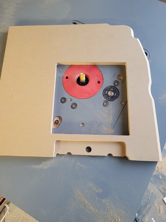

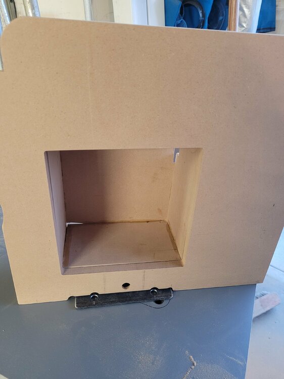

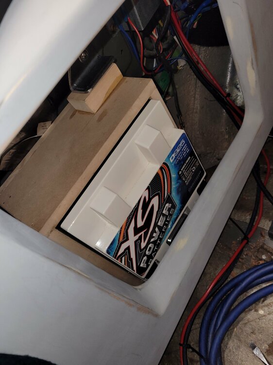

building the box for the battery.  Its mounted with threaded inserts to the car.

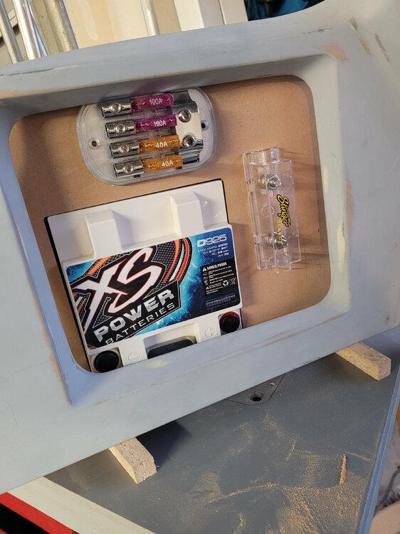

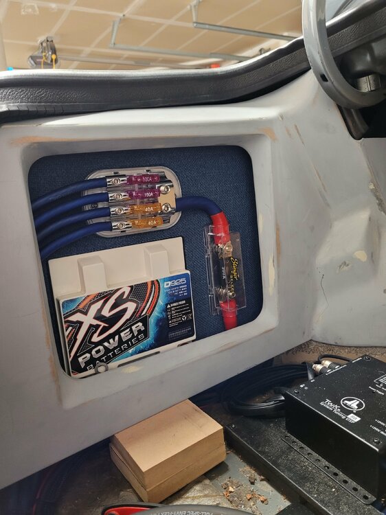

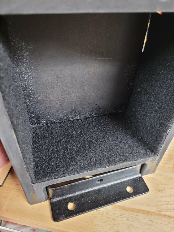

Starting cover which will trim out the battery and hold the battery fuse and distribution
20211219_164449.jpg20211219_164456.jpg20211219_164525.jpg20211219_164809.jpg20211219_164943.jpg20211219_165829.jpg20211219_165926.jpg
20211231_200541.jpg20211231_200928.jpg20211231_201007.jpg20211231_201037.jpg20211231_204301.jpg

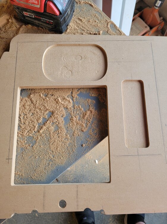

Cover is held with magnets

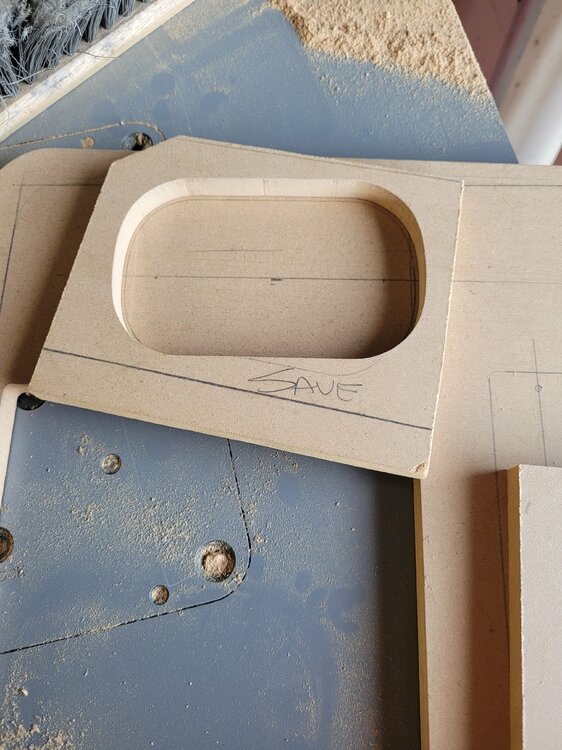

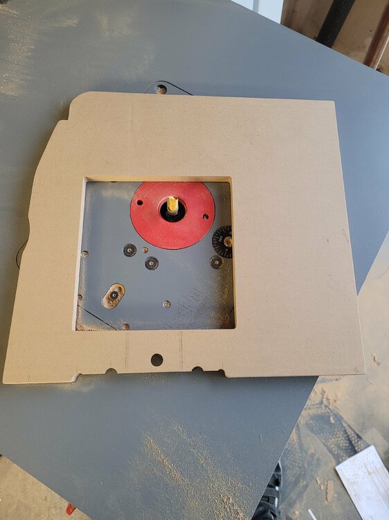

Template to make a recess
20211226_154129.jpg20211226_154135.jpg20211226_155737.jpg20211231_201020.jpg20220108_210130.jpg

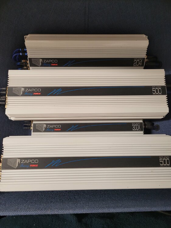

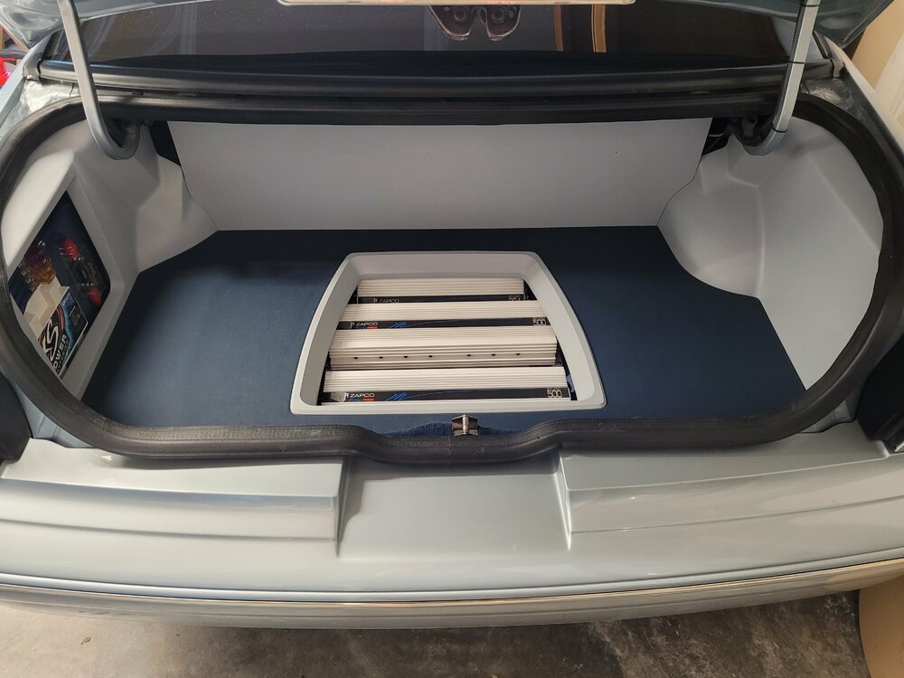

Since it's been so long.  This is what it powers

Panels are primered now.  Primered will be painted body color

That is one clean ass trunk!
