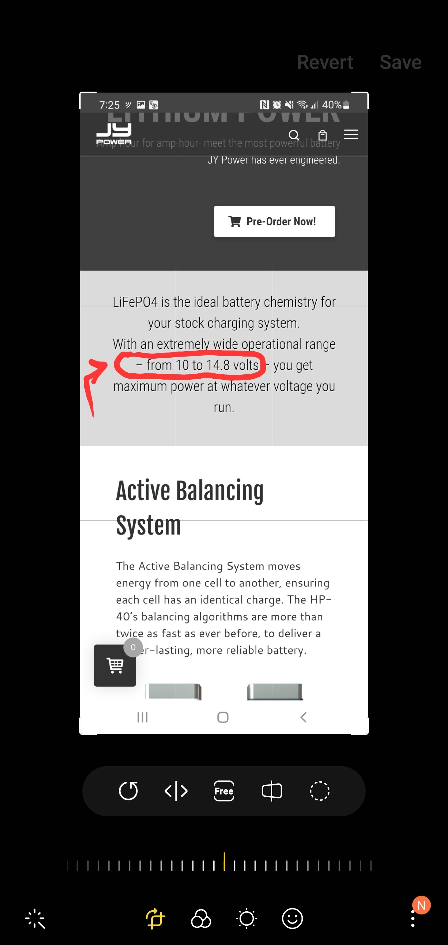

Guys I think I’m gonna go with the jy power hp40 lithium battery. With my new alternator that will give me way more than enough power
If you're going to use that voltage booster, you should re-read the first paragraph on the web page for JY1982216023_Screenshot_20220208-192635_PhotoEditor.thumb.jpg.bcc917936f2fe4cc872423ae7d109b7e.jpg

Yeah I understand it would fluctuate but I’ve seen guys on YouTube have their voltage only drop like 2/10 of a volt going full tilt on idle. I wanted something like that and yes I did see the optimal charging voltage for the jy battery. I saw that it said don’t go over 15.5 on charging voltage and this booster I want can do 14.5-14.6 on boost and 15 on super boost mode. Just wanted to get the most power I can so that 5k can make rated power at 14.4

the  JY power battery is lifepo4 , max charging is 14.6 , LTO battery chemistry is the one that needs higher charging in the 15 volt range . my suggestion is to run the 270 amp alternator with factory charging voltage  and then run the jy power battery , that's if you don't want to build your own bank (battery) , you could if you choose to build a Headway 38120hp bank of 64ah that will easily run your 5k plus your whole vehicle (do a front battery delete) .
