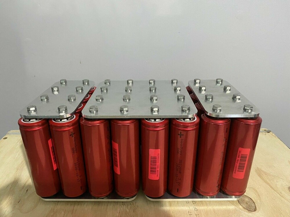

After further review I’m definitely gonna go with the 64ah of headway cells!! I’m gonna get 16 cells and it will save me a ton of money. My only concern is just making sure I get that 14.4v volts so I can make rated power with the Taramps smart bass 5 (rated 5000w at 0.5-2ohms at 14.4v). In the future once I decided to upgrade (have 2 15s now but will probably go 2 more 15s and tuned lower) it’ll be real easy to just add cells
for a 64ah Headway bank you need 32 cells, you'll be fine with your stock charging voltage , don't be concerned with tenths of a volt (14.4) if you charge at 13.6-14.6 you'll be fine . to build your own Headway bank you'll be around $600.00 , people will tell you cheaper but factoring all the stuff you need , 600 will be about there .

you don't need to charge each cell individually , you line all cells up connecting all the positive together and then connect all negative together( NOT connecting the positive to negative !!) and let them sit to balance out (usually a day or two ) once you get them balanced , connect them in your pack(bussbars ,etc.)  put an active 5amp balancer (NOT a BMS)wired correctly to the bank , charge with a lifepo4 charger to 14.4 , then connect to your vehicle . best way is to delete front battery and run everything off the Headway bank...

by the way , DO NOT USE THIN BUSBAR PLATES like Parker on youtube , get some Coventry or Project DB bars , i got some off Ebay that are 4mm thick ( the plates in the picture i posted) the ones on Parkers you tube video are 1.143 mm thick , yeah not enough pulling 400-600 amp through it ! i'll be pulling about 450 max amps (Deaf Bonce AAK4000 & D'amore 400.4 ) using the plates(busbar) i got allows me to mount in a group 31 battery box
