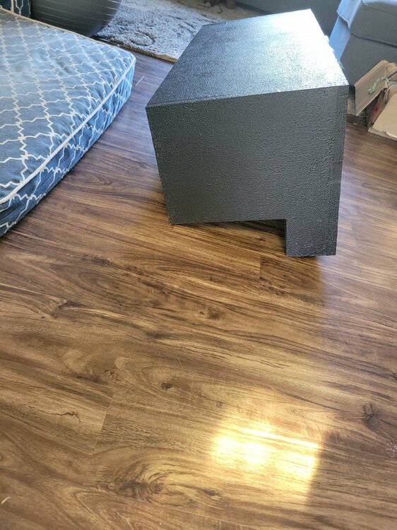

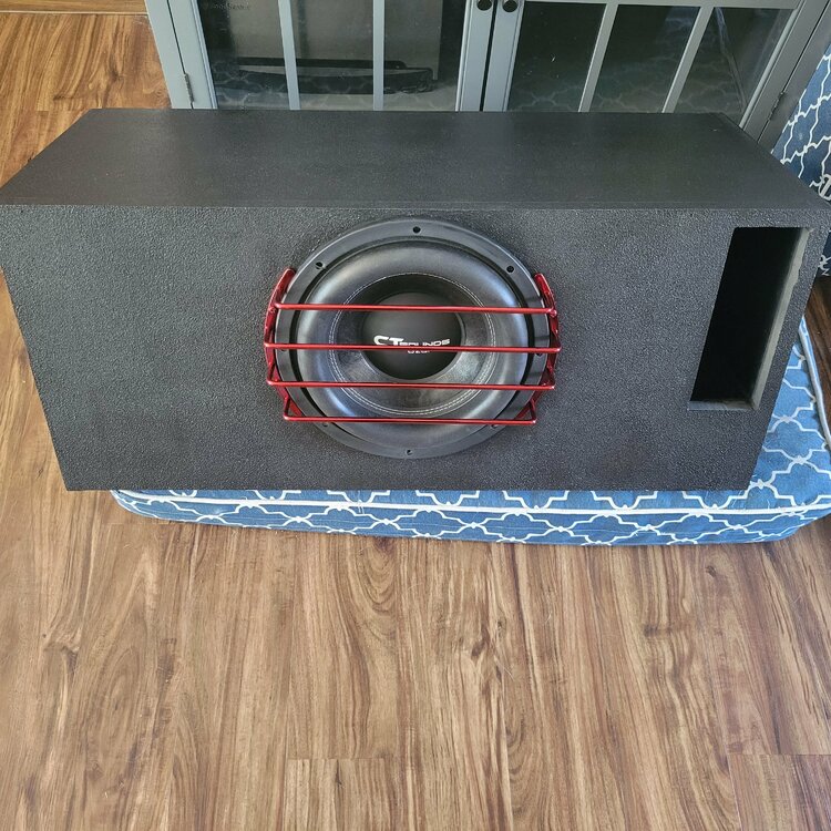

I'm seeing 15.5" height back there, then a 7.5" transition, is that correct? Here's a pic of one I designed & built a few weeks ago for a single 12, we can do something similar.
Whatever I design, you'll have to tape some cardboard or something together with the dimensions and make sure it fits in there before you actually build it, that's important as I'm sure you know.
Looking, there may not be much depth available. If there's not, there's probably no reason to include it since you'd lose potential width. If we do just a rectangular box, I can get that done tomorrow since it'll be straightforward.
