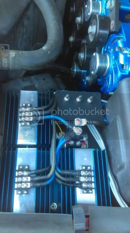

stingray72 Posted April 19, 2022 Report Posted April 19, 2022 https://www.motorcityreman.com/14voadvore.html?cmp=googleproducts&kw=14voadvore&gclid=Cj0KCQjw0umSBhDrARIsAH7FCofv7dA-3j4ERXdIuPuYpJrZYEW0WIcmCehaDlIujFzTHR5zx58WUBsaAn7lEALw_wcB I want to use this to raise my voltage to where my lithium battery will be happy.
Kyblack76 Posted April 20, 2022 Report Posted April 20, 2022 Gives me nightmares LOL SMD SUPER SELLER The Burban Build Blazer Build sold Acura trunk build sold
audiofanaticz Posted April 20, 2022 Report Posted April 20, 2022 Yes, they are made to adjust voltage to desired voltage. However you need to take apart your alternator and remove the internal voltage regulator, so you will need to send your alternator out to whoever built it for you to be able to use one of these. That being said most alternator companies offer the Transpo voltage regulators and you may be able to get them a tad cheaper if you buy it from the company that is doing the work on your alternator.
