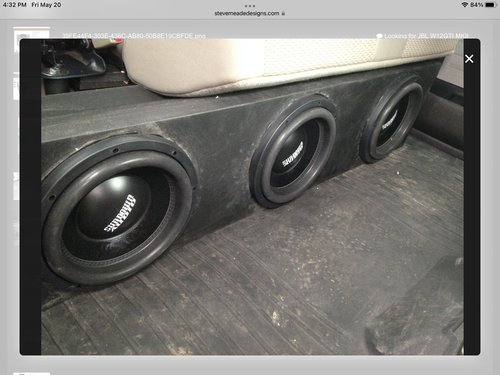

I ran SA 10’s  in a sealed box , 3-10’s 1 box all separate chambers at probably  .65 cubes each before displacement.

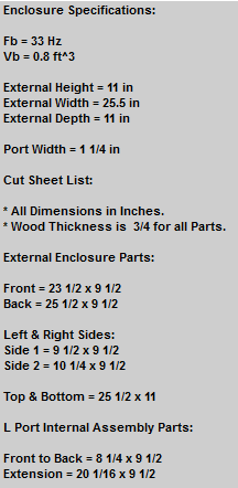

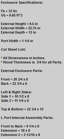

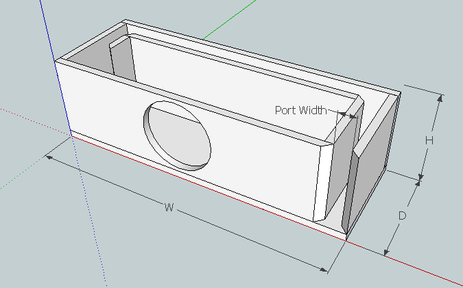

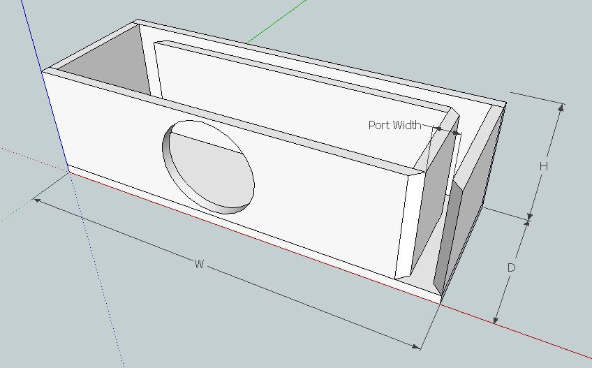

Two 8s have similar cone area as a single 12", not much of a point on owning them unless they are used in an under seat enclosure like you see in ext cabs and such, anyways here are two enclosure, one small and one average sized, the small is kind of choked and difficult to build so I recommend the average sized one, neither can meet 10x20x10 size but close:
Figures are just assembly guides.
Small:
Average sized:
