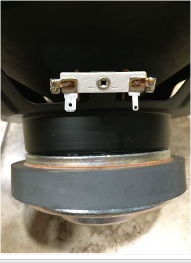

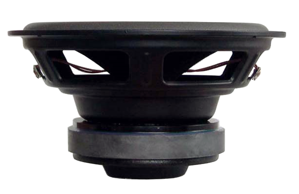

Joe X Posted June 3, 2022 Report Posted June 3, 2022 I checked it and they are not the same part: Logitech 170012-0000: Tang Band WT-644F : So at this point I would recommend to sell the sub since they are selling for a nice price and then get a better sub. If not build a box the same specs of the original one or measure the sub t/s parameters if you think this is worth your time. if you want to make a new box to the spec of the old one post the external dimensions of the box and the wood thickness. the new box can be given better port area and different tuning without changing it's internal volume.
