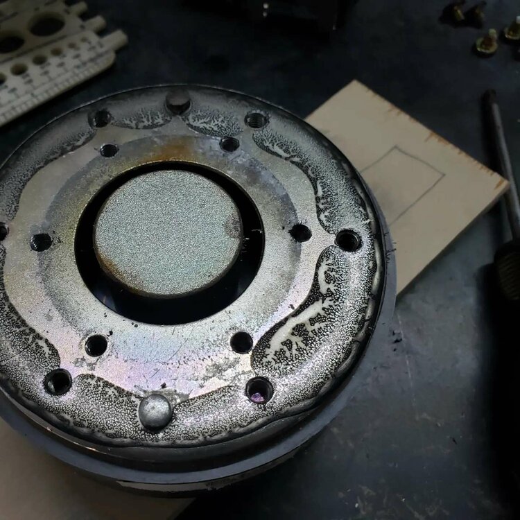

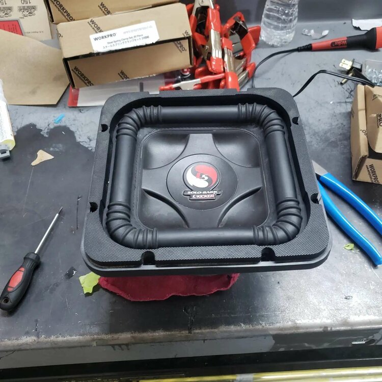

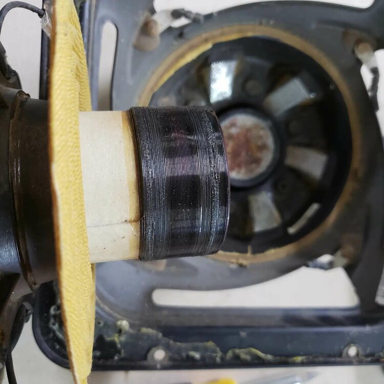

Bought a kicker L5 8 that turned out to be burnt up, So with a spare magnet off an old MTX and time I found some soft parts that fit

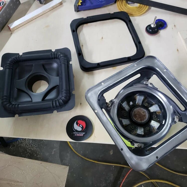

reused the surround+cone, basket and dust cap!

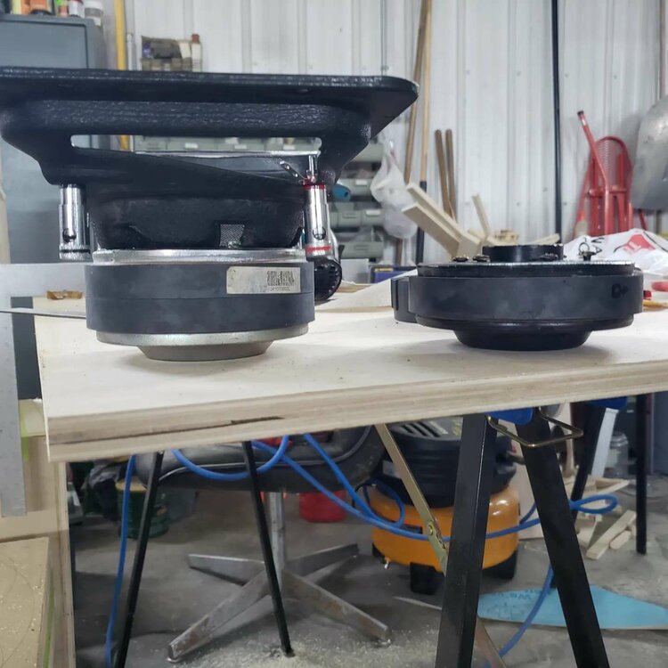

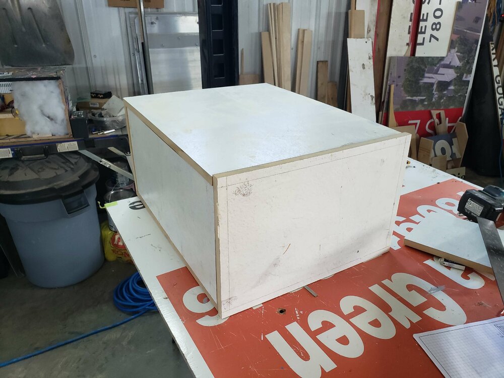

Double stack MTX magnet gives it a little more height

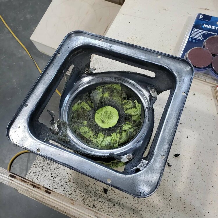

tapped new holes for the basket

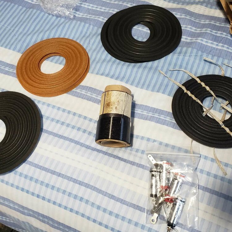

bought a variety of spiders so I can feel which ones I like best before I glue them in, Everything here is from Lord Of Bass, Including the 4 gauge spring terminals. Coil is rated for 1500+ watts!

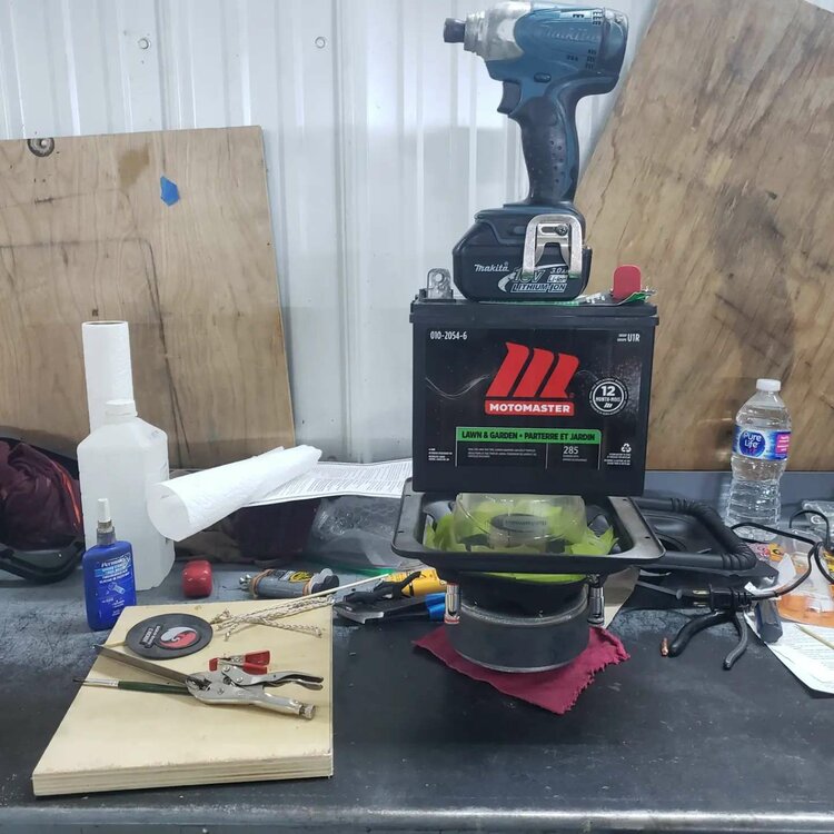

turns out a ziplock container was the perfect spider ring to apply pressure while the glue dried. Braided 3 tinsel leads together per coil lead aswell cause why not?

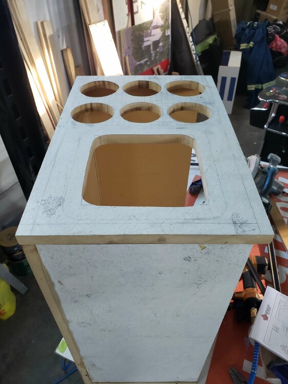

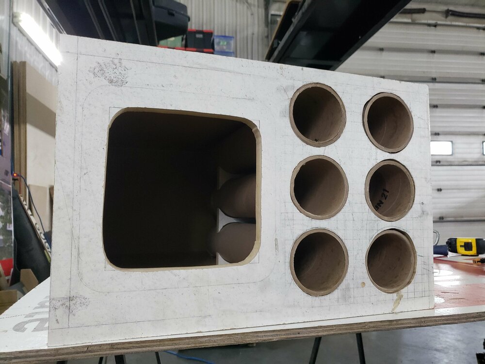

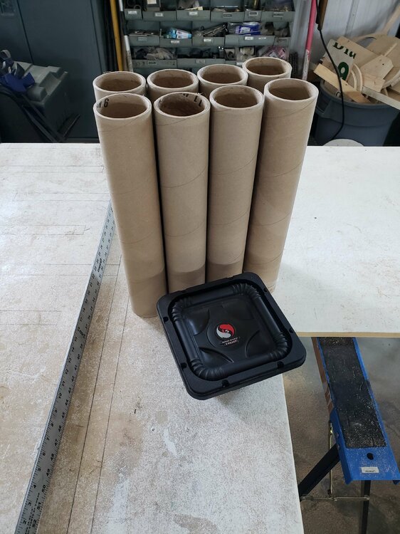

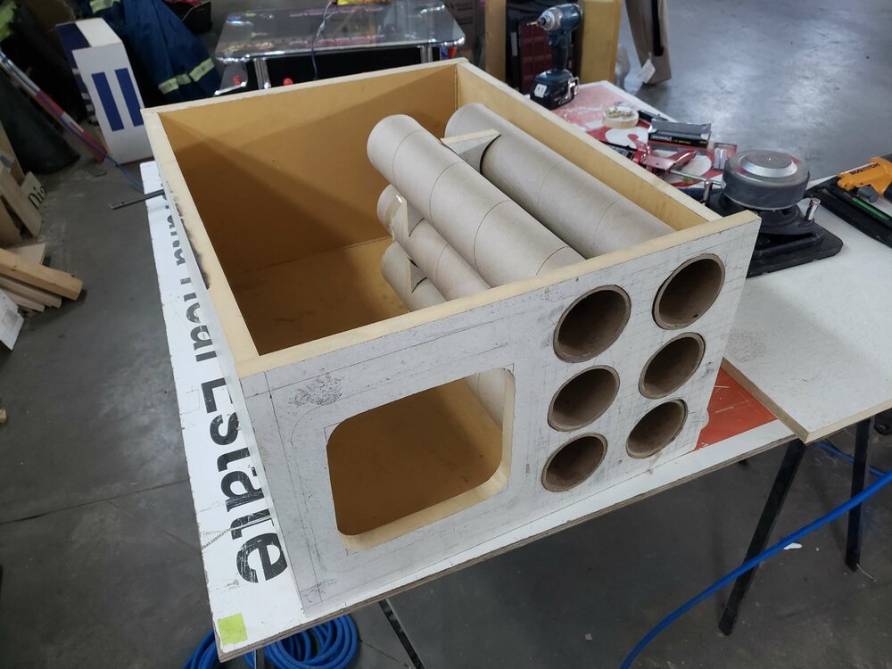

ports on point
just add glue
getting jiggy with the saw
with the help of WinISD, it says with all six ports I'm tuned to 55hz,
5 ports is 50hz
4 ports is 45hz
3 ports is 38hz
2 ports is 32hz
1 port is 22.5hz
