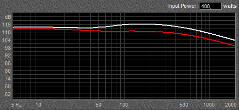

Here is a comparison between one of the best 8" subs for sealed use and the SD-3 10:
White Line: two Image Dynamics IDQ 8 in a 0.7 cubes net box and each sub on 400W RMS.
Red line: a single Sundown SD-3 10 in a 0.7 cubes net box and the sub on 400W RMS.
One can see that the two 8s on 800W can only slightly surpass the single 10" on 400W on frequencies below 50Hz, it is only at much higher frequencies that the power and cone area area advantages shows, same or worse results were obtained with other 8s including the Skar VD-8. which fared worse than the IDQ 8".
Conclusions: from the 8s reviewed all will benefit from ported use to be efficient at lower frequencies, if wanting to stay in that box size and on sealed enclosure type there is little to nothing to be gained when going the two 8s route. As always real world opinions and experiences have their place, so ask around more before deciding what you should do.
