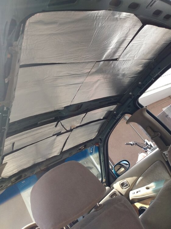

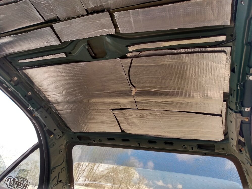

getting some much needed work done 2 layers over most of it of 294 mil stuff and 3 layers in a few spots were i could were it wouldnt interfer with headliner going back in

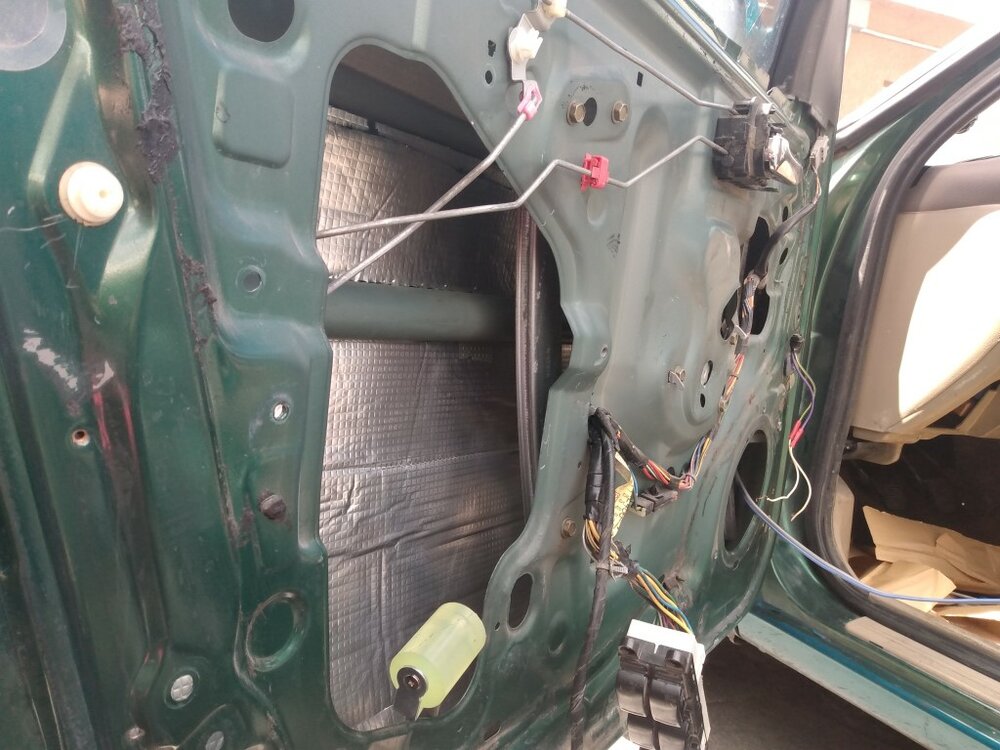

recoil has new amps coming amp ill be getting 3x of the 2500's to replace the 1200's , i also did start to deaden the doors got the driver side door outer skin done today , hoping to get one door done each day , i think im going to get some 150 mil stuff to do the inner panel with instead of using the 394mil stuff on that as well
both front doors done added a 3rd layer to the drivers door and did 3 layers on the passenger door , also got up as high on the firewall as i could without removing the dash and the front seat floor area.now i have bigger windshield issues , it flexed alot before but now its really flexing to the point im afriad im going to break it even at lower volumes and to top it off  im about to dbl my amplifier power . ive got to figure out some thing to help there i really dont wanna put a floor to roof bar in at the top of the windshield but might be my only option
