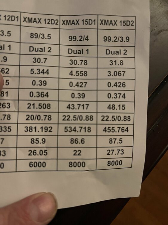

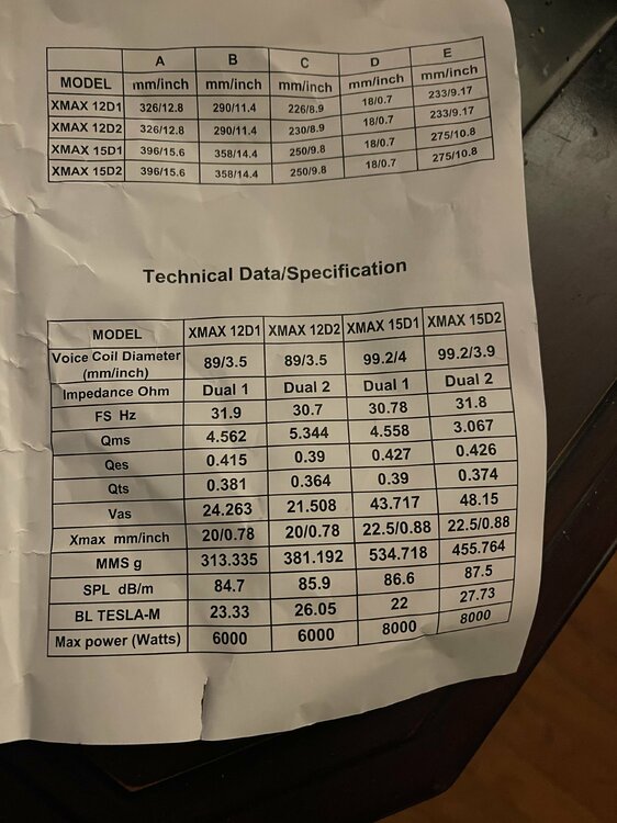

3) Pics of your sub manual showing t/s parameters and manufacturer recommendations as I didn't find anything on their site.
Thanks for the reply JoeX the window line starts at 20 inches the seat is at 19 inches without headrest and 25 with 1DAFDC92-C399-4649-88E9-6683A985E6F4.thumb.jpeg.c9282ed49d3b49e3421f96c8a8c98e6f.jpeg1CA75E89-3F94-433F-82D6-76B4AC6FDAD2.thumb.jpeg.4338d42bfadeaf8426ead996ec46efb0.jpeg
OK so do they list box recommendations for your sub? if so post them. With the parameters above I estimate 3.5 net @32-34Hz 60 square inches of port area for each sub, but I would like to see what they say, the manufacturer can also use auditioning for setting their recommendations so it's always useful information.

They do not list box recommendations anywhere in the manual or even online,
I will be posting a couple of ideas today or tomorrow, the spec (per driver) will be 3.8 cubic feet net with about 60 square inches of port area and a tuning of about 33Hz .
