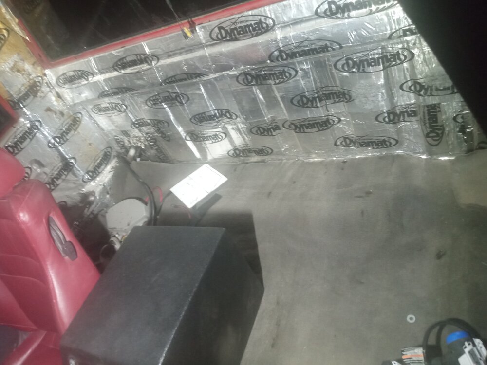

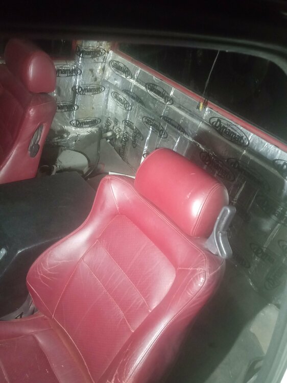

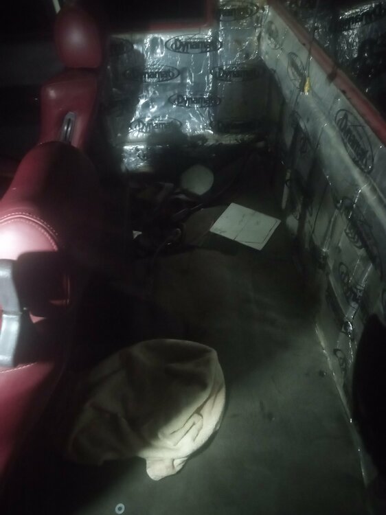

If I need more volume I hoping to go deeper instead of taller I absolutely hate losing visibility and the dimensions I took were with the seats all the way back and somewhat reclined once I put the new frames under them they will be raised a bit with more clearance. I also can do double wall thickness to the outside without going bigger because I did the measurements with all curves in the body in mind leaving extra wiggle room for clearance and for making wooden floor base and side panels. As long as double wall reinforcements will still be effective without going all the way to the top and bottom in certain areas. Like the rear wall of the cab has a big hump at the top, I can run double maybe even triple wall thickness up to that hump for example.
The truck has no interior panels they were all stripped with the previous setup where the truck had a half wall I believe the installer called it.
As far as port displacement I am still hoping to run a big ass  square or rectangle port external.
With all that being said I don't want to be unrealistic if I am just grasping at straws while trying to stuff 10 lbs of crap into a 5lb bag here let me know. If I must wall I will but really don't want to. Already have the subs though can't really back out just because I'm resisting a wall. The show must go on.

As far as the enclosure i wanted the port to fire forward above the center console and the subs firing upwards but inverted.
Now I just don't know what the enclosure is going to looks like probably just basic sealed box.  Until I can figure something else out.

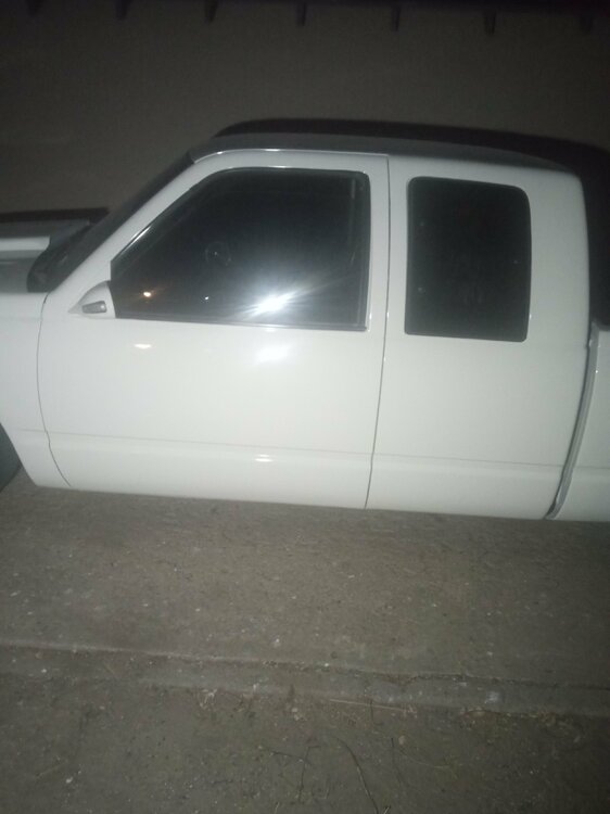

Sure. It's a 1994 Silverado Dually with extended cab. I'll grab pics in the morning since the sun is already down here. Thanks for all the help Joe.
