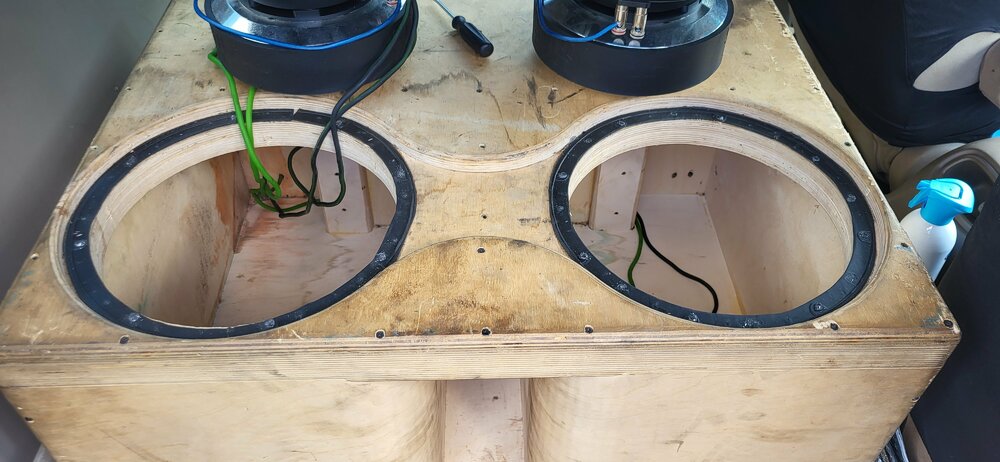

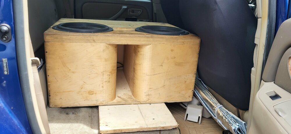

BrandonScott Posted November 25, 2023 Author Report Posted November 25, 2023 Thanks, i was thinking my box was a little big for the sundowns. I know its oversized for the xfl as well. But i usually go about 10-20% larger than recomended by the manufacturer. I find that i can get a little lower that way, but also use less power to do so. But i want to get the most i can out of the sundowns so i think im going to try a new build. Im thinking port in the middle facing front seats, and subs up. Although, subs up tend to make my roof do that crazy metal wobbling sound that i hate. Maybe its time to build a birchwood roof. Lol Anyways, im thinking subs up port center facing forward, 7 cubic ft tuned to 32 hertz. Also i have a nice 8" aero port just sitting around. Could u use that for the 2 sundown 15s? Or would it need a larger aero? It seems like it would be enough. I will include a pic of my sundown U 12s and the box they are in. Im thinking if doing an exact replica of that box but for 15s. The one my 12s are in is 4 cubic ft tuned to 32
Joe X Posted November 25, 2023 Report Posted November 25, 2023 That's an awesome box but for an SUV! If you want to help with the roof flex then subs forward / port sideways. The 8" pipe has an area of about 50 square inches so no good. I would test the Sundowns in that box just to know where you are at against the XFLs and the net volume, if they are overly peaky then smaller box but I am betting you are used to the large boxes sound.
BrandonScott Posted November 27, 2023 Author Report Posted November 27, 2023 Good idea. I havent had a box subs forward port side yet in the trucj. I think that might be ideal. Thats what im going to try. Thanks joe x. I have however had subs forward and port up and that still did roof flex but i had way harder hits to the fromt seats from the subs. It sounded really good. But thats definitely what im going with now. I'll post oics after i complete it so you guys can check it out. And i am going to try them in the xfl box just to get an idea. I think i need to be more around 6.5-7 cubes and around 34 hertz. About 100 inches of port area.
