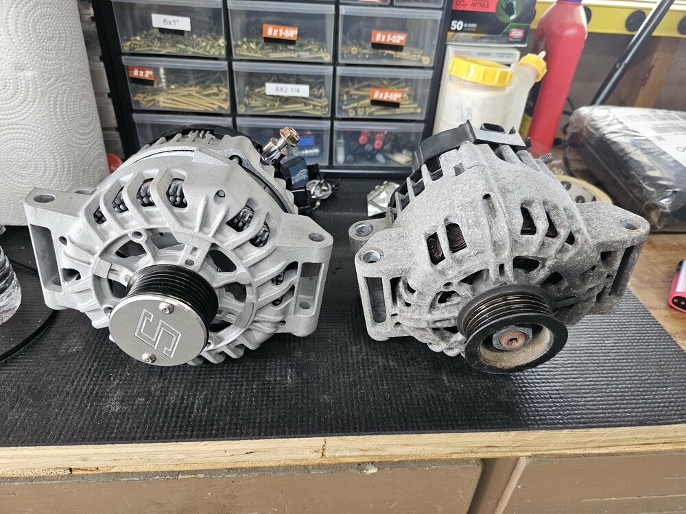

xXDigitizerXx Posted October 17, 2024 Author Report Posted October 17, 2024 I haven't gotten good results yet, having voltage issues, I bought a US Alternator fixed module set to 14.8 volts to externally regulate my Singer alt, to combat the GMC RVC, but it doesn't work, for some reason. I'm stuck at 13-13.2 volts, so I drop down to low 12 volts before I can even get half way up. Did 147.8 at 36hz peak at 12 volts on the glass, extremely not ideal. Going to send my alt back to get internally regulated, I chose to try this module so I didn't get the "check charging system" error on the dash, ended up with a $200 paper weight module..
Joe X Posted October 20, 2024 Report Posted October 20, 2024 Yes 12V dips is pretty bad, call singer for solutions, this is a pretty common issue, I am sure they will get you some answers.

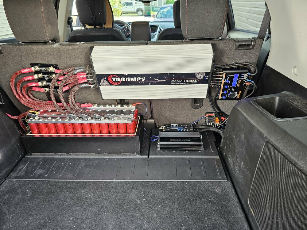

xXDigitizerXx Posted October 20, 2024 Author Report Posted October 20, 2024 18 hours ago, Joe X said: Yes 12V dips is pretty bad, call singer for solutions, this is a pretty common issue, I am sure they will get you some answers. Yea, I knew it was going to be some trial and error on the voltage, soon as this module didn't work, like it was supposed too. I should have went internally regulated from the start and saved myself $200 and headaches. I don't think this headway bank is sufficient enough either for this Smart Bass 8k. I have been looking into Cmax, just not sure, I want to be charging at 15-16 volts in this vehicle. GMC Terrains have enough issues as it is. So. I'll see what I can do, when I get my alt internally regulated and go from there, which will likely take a bit since Singer is a busy guy. For now, I have it tuned to 2800 watts rms on my basshead garage meter, all I can do without crazy voltage drop.

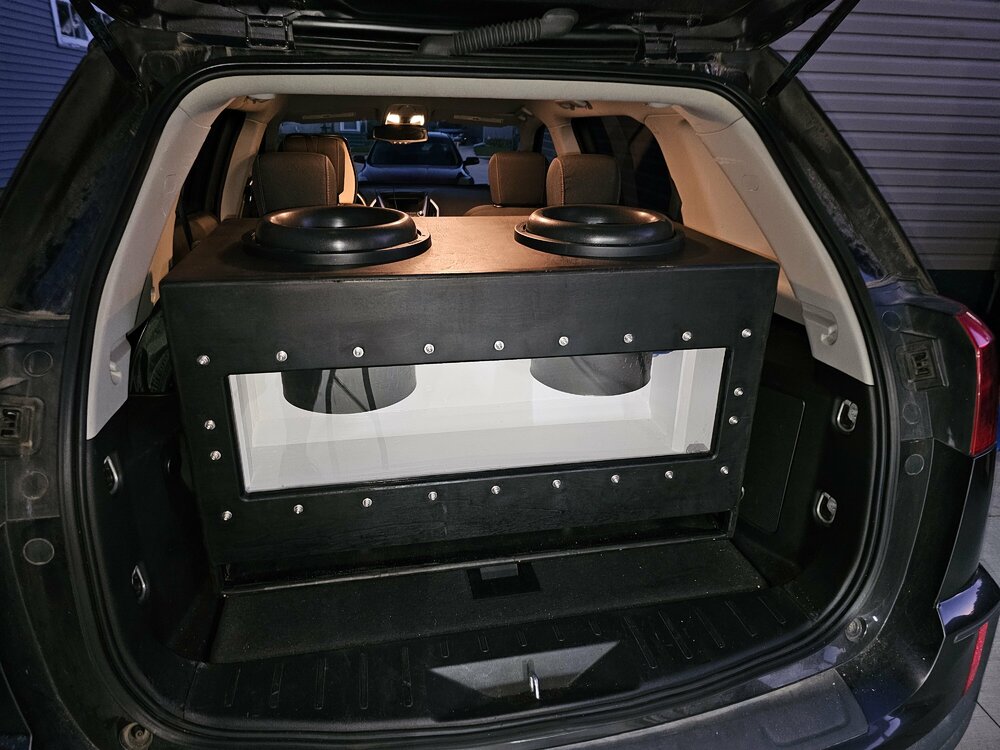

Kidd704 Posted July 11, 2025 Report Posted July 11, 2025 How did the box turn out? I have the same exact equipment, and I'm looking to build a new box myself.
xXDigitizerXx Posted August 14, 2025 Author Report Posted August 14, 2025 On 7/11/2025 at 7:12 AM, Kidd704 said: How did the box turn out? I have the same exact equipment, and I'm looking to build a new box myself. On 7/11/2025 at 7:12 AM, Kidd704 said: It turned out great, after the subs broke in and I was able to get my voltage stable, it's a 150+ db daily. Hits the lows with authority and does decent up to around 50hz. I have been running little over 6k watts clamped on them for quite awhile now. Added a short clip of them bumping. (the highs get drowned out when I record with my phone, but I can hear the highs just fine in person lol) 2 Zv6 12s.mp4
