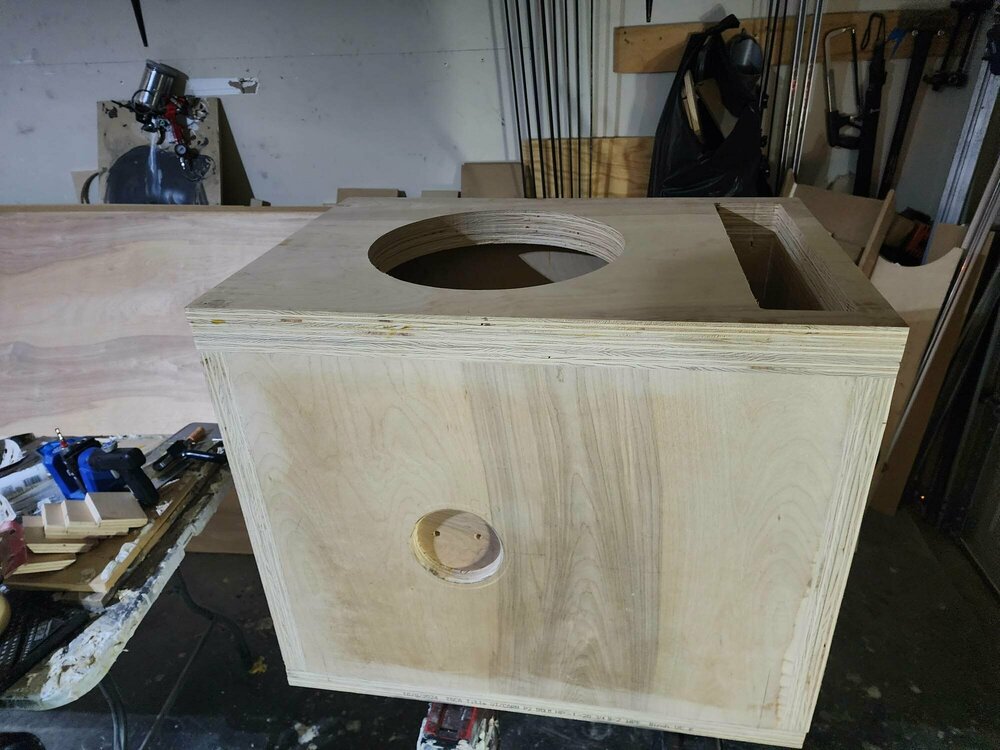

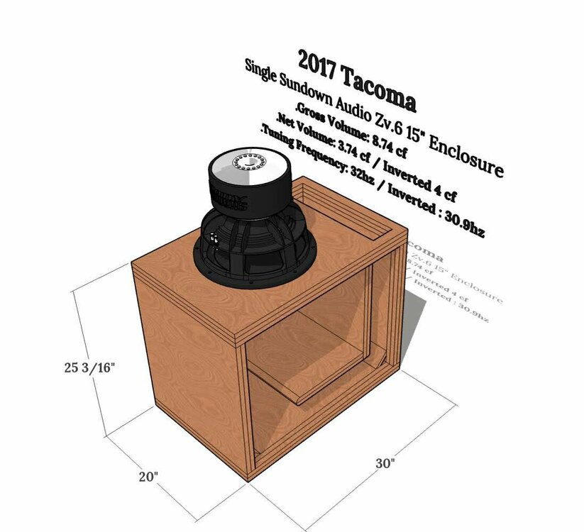

I’m about to drop close to 5 grand on this audio setup (including install) but before I do I wanted to hear everyone’s thoughts on what could be better or changed. What I plan on installing-
mids/highs - 4 deaf bounce Arnold neo 6.5 in the custom speaker pods for front doors, 2 sky high 6.5 mid bass for my rear doors. 2 deaf bounce neo tweeters in my A pillar from custom speaker pods.
subwoofer - 1 sundown zv6 15
mids amp - jp234
tweeter amp - jp MM1002
monoblock - ruthless 4500
electrical - 260 amp alternator paired with a 30ah noli sodium battery
DSP - Memphis VIV dsp
questions for the bass heads -
- will I be able to run my 6mids on the jp234? (each 6.5 speaker is 200 watts rms)
- the deaf bounce tweeters are 45 watts rms a piece and the jp MM1002 is 90 watts per channel will I be over powering them and potentially clipping/damaging the tweeters?
- Will my electrical upgrade be enough to handle all of this? (The shop doing the install says it will but I don’t want to be constantly dropping voltage either)
- should I go with the ruthless 4500 or the jp43 they are both $800. I don’t care for the better bass knob the jp43 comes with because I’ll be using a big Jeff audio rca bass knob
- Lastly is there any recommendations or changes I should make to this build. Thanks!
