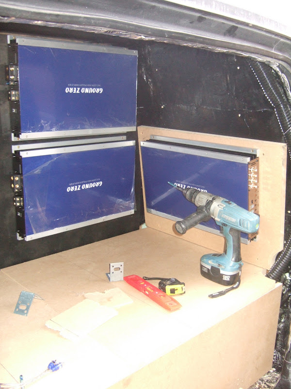

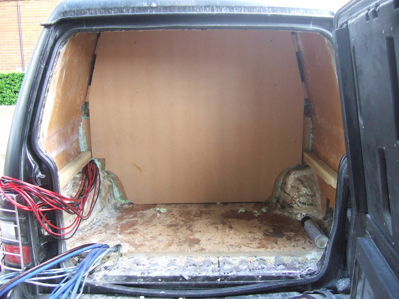

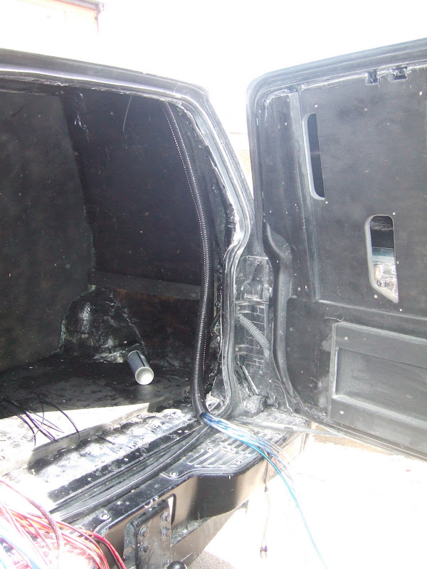

How we started the day

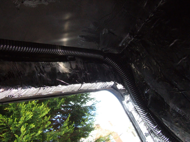

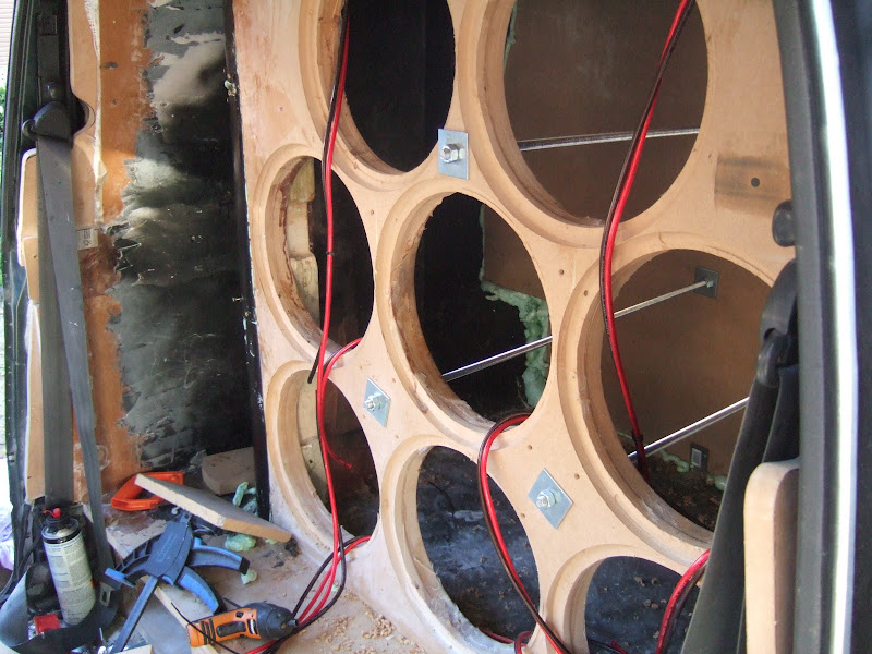

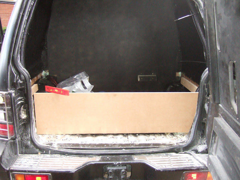

cables for rear door amp rack routed around the boot door

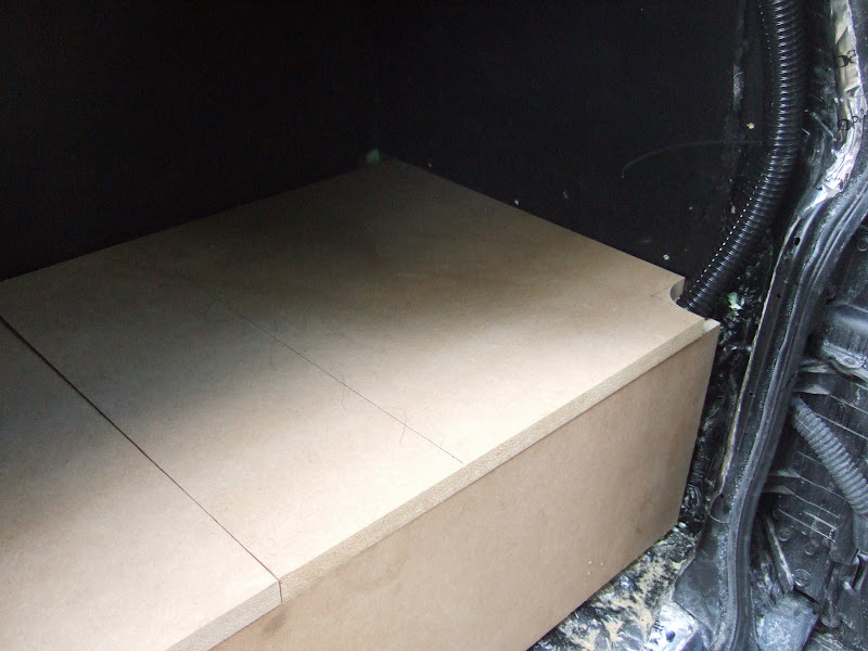

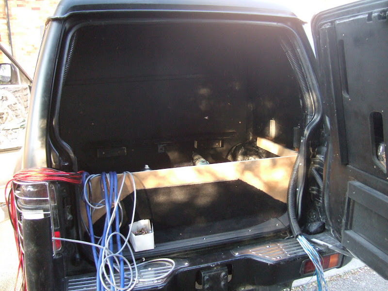

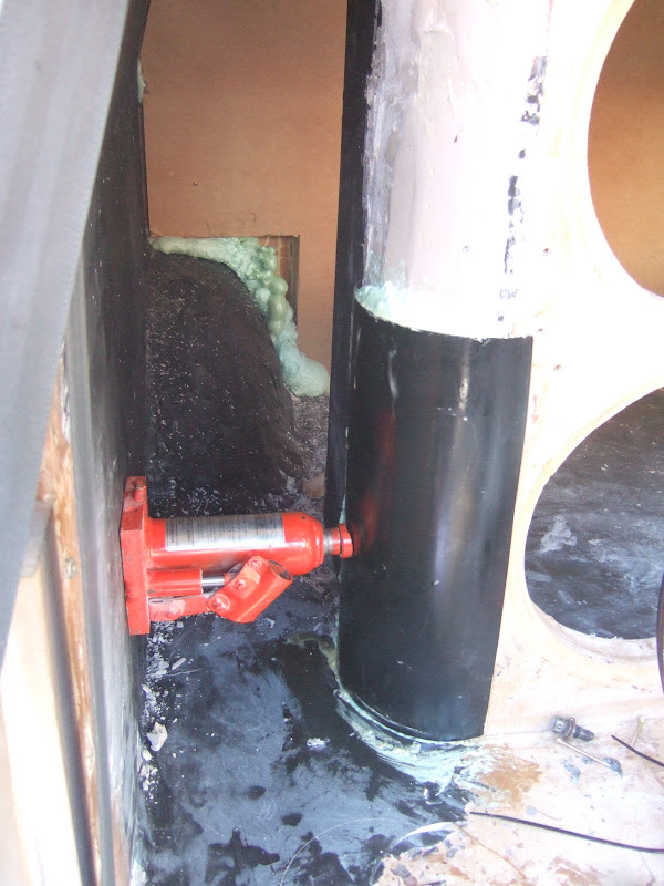

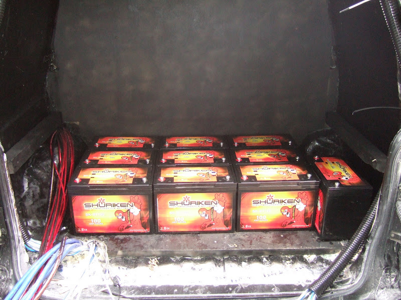

Batteries In

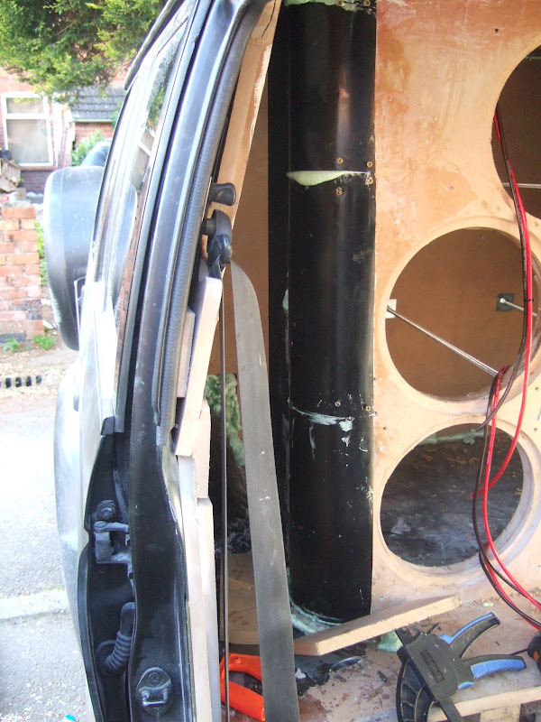

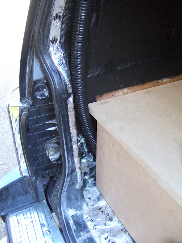

Battery Box taking shape
Box Lid on in 2 parts

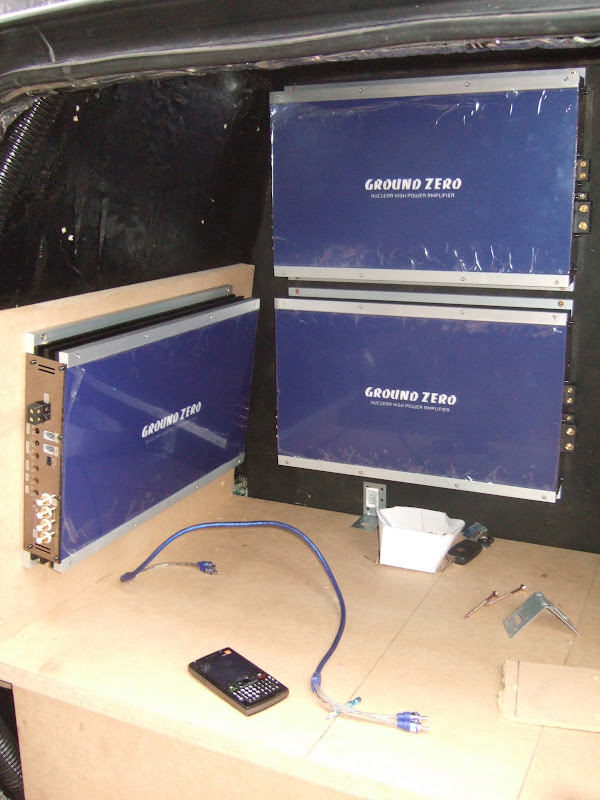

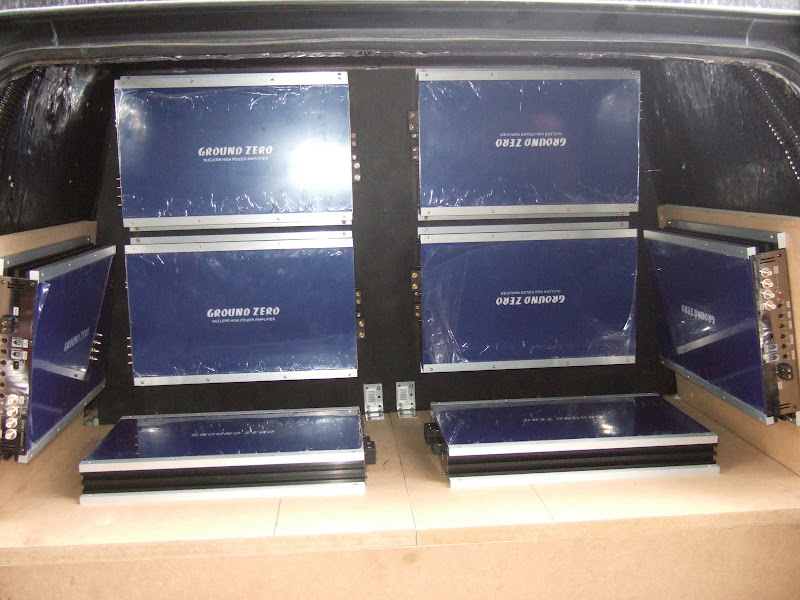

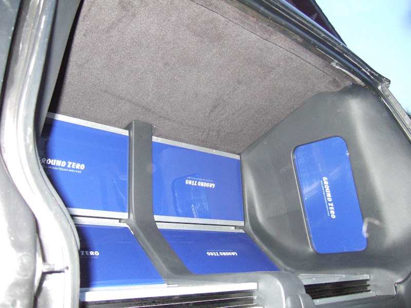

Amps in the final position

Today's progress has been all hidden stuff really - took everything out that paul had made - it goes together so well I'm almost looking forward to cabling it all up!

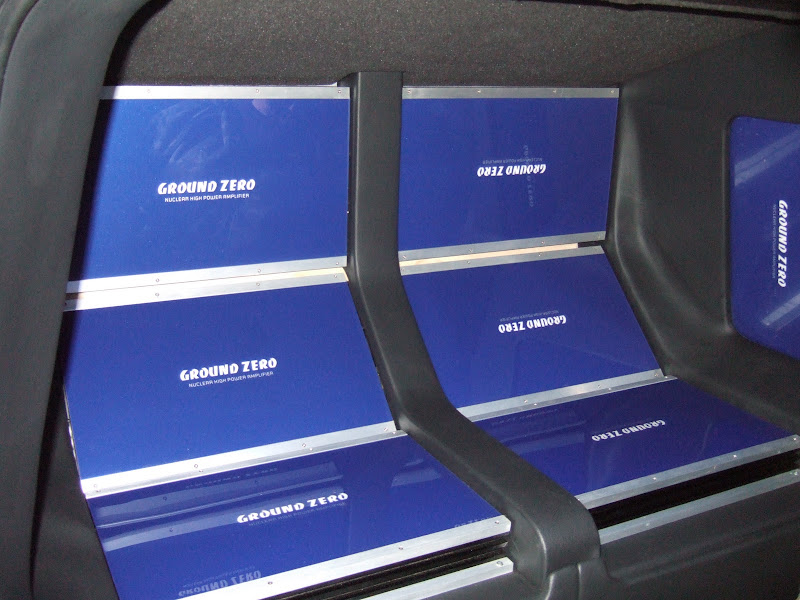

A few more shots of the back - got it back from Paul @ A1 Audio Designs last night - to say he has done a blinding job would be an understatement
The rear speakers will be mounted in the roof firing down
then Took it all out to take down the back wall
and seal it up

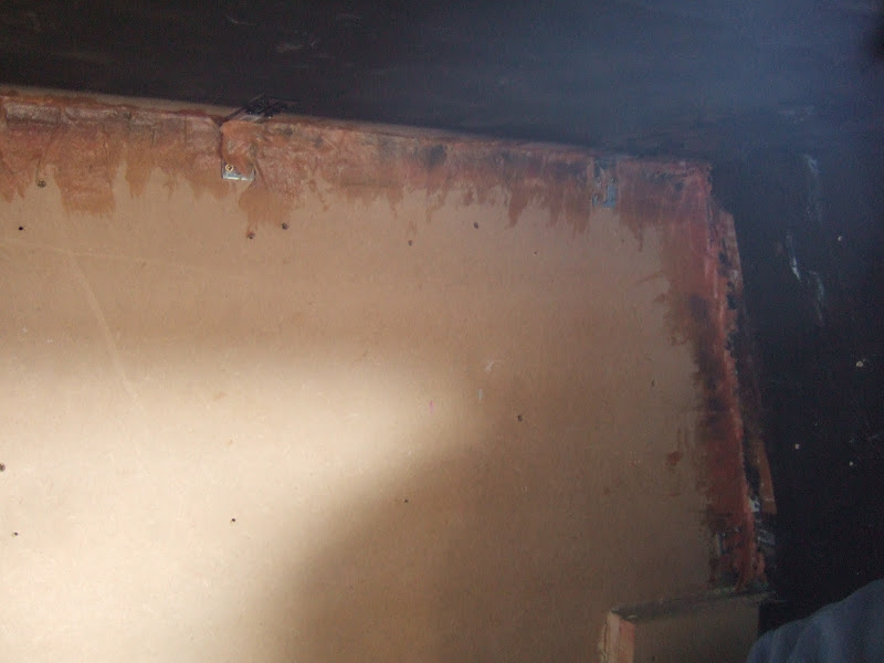

Plus added a little bit of strengthening - M12 style
And then started on adding the port cladding
Currently held on with screws to keep them in place - they will be filled and smoothed when done

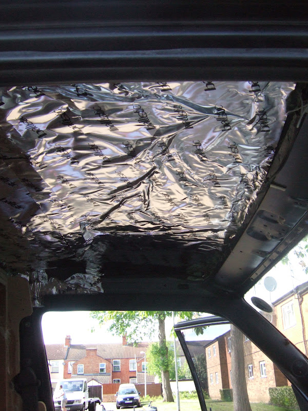

Also sound deadened front of the roof and put up a single 18mm mdf sheet - filled that with expanding foam - tomorrow I will lay more up
i dont know about you but id hit that deadening with a roller to get out all the air bubbles
