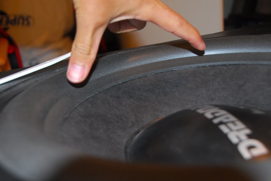

I have a slightly different problem: a small section of my rubber surround is coming off the cone (not the basket). Should I use ca glue for that or rubber glue? The speaker is a MMATS Dreadnaut 15. thanks guys.
Here are a couple of pictures of the area in question. Note that the rubber is simply coming unglued from the cone.
So, would that loctite lotion be OK to carefully pour in between the cone and the rubber surround? Please help..
