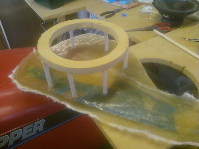

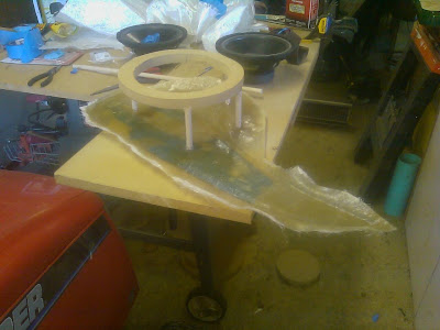

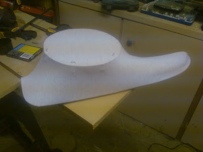

anthonyott99 Posted January 8, 2011 Report Posted January 8, 2011 ok guys, starting to build a complete enclosure for my doors to house some 8" mids, something like this : Ok here is how i got started : I did what is called a ( flat lay-up style ) so i will have a back for a full enclosure for my sub and so it will also be completely removeable.

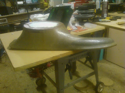

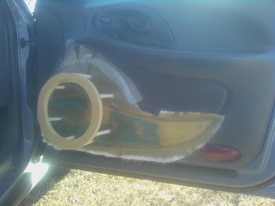

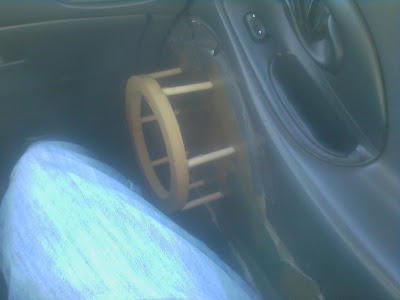

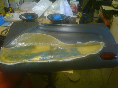

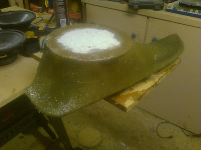

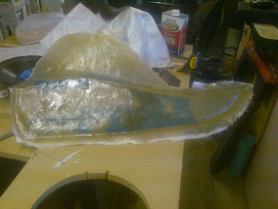

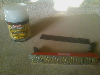

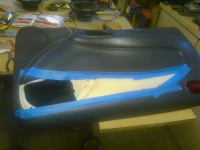

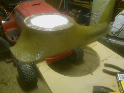

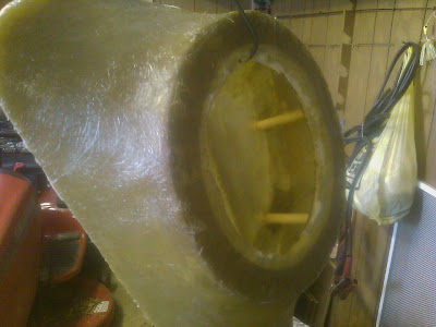

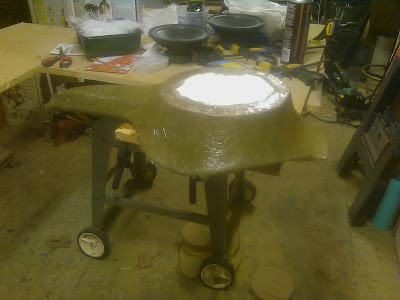

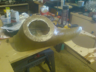

anthonyott99 Posted January 12, 2011 Author Report Posted January 12, 2011 Test fitting . . . . . . OK ready to stretch fabric and make my first mold !! First 'glass layin !!!!!!!!!!! First layer of chop-mat !!!!! 2nd and 3rd layers complete !!! Gettin ready to sand and lay body filler !!!! Fiberglassin the inside seems and wooden dowels for strength before sanding !!!!! Thats it until i start sanding tomorrow and put up more pics then !!!!!!!
PUNKYOU007 Posted January 12, 2011 Report Posted January 12, 2011 looks good, i would have angled them up just a bit. looks like a good job so far. Doethepaperboy "Bars of Pain" Doethepaperboy "Hero Remix" C. Arson d(-__-)b beer sucks...but i can bring some jose cuervo. Only problem is that it makes me horny and gives me the rams. So unless yall wanna fight and then have some great make up sex i will leave it home.
TheBetterMethod Posted January 12, 2011 Report Posted January 12, 2011 Looks like a great first try! Keep it up. 2005 Subaru Outback Wagon Pioneer 9400BH Fi Q 15, SAZ1500dV3 The first build>>> http://www.stevemead...-outback-build/ 140.9 @ 36hz Sealed on dash! REBUILT!!! 2 Fi Q 15s, 2 SAZ1500dv3 146.9 @ 39hz dBDRA certified
anthonyott99 Posted January 12, 2011 Author Report Posted January 12, 2011 looks good, i would have angled them up just a bit. looks like a good job so far. I thought about an angle but there would be no real benefit with a sub so i just went with what would be easier and what i liked as far as looks ! Thanks for the encouragement !!
vexproductions Posted January 12, 2011 Report Posted January 12, 2011 Dam for your first time at it looks real gud .... keep up the gud work ...
Mendozauly Posted January 12, 2011 Report Posted January 12, 2011 Damm cool job, they are looking good. I hope they hit and help fill that front stage for you. Im thinking of doing the same for my expedition but waiting to see how your come's out if not im going with a pair of 6x9 speakers. Alpine D900 head unit 7" flip out t.v Kicker 6 1/2 components (front,rear)KS 6502 MB quart 3 1/2" in front A/C vent's (center channel) DC Audio LVL 5 18" (pair) Custom ported box Sundown 4500 at .5 Sundown 100.4 XS 3100 up front and a pair of XS 6500 in the rear. 1 17" Eiger Vision T.V 2 7" Eiger Vision T.V in Second row. Dynomat Top to Bottom (foam in all halo beam's) DC Eng Alt 260SP and a 400SP dual set up. big 3 Sitting on 24" If your neighbor don't complain it's not Loud! So you best go fix your shit !!!!!!!!!!!!!!
Team808 Posted January 12, 2011 Report Posted January 12, 2011 looks great so far.1 thing i would do is fill the enclosure with polly fill,this will help the sound of the midbass driver. Member of Team 808 Member of Team North East Spl
anthonyott99 Posted January 12, 2011 Author Report Posted January 12, 2011 looks great so far.1 thing i would do is fill the enclosure with polly fill,this will help the sound of the midbass driver. You know what, i have thought of filling in my ported sub box in my trunk with poly-fil of egg crate but hell, i didnt even think of filling these ? !!!!
