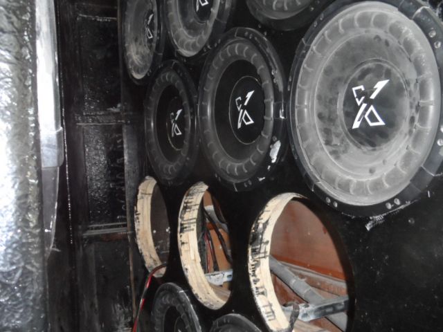

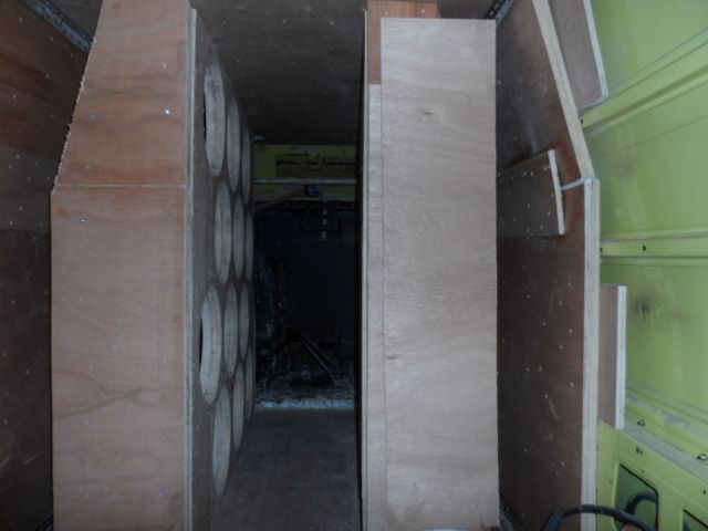

Kind've hard to understand your question. Are you trying to make a slot port on the right side of the picture?
If you're also asking about port orientation. I would port driver side. Assuming you're metering legal. (Meter on passenger side lower windshield)

He is asking if the rear chamber ports should be straight or follow the angle of the box. In the pic you can see the port on the left following the angle and the port on the right is just straight.

He is asking if he should do both of the sides like the left one or the right one pictured, angled top or not.
Stefclim: the geometry of the port is not the most important thing for your rear port. The port area and tuning is going to be the most contributing factor I would look at which ever design gets you the correct tuning and area.
Is the rear port length only the board faces we see? If the port length is not designed to extend forward again along the sides of the enclosure behind the subs, I would do both like the right...
Team NorthWestSPL
yes that right because if i choose to follox the angle of the box i got 45 cm deep in the bottom and 25 on top of the port and if i choose straight i got 45 cm everywhere
sorry for explain that i know exactelly the dimension of the rear port because my old systeme is nearly the same with only 18 x3
my port dimension on this systeme180 cm high 20 cm wide and 45 cm deep at 20 cm back of the box
my volume are 1435 liters in each rear chamber and 2000 liters front chamber what do you think about volume for 6 th order
more open my score grow up around 0.5 0.8 db but i loose in demoing before smell goat in the van
no body already do port follow curve of the box like me??
i want to know if sub nearly top of the port where he doing 25 cm have same xmax sub are the bottom where port doing 45 cm

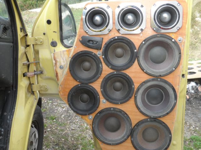

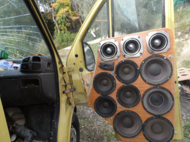

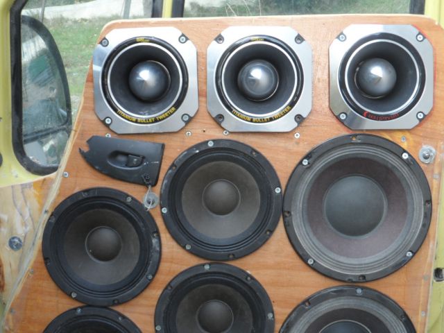

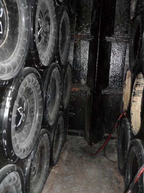

my doors with 4 10mi100 beyma 4 8 mi100 beyma and 2 supertweeter dragster dtx310 and 1 super tweeter sp audio the same

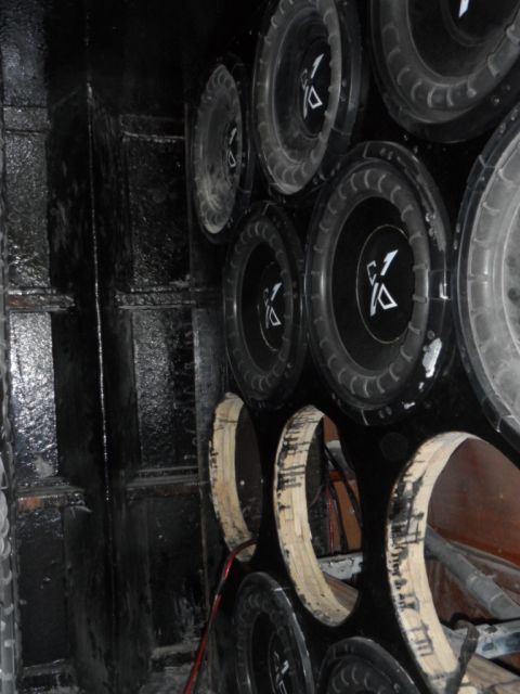

the back with 24 soundstream x3 18 d2
is it good think for bass racing
