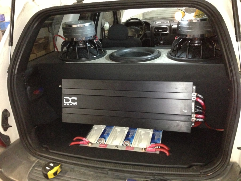

I have a third DC Level 4 12 that will be heading down here soon... And am getting ready to build a new box... The two outer ones will be inverted and the center will be normal... The reasoning for doing it that way is the ass is just too fat to be tucked away in the box... And the third sub has a full dish carbon fiber, so will be showing it off... Also by inverting two of them I gain about .4cu The subs will be on a DC5K wired at .67ohms... 320a Singer alt has just been ordered and two more 90ah AGM batts will be installed for a total of 4... But anyways here is the basic plan that I have... The box will be built with 3/4 ply due to not having MDF here, and the center blue piece in the port is a brace to keep everything solid...

is that the biggest you can go? port and box seems small as hell, but once again, i haven´t tested those subs before, i know they recommend small boxes on their manual, looking at the specs i say i would never use a small box for those subs, but that´s just me...

that is over recommended at least. rec is 4.5. his is .7 over that.

my sony xplod 15s recommended 1.5 c/f per sub and i used 3 c/f per, just saying lol

if it was me i'd swap the placement of the subs around so you only have one sub that is basically firing into the port instead of the two outside ones doing so.
does that make any sense? lol

The plan is to do something like this... but with level 4 12's... And as for a bigger box, I can't use all of the space in the truck seeing that the rear seats still need to go up...
