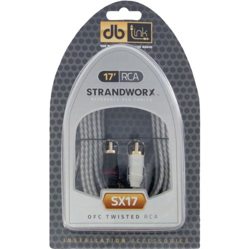

SIDE SHOW Posted July 30, 2014 Report Posted July 30, 2014 Why is the left and right rca's different? ground both rca's together and test again. ground your amp/s to the chassis or seat mounting bolt
BerT6801 Posted July 30, 2014 Author Report Posted July 30, 2014 Well I had to return the van while I am away for a week for vacation, I will try the things advised here when I get it back in a week.. Thanks for the input... Why is the left and right rca's different? ground both rca's together and test again. ground your amp/s to the chassis or seat mounting bolt They are DB Link Strandworx,,, they are grey/white colored
SIDE SHOW Posted July 30, 2014 Report Posted July 30, 2014 AHHH okay. just looked like on the the rca'swas a lot thicker than the other, but they should be fine.
