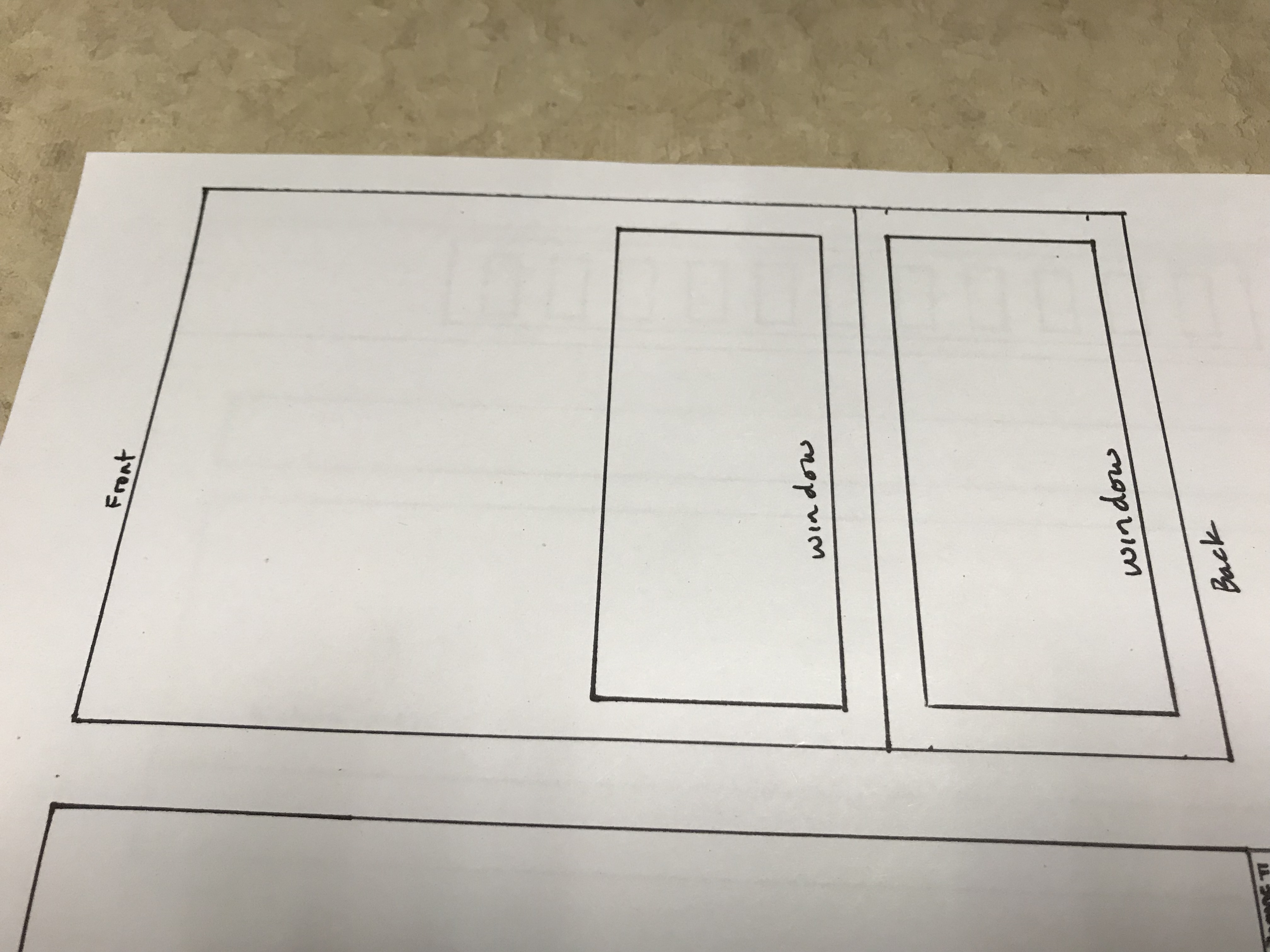

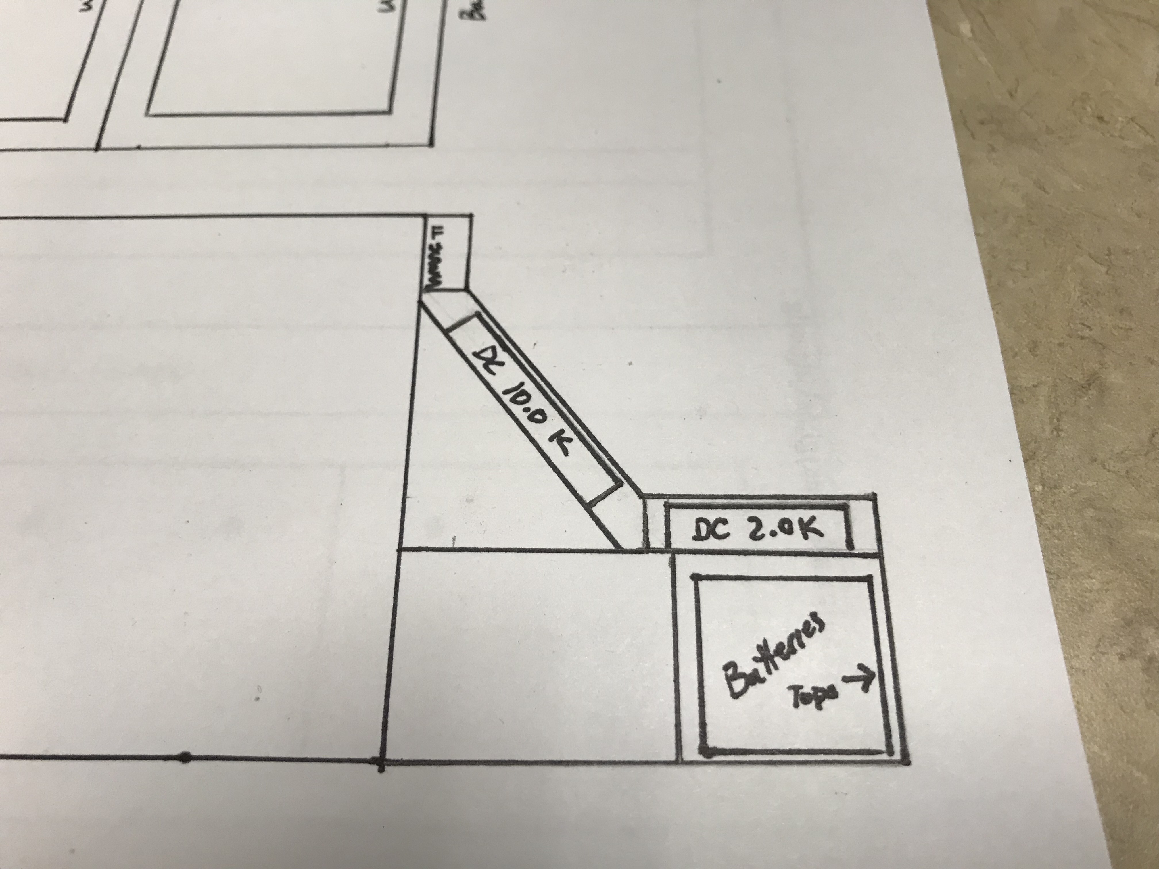

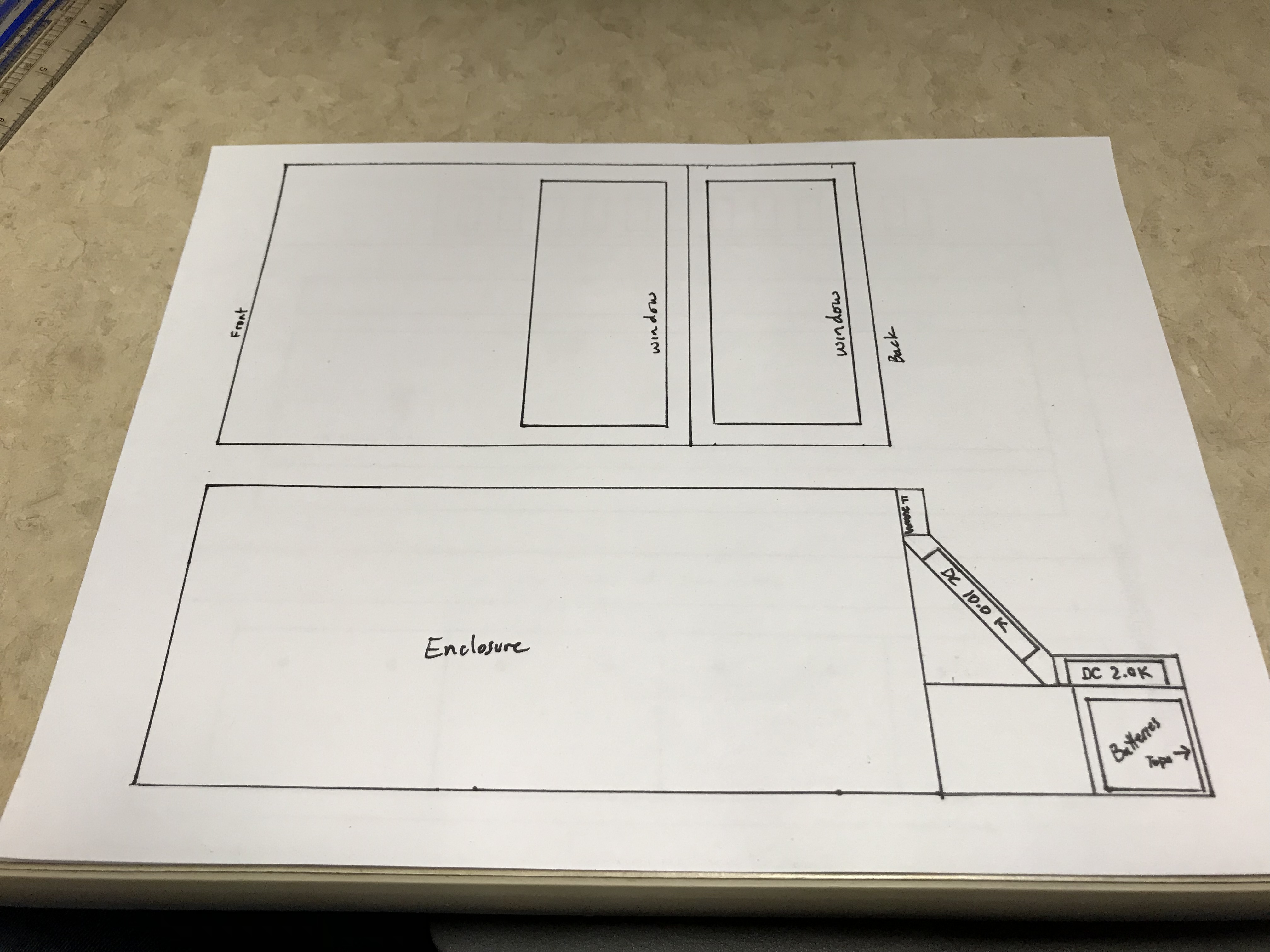

I’m not sure how it’s going to load but here’s one of those drawings.  Cab is to the left of the page, so the tailgate side is to the right.  Battery rack against the tail gate, batteries laying down so the tops are facing the tail gate.  On top of them would be the DC Audio 2.0k.  Above it at an angle would be the 10.0k.  If I have enough room.  Then fuse holders.
The upper picture in the drawing would be the top of the enclosure. Thinking about cutting in some windows and putting in some acrylic or something so you can see the subs from the bed.  I thought about putting some mirrored plexi on the cover so it would reflect down and you could see in the enclosure without actually having to get up to it and look down.  But that may be a stretch.
So that’s it for now.   I have a thought on a battery rack under the truck, and I think there’s room for it, but I have to do some measuring and see for sure and there’s that whole needing to learn to weld thing still.   But this would be sweet if I could make it work.
Ok that’s all for this check in.  I’ll post the other pics of the drawing. I can only do one at a time it seems.
