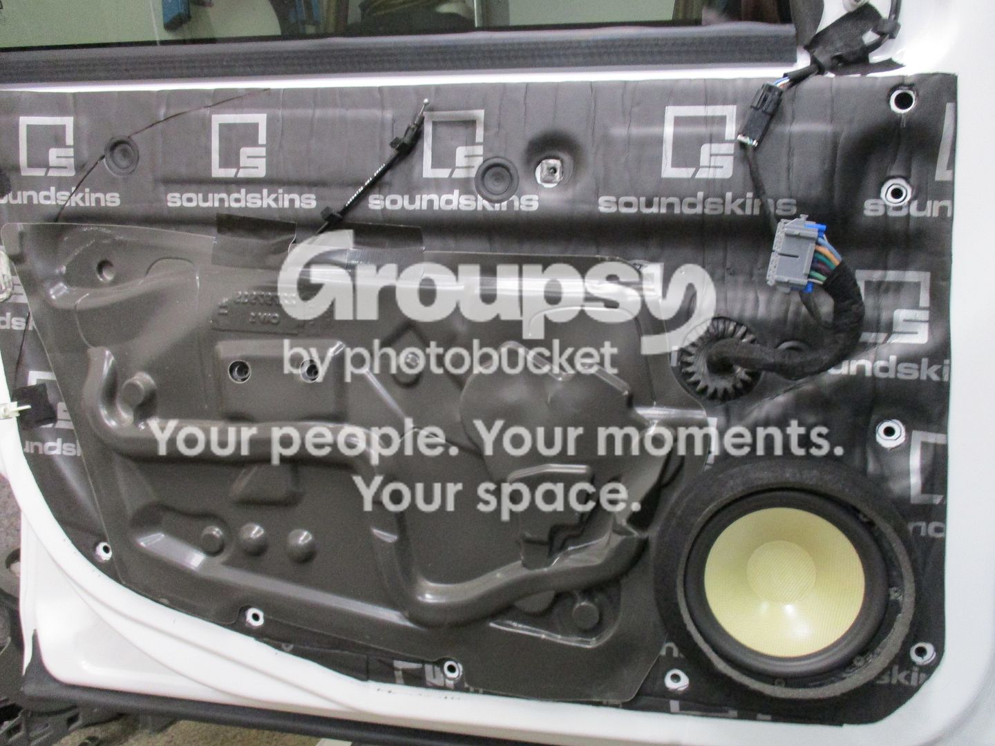

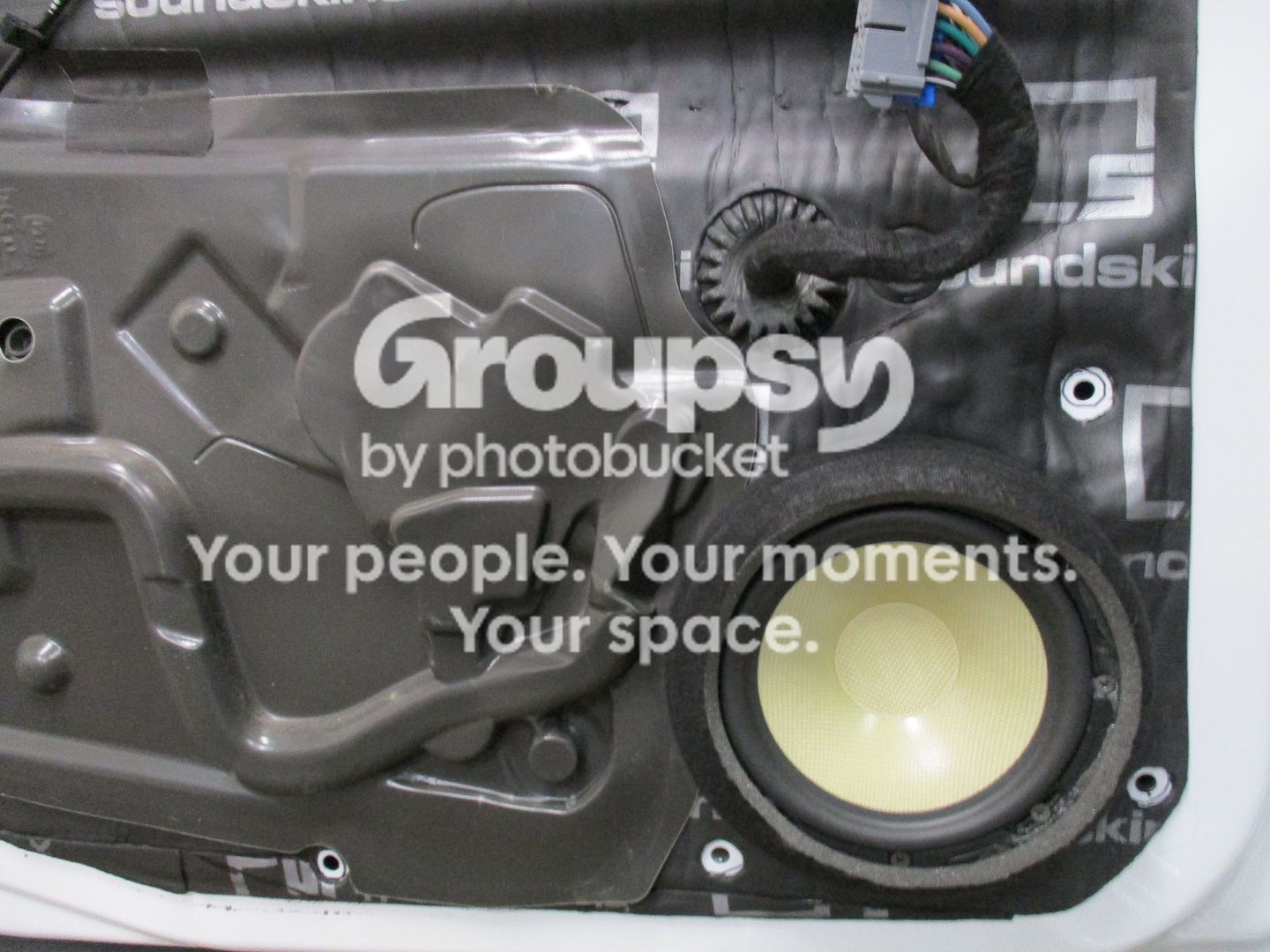

IMG_1177_zpsbikklthz.jpgThe fast ring i had on was to thick for the panel to go over. Everything is real tight on the left side of the speaker. Panel fastener molding by speaker makes it tight.
IMG_1175_zpsvyl2txsz.jpgI made a Fast Ring out of closed cell material left over from the Stiger 6x9 kit. The Plug for the back wave. Everything is tight so trimming deadening to get panel back on.

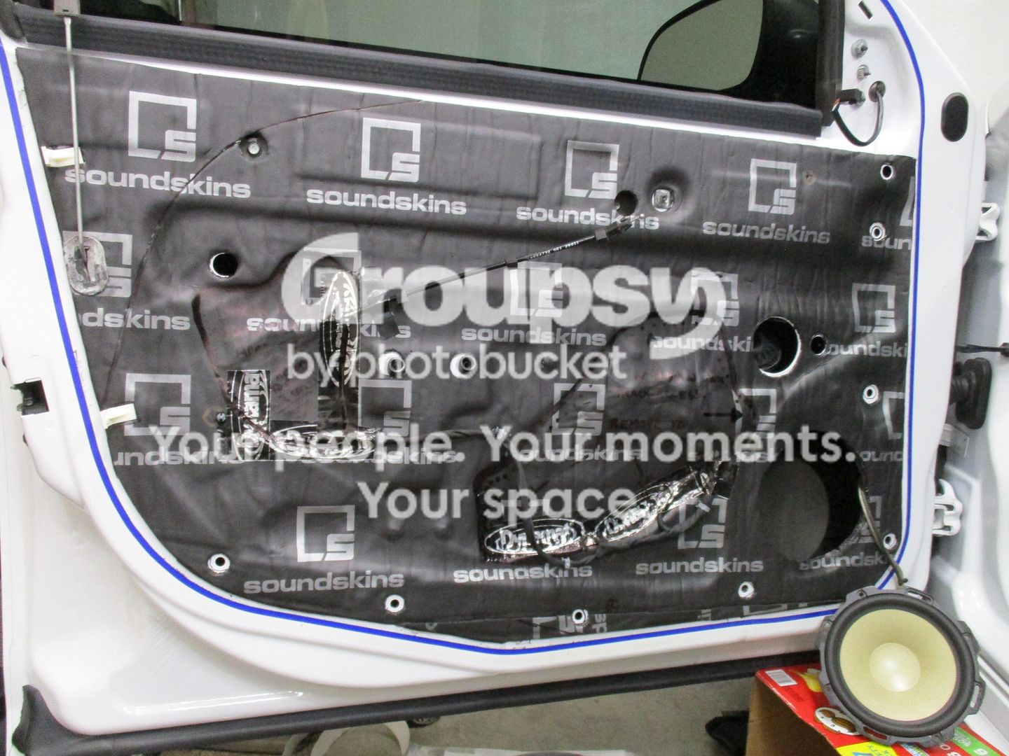

IMG_1178_zpse5ysfcaz.jpgFactory vapor barrier blends in and looks good. I wasn't sure how it was going to look but knew i wanted to keep it installed just in case soundskins behind it ever gets removed for service or repair. Its fun to be able to work on it while listening to tunes come from the speaker in front of you.

IMG_1191_zpswbcehkv4.jpgDoor cleaned and prepped for deadening.
IMG_1192_zpsrlurnpqi.jpgAdded some small pieces to the outside inner again.

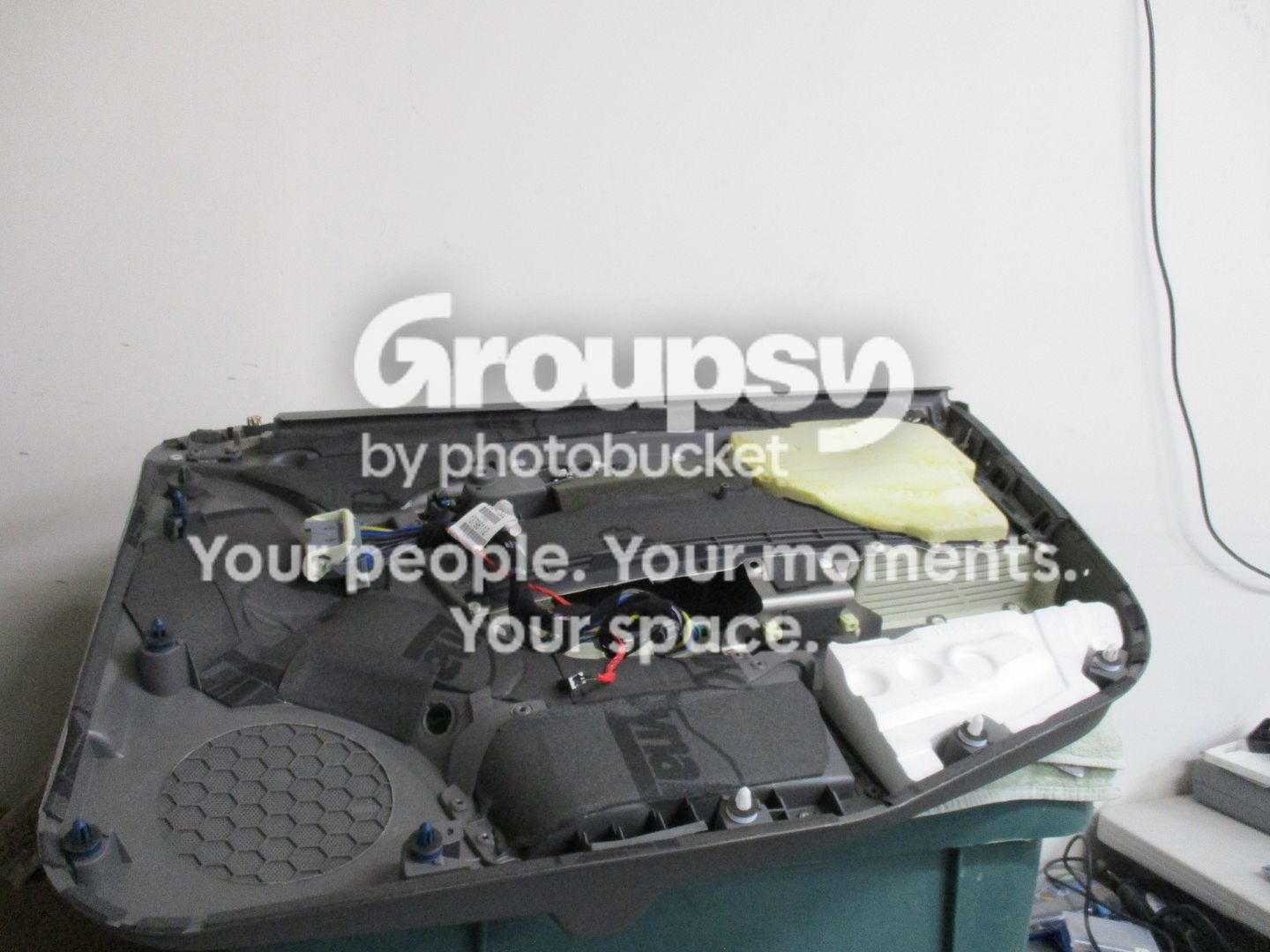

IMG_1194_zpsjwwhftob.jpgInside the panel, Stinger Road kill is under the dynamat foam.

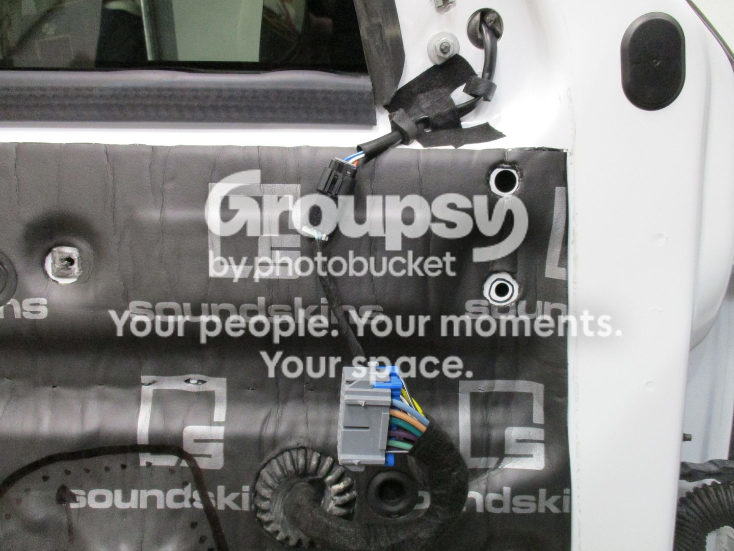

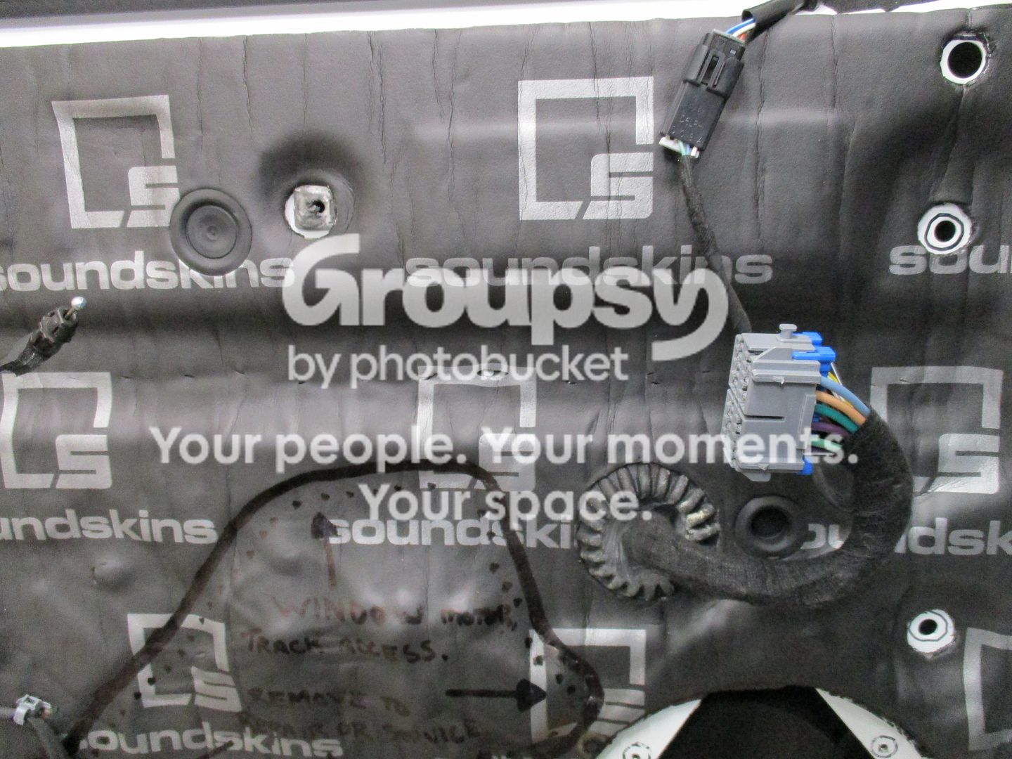

Main harness and mirror wiring Tesa taped up.
Another look at harness and speaker opening.

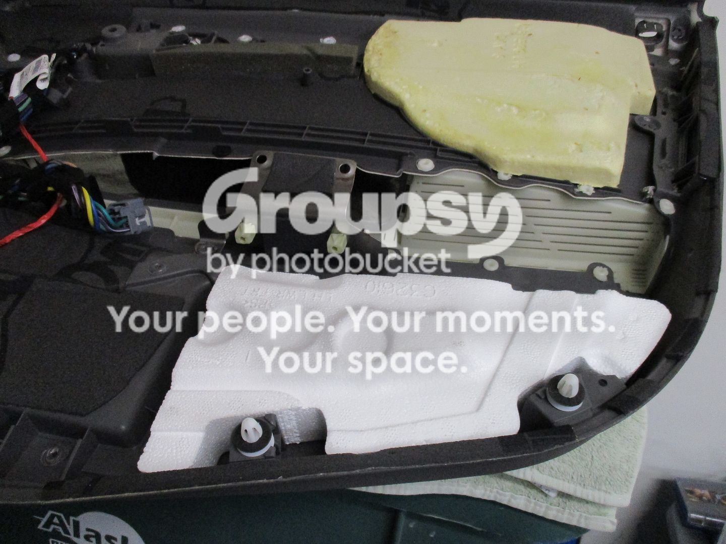

I spent some extra time putting acoustic foam to backside of panel. This finishes up the doors after i put the panel back on.
I have about a 1/4 roll of soundskins left and i found an area that might need some more attention. That will be next. Last of the deadening for this round.

Acoustic foam? What about doing ccf over the deadener on the door to decouple the panel?
7 hours ago, Kyblack76 said:
Way nice. Great attention to detail mate...
Thank you sir.
CCF? I figure with the Soundskin on the door and the foam on the panel was above and beyond. It's what i had to work with. And if you can show me how you did it in your build log i would love to see it.
