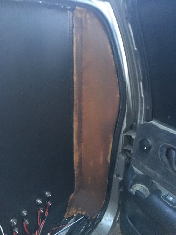

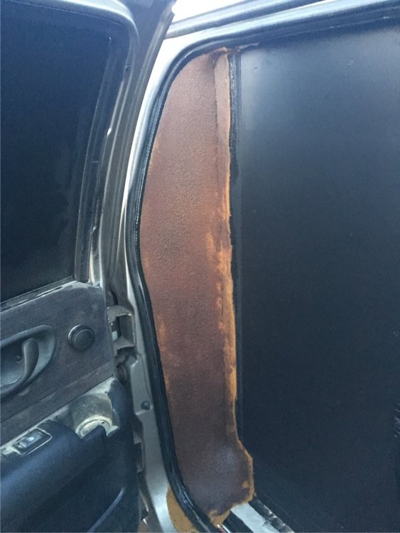

Started the b pillar seal off! Wedged fleece under the weather strip seal, then stretched to the side of the wall. Then soaked in resin. Will make it a few layers thick of fiberglass. Hen sand, fill, and paint to match the wall.

Exactly how i did mine. Stretched some fleece, and wet it. I wet it, then used some 5oz mat, front and back,  and then, ....DURAGLASS.
The duraglass was rad,  a bit rough to work with but,..
It was a filler, WITH kitty hair in it. Strong as fuck. Then, did the light mud (rage) then, sprayed laptor liner on 4/5ths the cabin lol....... shit looks almost exactly like how i did it, but, it looks better and cleaner lol.
Nice job bud. Nice fuckin job.....:)
Stay the course bud... im super stoked for ya....
Thanks man! I was planning on just using multiple layers of chop mat. Thats the only fiberglass ive ever really dealt with. But ill look int duraglass and may give that a shot.

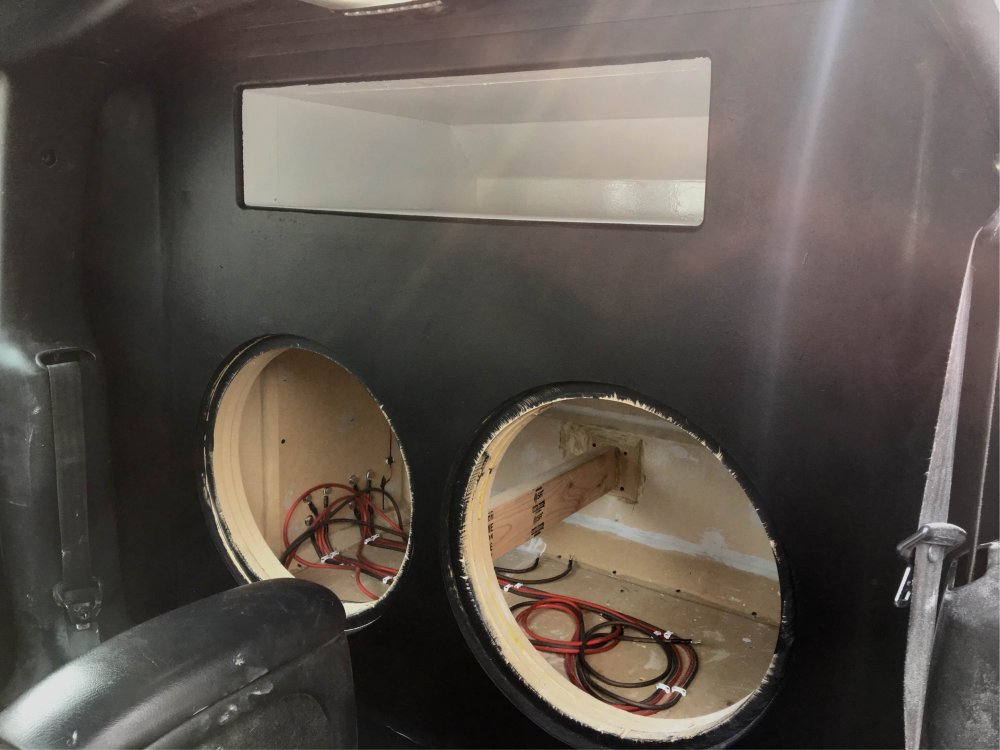

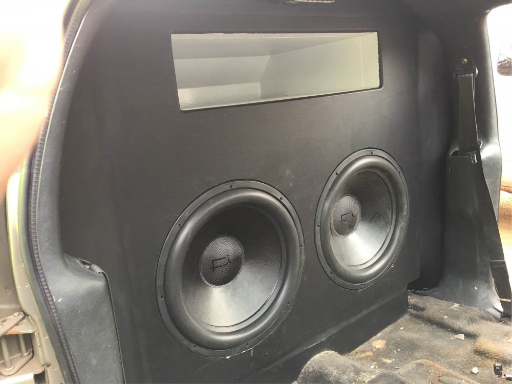

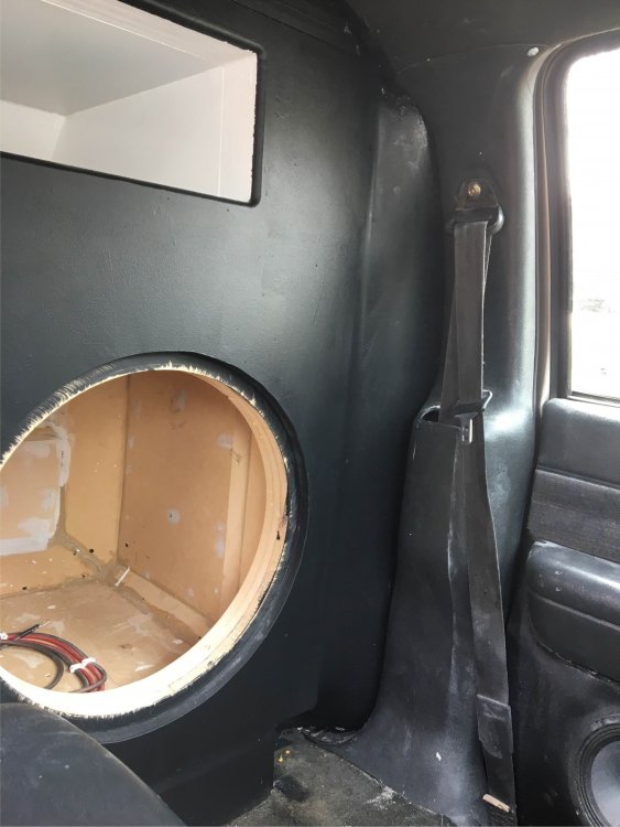

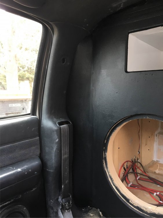

Got it all finished!!! Put 3 layers of fiberglass woven mat and a layer of chop mat on the seal off panels. Super tough now! Body filled and sanded them smooth. Got them all painted, and even got the subs mounted today! Now the only thing left is to tune all of my amps! Should be playing tomorrow :)
