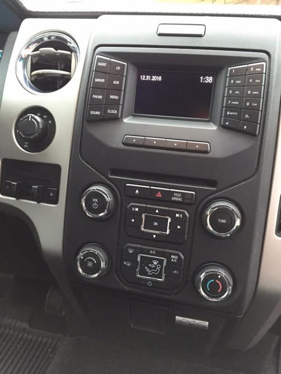

Hello everyone.  I am wanting to put 2-Sundown 12's in my son's 2014 Ford F-150 4x4 with sync.  I am wondering what options I have as far as installing the subs in this truck.  I have been searching for stereo install kits for this particular factory radio.  If I could find an install kit for the truck I would buy a new head unit for it.  Can someone point me in the right direction as far as locating a kit that works with these factory controls.  Any help would appreciated.  Here is the picture for reference.
most people go with factory integration using a processor. but iDataLink and Scosche both make kits to throw a headunit in there.
https://www.amazon.com/iDataLink-KIT-F150-Replacement-Dash-Kit/dp/B010RHVPPE/ref=sr_1_1?ie=UTF8&qid=1483300864&sr=8-1&keywords=k150+dash
https://www.amazon.com/Scosche-FD6206B-2013-Up-Integrated-Control/dp/B00K8CJ38A/ref=sr_1_1?ie=UTF8&qid=1483300803&sr=8-1&keywords=Scosche+FD6206B
Not cheap but still cheaper than using a RockFord 3.sixty or a JL Cleansweep, something of that sort.
I got a 2010 F150 and went with the factory integration .
Well it looks like I will just use the existing stereo integration.  I think I will start by ordering the Audiocontrol LC2i.  We are going to put 2-12" Sundown E's on an American Bass Phantom 2500. Just some nice low end slap.  Nothing mind blowing.  Thank you guys for replying.
