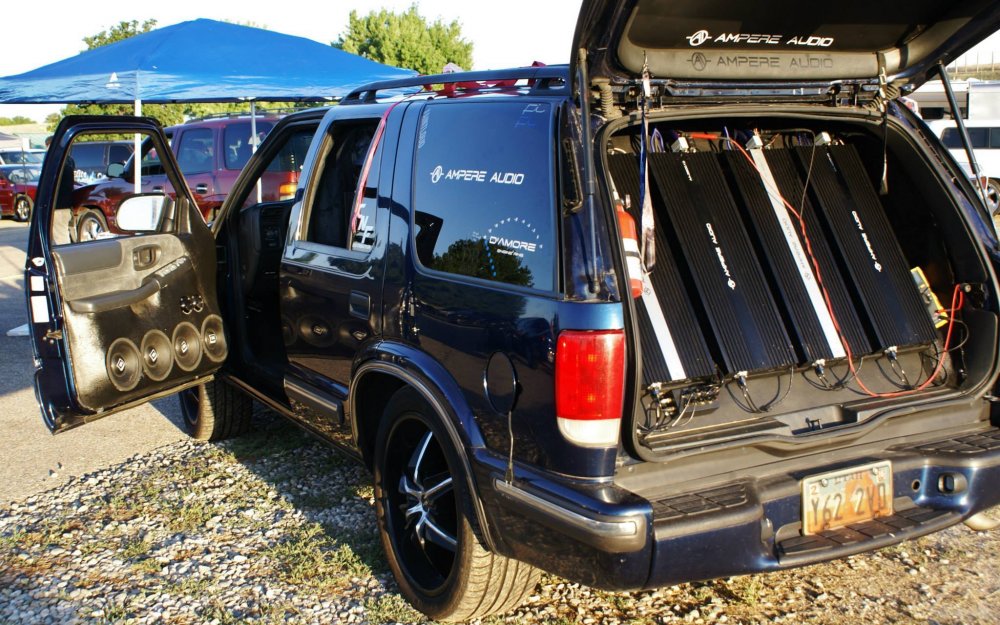

Blazer build. Its a one in, 4 out. Bottom left.
Second is a one in, 6 out. On the roof.
Its just mounted where it works easiest, looks OK, and functions. Used them for a while and they work. Plus, i love Scott. I like supporting him, and what he does. You can just buy some 2 dollar splitters if you want. But,..... meh, i run what i run, for more than a few reasons. And, always will.
That's a nice setup there..
