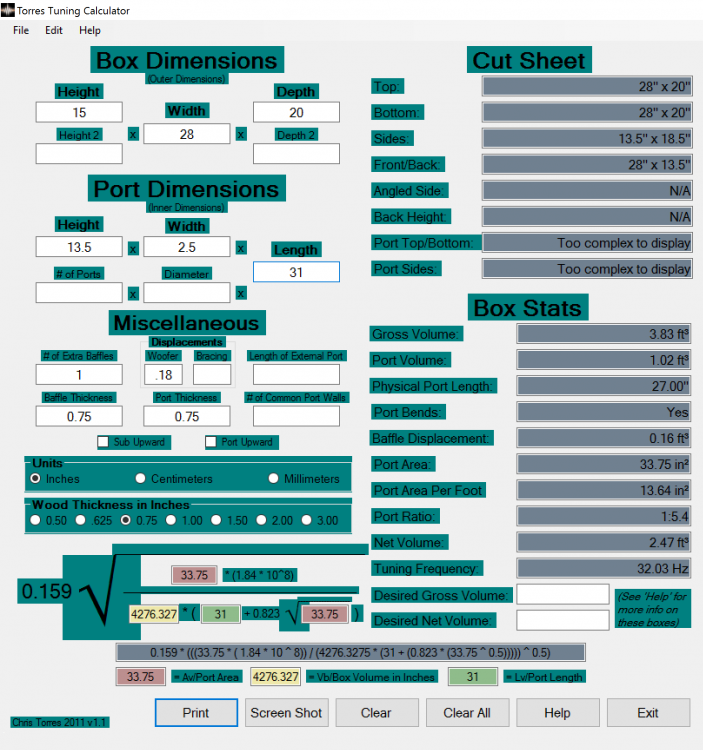

So I'm very unhappy with my current box. I have designed one that I think will sound much better. I am wondering if there is someone that would be able to bring my design to life. I use torres but would like a visual of how it will go together and what my port cuts should be. I don't have a CAD program that will allow me to do that. I'm open to any suggestions as well. This box will be built for an Fi Bl12 V3 on 1500w. It was suggested to me to shoot for 30sqft of port area. Thanks in advance to anyone willing to help me out.

biggest problem i see on your design is the port lenght, there's a point where the longer it is the worst, i always try to stay at around 23" long at the most in case of an slot port like yours, i would DEFINITELY use a 6" aeroport on that design and stay at about 2.7 c/f , that should do nasty!
