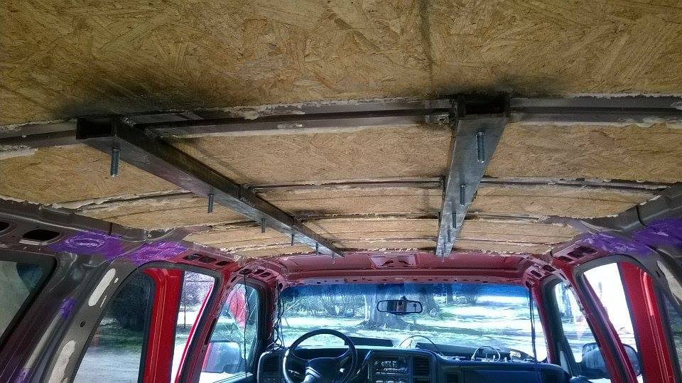

First layer. Just OSB to take up some space and add mass.  Cheap and easy. We used cut 2x4's cut to length to "press" on to the metal (roof). All thats holding all of that, is 30 cans of spray foam. Then, we even'd it out with a 3/4 sheet. You dont need to go this large, 2 small peices on your roof and your done.
58ded05c63f1a_11042062_689861904455851_2127780311_n_zpskqygelpp(1).jpg.adcf965f33e9d24d3d558aabe87a1c4f.jpg
No need to over think.... keep it simple, and effective.
That pic looks like its from a GMT400 Tahoe/Burban. Ill tell you what we actually did in one of them with an 8 15s build.
Sprayed foam between the skins, and taped up the gaps with painters tape. Once the foam cured, remove the tape.
Once you do all that, it is ready for wood.
Worked great.

Its not pretty but the back half is in, gonna get some expanding foam and work on the front
It's solid as hell now, not to sure about this foam stuff hoping it gets hard and stops all this noise. It's solidified in the back for sure
Keep us posted on the progress and finished product
IG @walledsonic
Sorry I'm a little late to seeing this but I used PL premium and 3/4 MDF that I kerfed to contour to the roof.
This is the second piece I put up, the spots that don't have any adhesive are where the ribs in the roof are so the wood doesn't make contact there.
When I put up the second piece it didn't want to stick on the outside edges as well I think it's because the strips holding everything up didn't have enough pressure. Good thing we have a couple jacks at the house.
Then after all of that I used angle iron to attach the roof wood to my steel cage this might be more extreme than you're going but I can jump on my roof behind the B-Pillar and it doesn't move.
Rear section of the roof C-Pillar to back.
B-Pillar to C-Pillar
