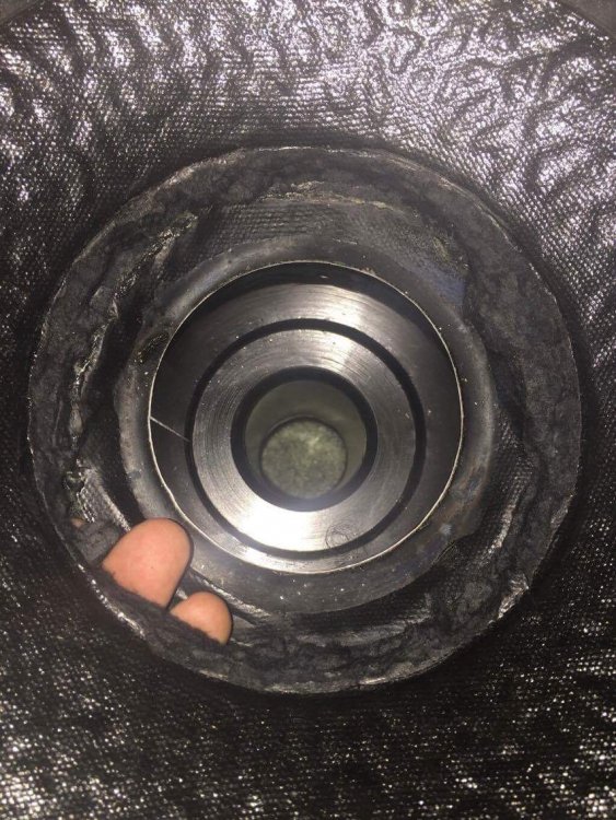

bolanorthhighlands Posted April 9, 2017 Author Report Posted April 9, 2017 When I input my t/s parameters in winisdpro. The program said my specs were inconsistent. I had to erase one of the numbers and let it auto fill. But I can't find xmax. Can anyone guess the xmax?(this is what my sub looks like in the inside(without the damage). Do I really need the xmax in winisdpro? My 2002 Kia Spectra LS My YouTube Channel

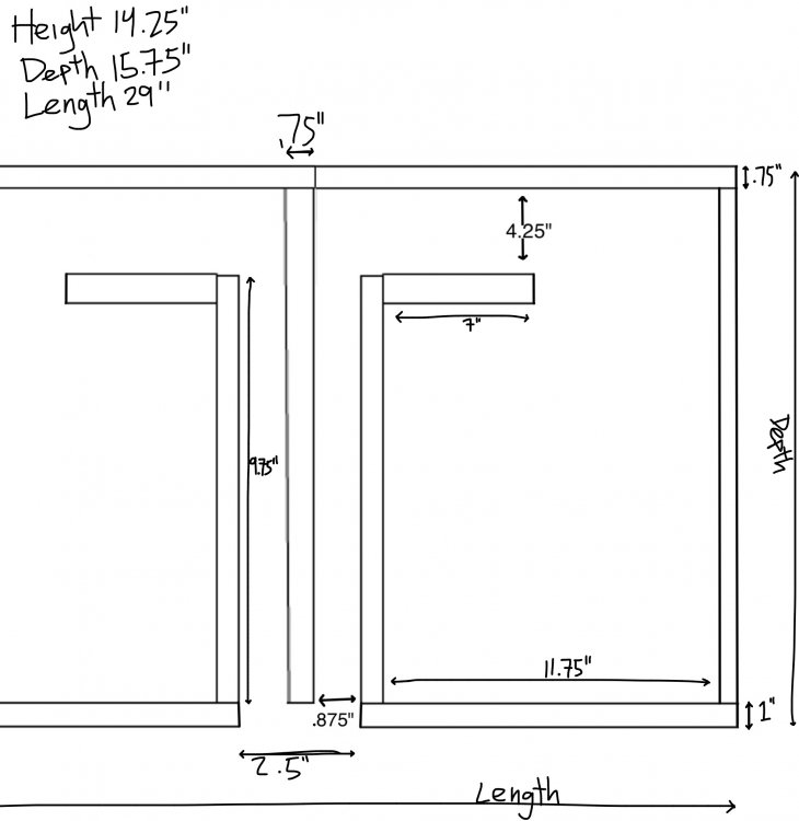

bolanorthhighlands Posted April 17, 2017 Author Report Posted April 17, 2017 I guess it would depend on the subwoofer displacement(I'm still not sure on my subs displacement). The whole box is made out of .75" mdf. only the front baffle is 1" thick. It's for two 12s. What I'm trying to ask is, what is my prefab box tuned to?(this is the box I'm using now) My 2002 Kia Spectra LS My YouTube Channel
Triticum Agricolam Posted April 17, 2017 Report Posted April 17, 2017 So the ports on that box and 7/8" wide where they exit the front, but are 4.25" wide after they turn the corner at the back of the box? Am I interpreting your drawing correctly? "Nothing prevents people from knowing the truth more than the belief they already know it.""Making bass is easy, making music is the hard part."Builds:
bolanorthhighlands Posted April 17, 2017 Author Report Posted April 17, 2017 Yes that is right. It's a prefab box I'm using. I bought it like that. My 2002 Kia Spectra LS My YouTube Channel

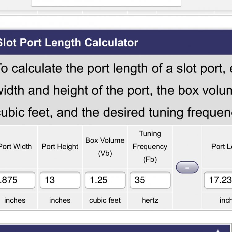

Triticum Agricolam Posted April 17, 2017 Report Posted April 17, 2017 45 minutes ago, bolanorthhighlands said: Yes that is right. It's a prefab box I'm using. I bought it like that. OK, wow. The amount of fail in prefab boxes never ceases to amaze me. So based on those numbers and assuming .1 cu ft for sub displacement that box should have about 1.2 cu ft net volume per side, tuned to around 42 Hz, with a pathetic amount of port area (just over 11 sq in). "Nothing prevents people from knowing the truth more than the belief they already know it.""Making bass is easy, making music is the hard part."Builds:
bolanorthhighlands Posted April 17, 2017 Author Report Posted April 17, 2017 Damn. I knew 35hz didn't sound right. Thanks My 2002 Kia Spectra LS My YouTube Channel
