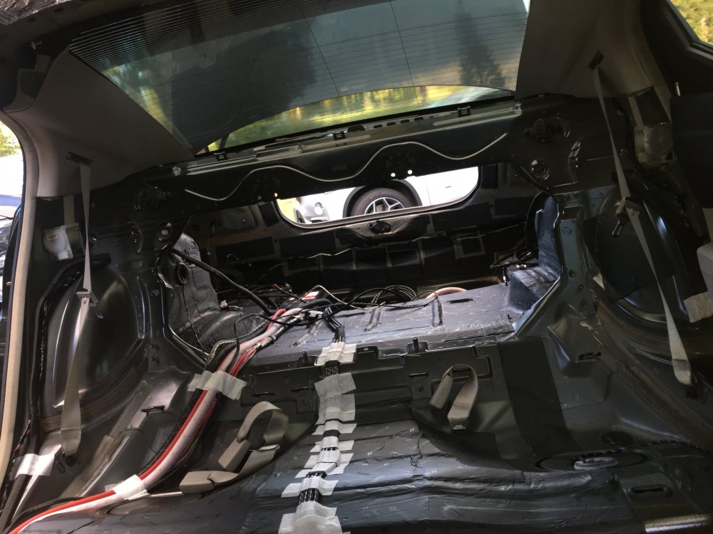

All under carpet wires ran and secured.
Two 4/0 Knukonceptz for alternator front-to-back run, one stock 2 gauge run, stinger matte speaker wires four 12awg two 10awg with three of those speaker wires running down each side of the car (two12awg one10awg on each side), two 14gauge wires for headunit power and ground ran along passenger side, two remote wires 18awg ran down the top of the center then turns to passenger side to enter trunk area with the other power wires, four 17ft stinger 9000 series rca cables ran down center on driver side.

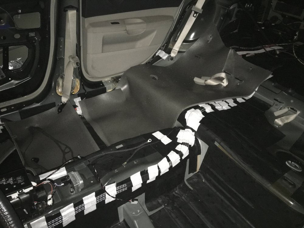

Finally got to start on laying Second Skin Luxury Liner Pro. I hope its fine to lay the soft gray foam side up?????. Noticed most people on youtube seem to have the hard rubber dark side up. This LLP stuff is actually pretty easy to lay out, i just ran out of day light after doing the other things and a couple things in the trunk. Just layed down three sections, the rear seat section is secured with velcro under it. Ill finish it tomorrow. Have to lay some on the sides and fill in the gaps between the big sections and then finish it off by using the foil tape to give it all good seal from road noise.
Had to redo the layout of the LuxPro today so i pulled yesturdays pieces out and i was able to just flip the passenger footwell peice and reinstall it just like that. Then traced out the flipped side of the other peices onto other sheets of LuxPro and put those back in place with the correct side up this time lol. Also added more velcro strips to both rear seat peices and the center humps sidewalls. Here it is. Not taped and secured yet, just layed out.

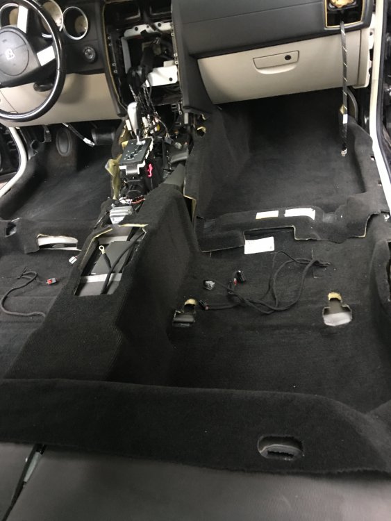

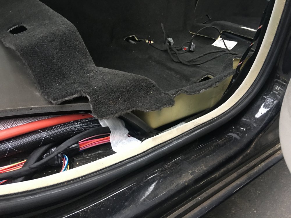

From close up.... it pretty bad. But ill deal with lumpy carpet for the sake of sound quality lol. Just really hoping the seats mount back in ok. We'll find out tomorrow ????

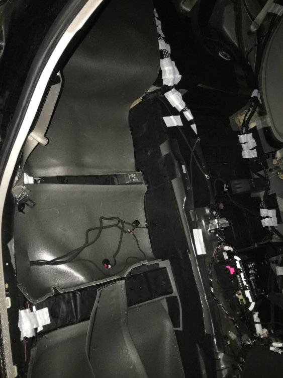

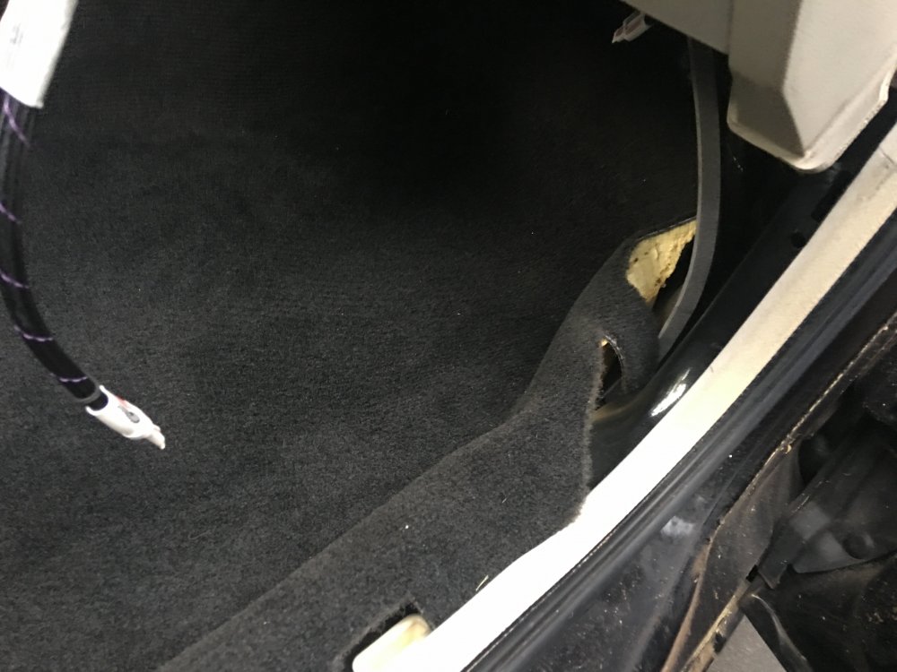

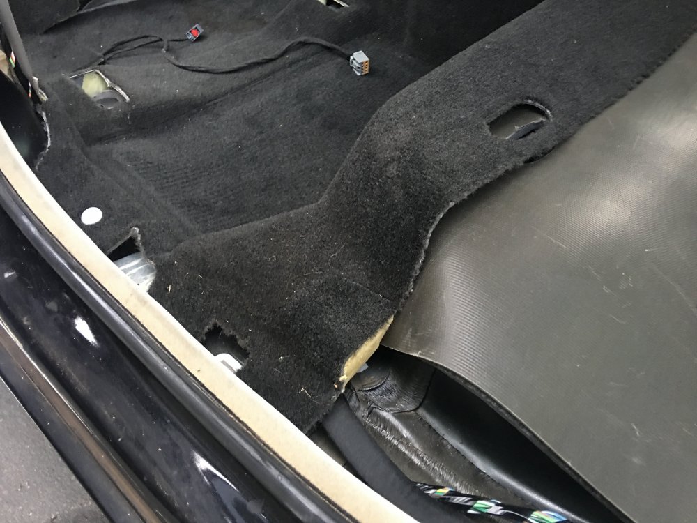

Rear passenger doorjam/outer corner of seat area
Rear Driver side doorjam/outer corner of seat area

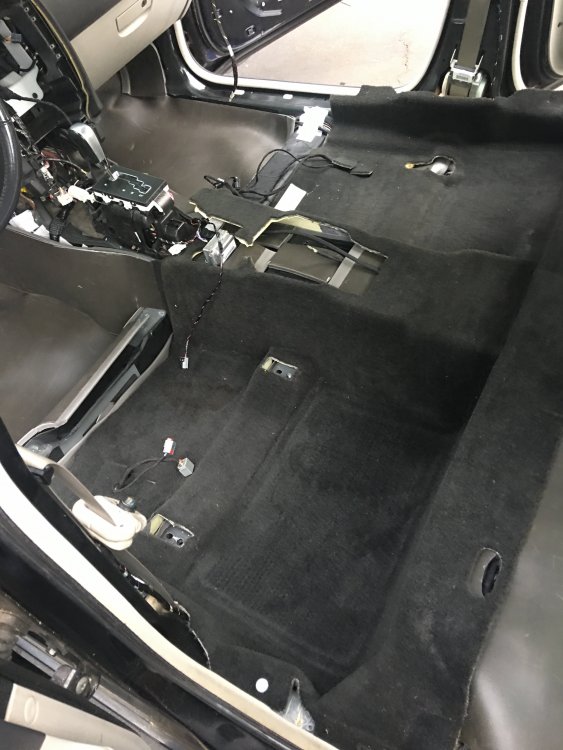

Driver footwell
Passenger footwell

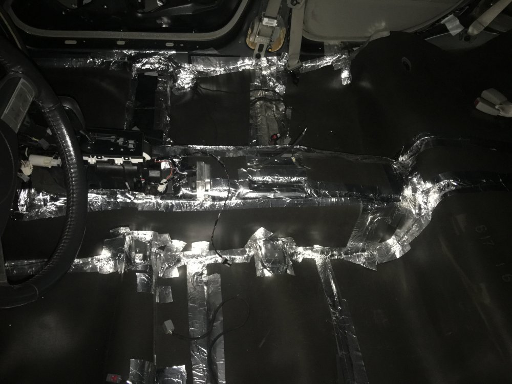

I wish the foil tape that second skin has was more rigid with an adhesive that was a lot stonger. Using it to seal the gaps/joints of the LuxPro was a pretty rediculous, got it done tho.
Maybe the tape isnt made for that? I think i got the idea from watching Caraudiofabrication.

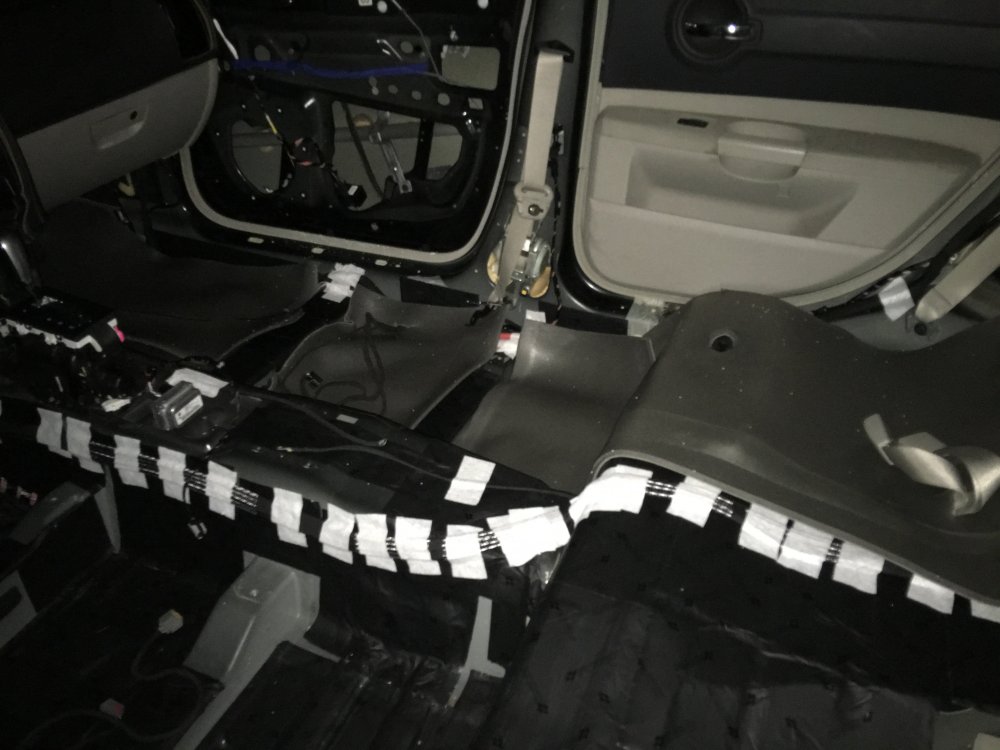

Ended up working into the night, had to pull out the fishing headlamp to finish up the laying, velcroing and foil taping of the Lux Pro. Finished it right at 1am, glad thats over. I can finally put my interior all back in tomorrow.

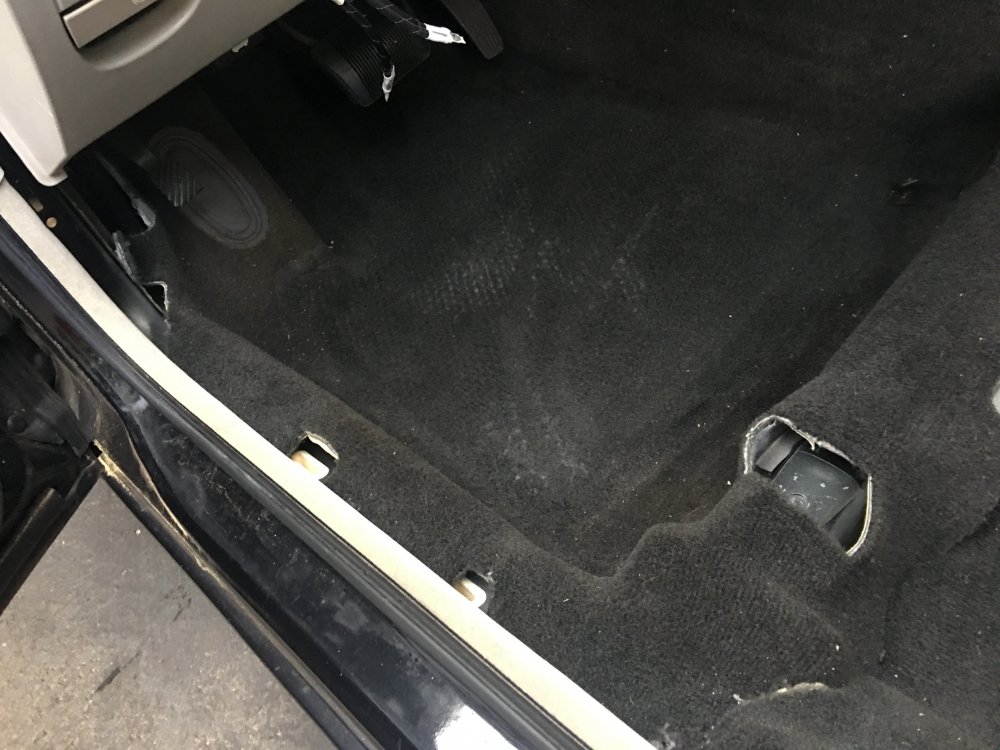

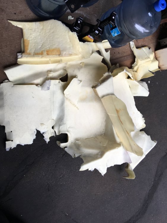

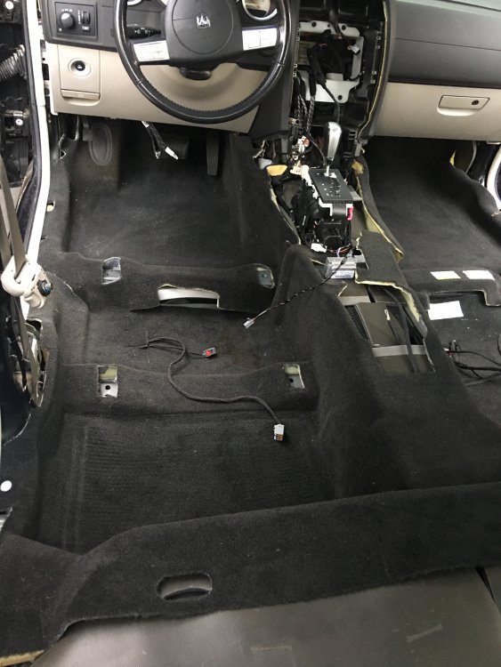

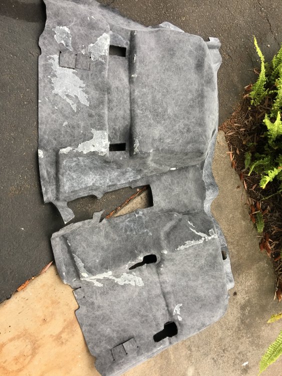

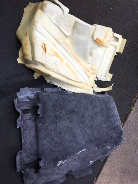

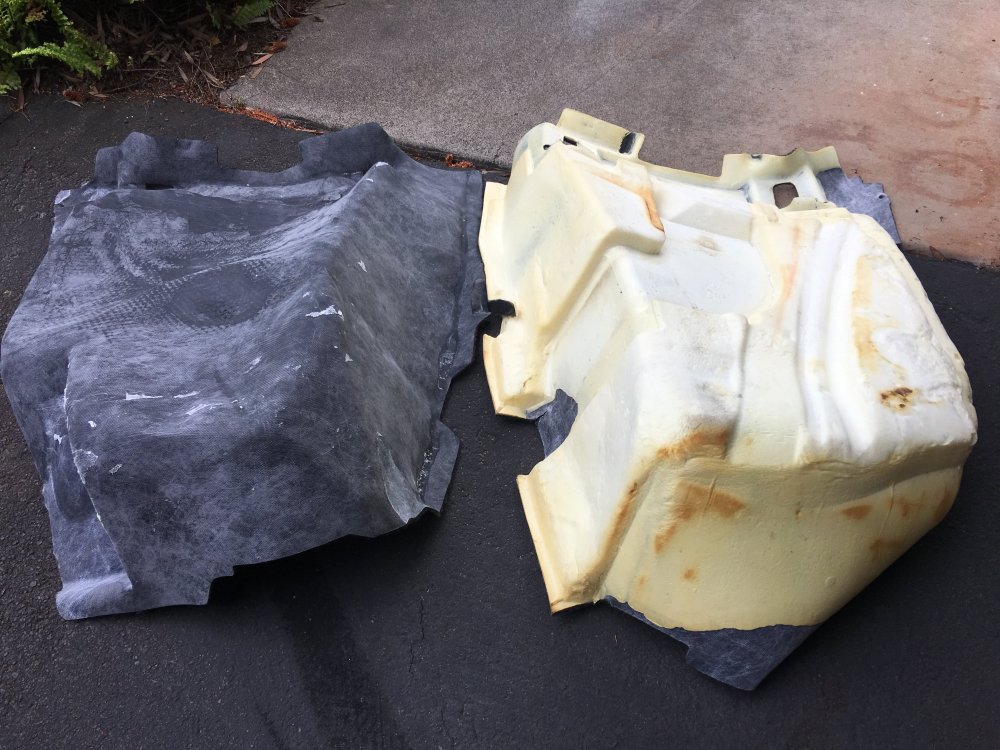

To try to make up for the space that the DampPro and LuxPro is taking up now, i decided to remove the molded foam backing from all the carpet. Its a tedious task but worth it, carpet fits way better.
Heres the driver footwell carpet with foam removed next to the passenger footwell carpet with foam still intact.

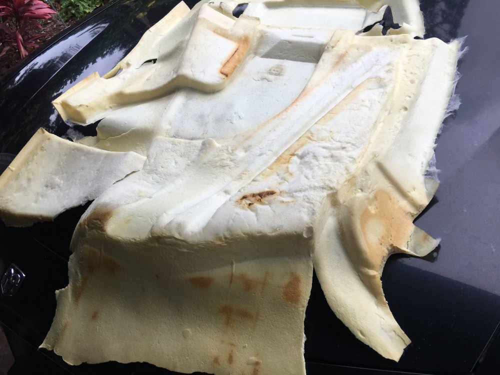

Tried to take the foam off the passenger carpet in one piece to show how much space it takes.
View of the huge foam backing spread over the hood
Then did the same to the rear carpet. The rear passenger outer corner of the seat was the worst section, where the power wires run. But after pulling foam it wasnt as bad, specially after the trim pieces go back in.
