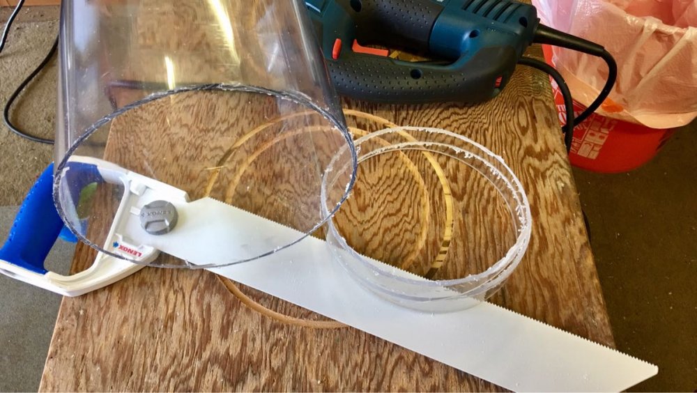

First attempt cutting the tube, failed. Actually first tired to cut it at work on a band saw and almost lost a hand lol that shit bit HARD and slammed the tube and my hand. Scared the shit outta me. But went and got a handsaw that said it was made to cut plastic, fail

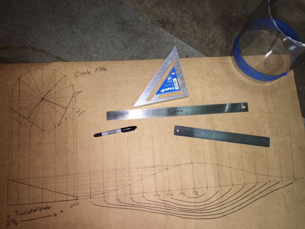

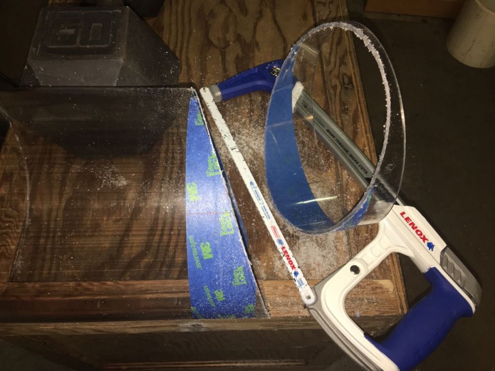

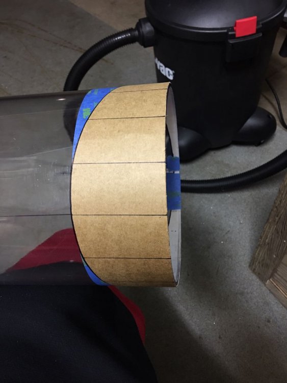

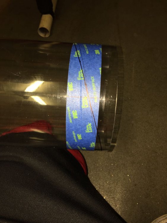

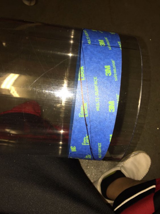

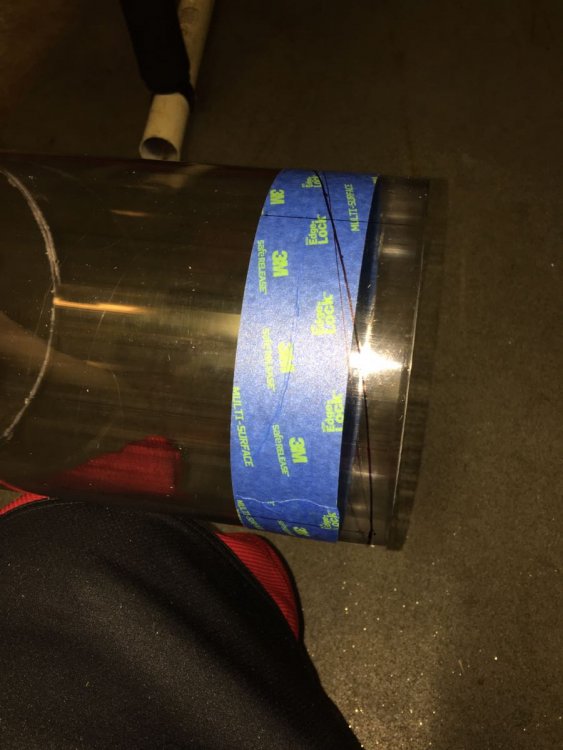

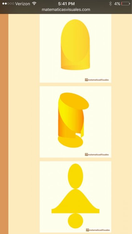

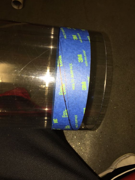

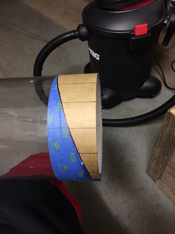

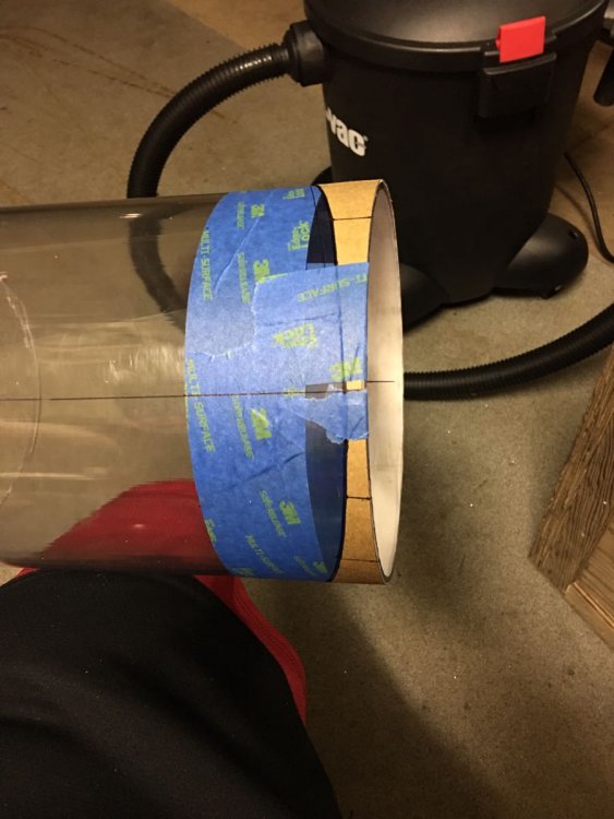

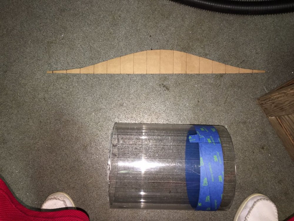

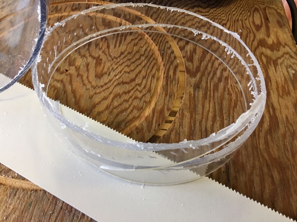

So that saw didnt work, asked the forum for help and they suggested a hack saw with fine teeth (high tpi). Went to lowes and got one. Used a straight edge to draw a my cut line figuring that just a straight line would work...NOPE. Lol apparently a tube cut at an angle doesnt creat a straight line when layed out flat(pic at end), i think its called an ellipse? Idk. So before i cut i got down into some geometry and worked it out, thats the first pic, showing the graph i used to get my ellipse shape for my "truncated cylinder" (science name for a angle cut tube lol). Taped that shaped to the tube and drew my cut line, you can see the thin line thats my first cutline using a straight edge of thin cardboard. See how the thicker cutline of the ellpise curves more. Worked out perfect, and the hacksaw with a 32tpi blade worked great too.

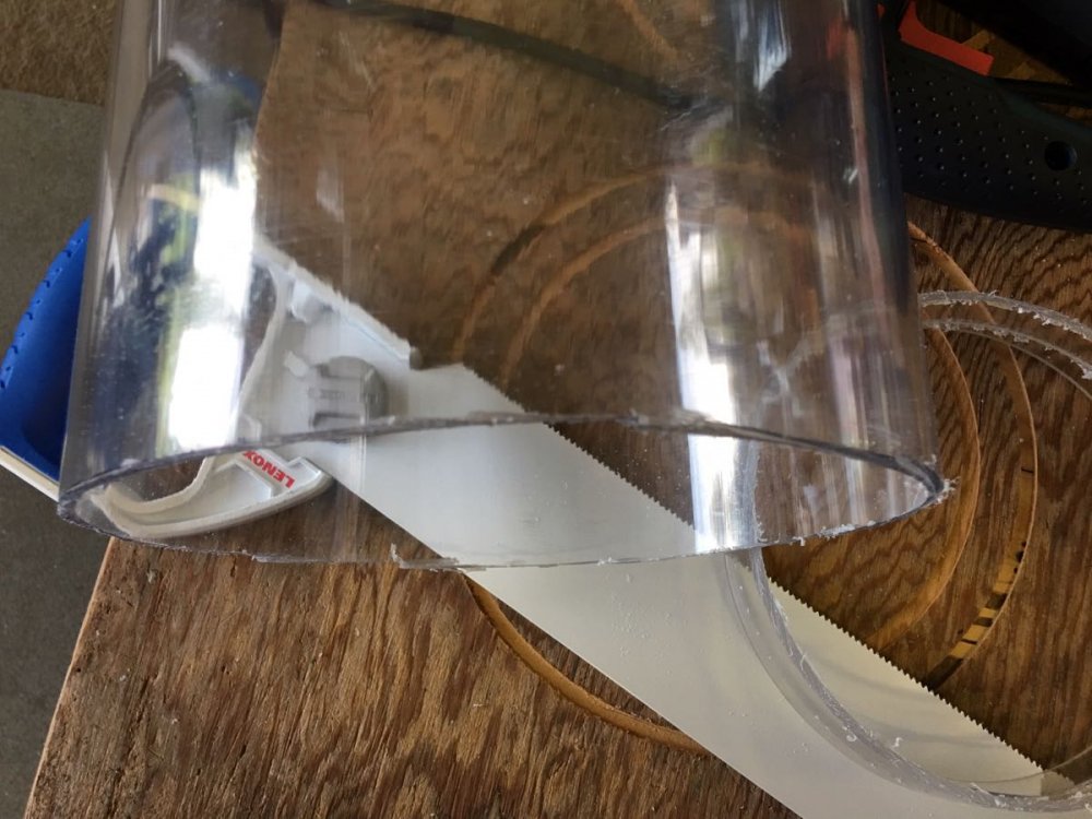

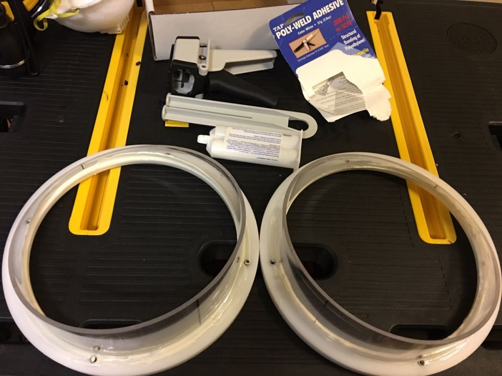

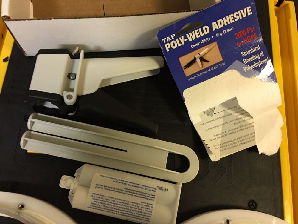

Since HDPE plastic is very difficult to bond, i did some searching and found Tap Plastics site. They make a polyweld adhesive that is made for hdpe bonding. It requires heat treating the areas that will be bonded together with the yellow flame section of a torch. Very simple. Just wave it over the area a few times with the low heat flame and to be sure its treated just put a lil water on the area and if it DOESNT bead up then its good. If the water tries to bead up then keep running the flame over it a few more times. After that just apply the adhesive and DO NOT clamp together. The adhesive is most strong when there is a very small gap, the size of the thickness of a sheet of copy paper. You can actually use a couple strips of copy paper and lay it across sections of the adhesive and then press down firmly and ur good. Curing time is 24-48 hours. Also whats good is the work time is very generous so u dont have to worry about rushing before it hardens.

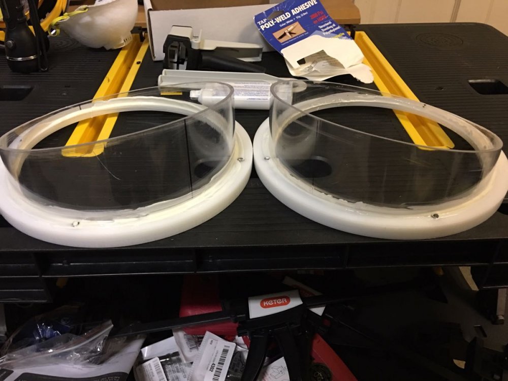

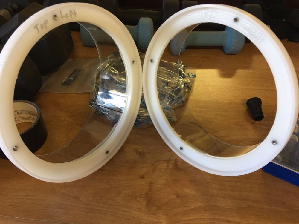

Successful bond of HDPE to Polycarbonate. Im glad the adhesive required some gap because the tubes edges werent completly straight. I did alot of sanding down to get it as straight and flush as i could but it still wasnt perfect. But i figured this adhesive would still work well and it has.

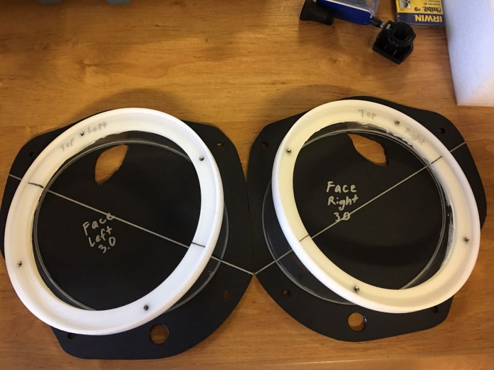

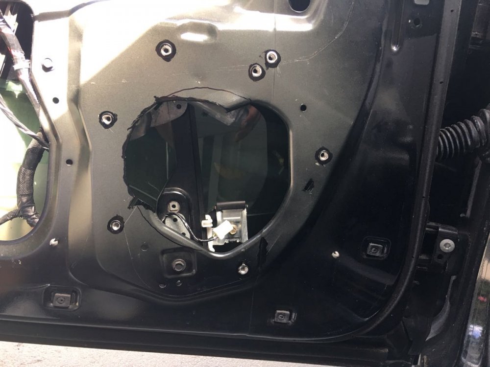

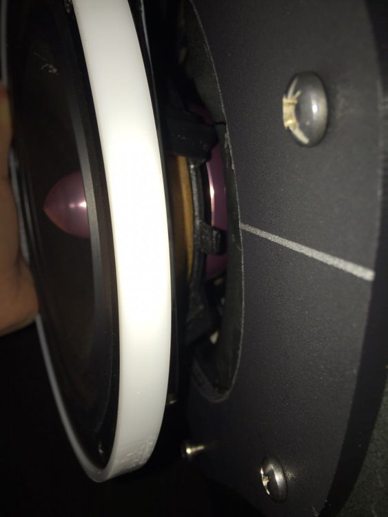

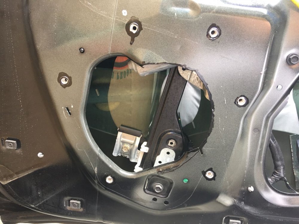

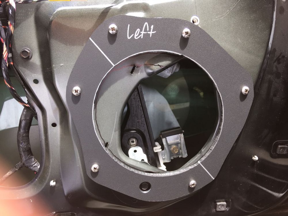

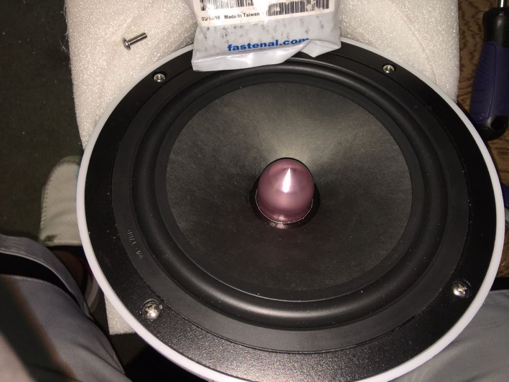

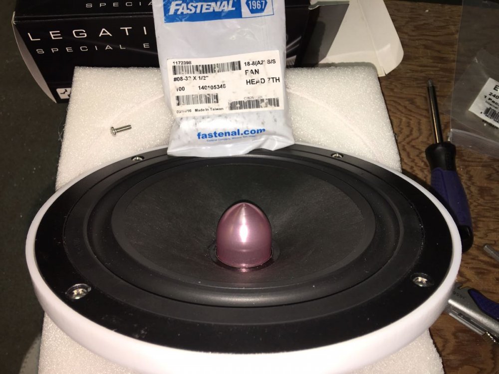

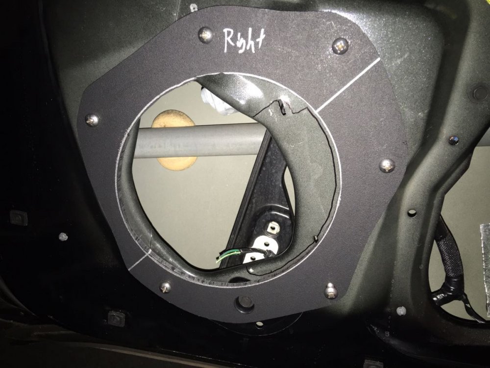

Drew a cutline on the plates using the tube and cut it out with a dremel, which worked ok. Didnt wanna get the router out. Mounted the plates on the door. Mounted the speaker onto the ring/tube and test fited it onto my door using the guide lines i drew by just lining up the black lines on the ring/tube with the gray lines on the plate. Last pic shows the speaker basket hitting the sheet metal. The magnet had lots of room so depth wasnt an issue. So i drew a cutline with the plates mounted.
Used my dremel again with a cut off wheel for metal. Tried the "thin metal" blade first and it broke. The regular one worked perfect, but i wore the first one out and used another. Test fit the speakers again and it fit perfect. So i sanded the cut edges on the doors and cleaned of any dust then used some touchup paint and coated the edges. Also coated around the rivnut holes.
