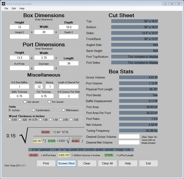

Triticum Agricolam Posted June 16, 2017 Report Posted June 16, 2017 1 hour ago, TheGobot said: Im in a chevy cavalier 2 door so to say trunk soace is limited is an understatment, thats kinda the reason i was hoping to build an aeroport box to help keep the size down. My max dimentions are 15" hight x 30" x 23" and thats with me possibly barely being able to fit and possibly bottoming out my shocks in the back You have enough space, here is my suggestion: "Nothing prevents people from knowing the truth more than the belief they already know it.""Making bass is easy, making music is the hard part."Builds:
TheGobot Posted June 16, 2017 Author Report Posted June 16, 2017 Thanks for the suggestion, i think ill try it out.
