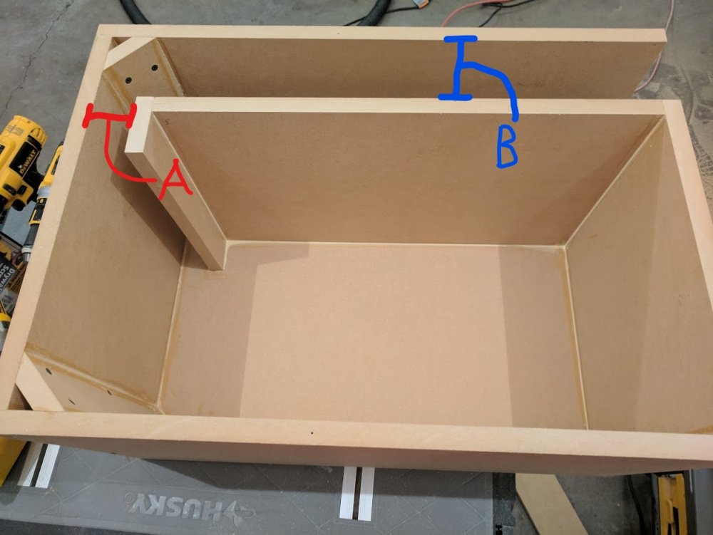

Triticum Agricolam Posted September 13, 2017 Report Posted September 13, 2017 1 hour ago, dgreenie29 said: I will do that tonight. Please see the link for pictures System Pictures It looks like you did a nice job with the install and box build, but I see one potential issue. It looks like dimension A is less than dimension B: It just might be the angle of the photo, but it looks like maybe you should have attached the short port piece flush with the long one, instead of overlapping. "Nothing prevents people from knowing the truth more than the belief they already know it.""Making bass is easy, making music is the hard part."Builds:

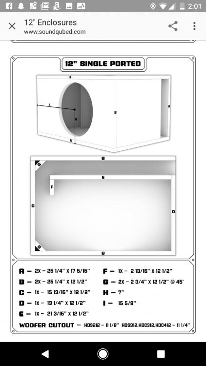

dgreenie29 Posted September 13, 2017 Author Report Posted September 13, 2017 I noticed that as well but I believe that's what the directions on there website said to build it at.
dgreenie29 Posted September 13, 2017 Author Report Posted September 13, 2017 Shit... You are probably right.. would that cause that much output loss?
dgreenie29 Posted September 13, 2017 Author Report Posted September 13, 2017 And my port looks to be over 3" wide and it's supposed to be around 2 9/16 wide I believe.
Triticum Agricolam Posted September 13, 2017 Report Posted September 13, 2017 19 minutes ago, dgreenie29 said: And my port looks to be over 3" wide and it's supposed to be around 2 9/16 wide I believe. Having the port wider than intended will raise the tuning frequency. It will get you more output in the 40 Hz region but you will have less below there. The short panel being in the wrong spot is going to cause a choke point in the port, which will decrease output, how much I can't say. It's obviously not a good thing though. When you can report back with what the output voltage is of your amp that will give us a better idea what's going on. "Nothing prevents people from knowing the truth more than the belief they already know it.""Making bass is easy, making music is the hard part."Builds:

ShadeTreeMechanic Posted September 13, 2017 Report Posted September 13, 2017 Make plans for a second sub. My OCD won't let me run a single sub. Has to be an even number. lol The majority of the output at tuning will come from the port and having it choked could be a difference of a few db. Get the port right and it can double your output. Good eye Triticum! 91 C350 Centurion conversion ( Four Door One Ton Bronco) 250A Alternator (Second Alternator Coming Soon) G65 AGM Up Front / Two G31 AGM in Back Pioneer 80PRS CT Sounds AT125.2 / CT Sounds 6.5 Strato Pro component Front Stage CT Sounds AT125.2 / Lanzar Pro 8" coax w/compression horn tweeter Rear Fill FSD 5000D 1/2 ohm (SoundQubed 7k Coming Soon) Two HDS315 Four Qubes Each 34hz (Two HDC3.118 and New Box Coming Soon)
