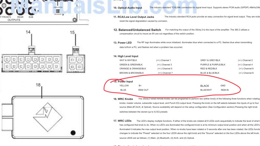

aygobasshead Posted October 30, 2017 Report Posted October 30, 2017 Hi guys, I freshly installed my 3sixty.3, everything works, all wiring is correct no bad grounds whatsoever Remote out and in delay is set to 4 seconds, and still when I switch off, I hear a loud pop sound. What could this be? Please assist! Thanks!

aygobasshead Posted November 1, 2017 Author Report Posted November 1, 2017 My possible solution was: Currently I have it wired to ignition on via radio yellow (switched plus), which means that if ignition is switched off all power immediately is drawn from the DSP generating the pop. Theoretically, if I wire it to the battery the turn-off delay can do it's work and I shouldn't hear a pop noise anymore as the DSP delay time can do it's work due to power not immediately being drawn because ignition is switched off. Could this be it?

aygobasshead Posted November 1, 2017 Author Report Posted November 1, 2017 Just now, WalledSonic said: Wait, wire your ignition-on straight to the battery? What signals the unit to turn off then? Nooooo, wire the DSP straight to the battery with a fuse in between. The remote in wire should make the DSP turn on and off with the HU and because it's now wired to constant power it'll be able to effectively make use of the turn-off delay, because power isn't instantly drawn as soon as the ignition is off. You understand?
06RTCharger Posted November 2, 2017 Report Posted November 2, 2017 When refering to the vehicle stock wiring I think red is “ignition switched power”? Thats where ur headunits remote-in should be wired to.Then ur headunit remote-out(usually white wire on ur headunit) to ur 360.3 remote-in (bluewhite wire on ur 360.3 powerharness). Yellow is constant power, yellow is usually straight to the battery. That would apply also to ur 360.3 power harness, the yellow coming from ur 360.3 should be wired to ur battery/battery distro block. The black is ground, blue is remote out for ur amps. Thats how i see it anyway, hope it helps some. Goodluck
aygobasshead Posted November 8, 2017 Author Report Posted November 8, 2017 I fixed it already, it was as I predicted. By wiring it to the battery instead of the radio I managed to get the turn-off delay to work and the pop sound is gone.
