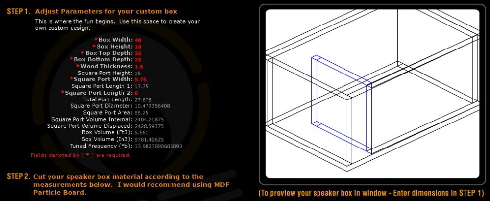

Hey everyone. I recently acquired 2 Digital Designs 9512's along with 2 MMatts Audio D3000.1 amps. I'm looking to build a box for my yukon. I'm looking to be tuned around 33-34 hz. and about 5cubes after displacement. DD's site says each sub is .28 cu ft. so .56 cu ft total. My question is does this look right. After displacement will i still be tuned around 34hz?

Well that was one of my questions. Is doubled 3/4" mdf overkill? Should i just do a double baffle? I have heard that these subs like smaller enclosures with a larger port area. That true?
I would definitely double baffle but if you do a little internal bracing no need to double the whole thing.
