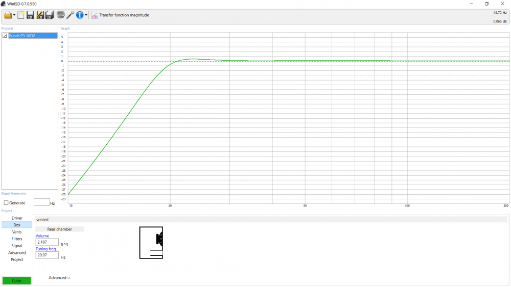

If you did decide you wanted to stick with your p3 10" (not recommending you do but whatever floats your boat) i just wanted to show you why and how you can play below 28 hz (which what, btw, are you doing below 28 anyway. I mean Jeezy hypnotize is 32hz) with these WinISD charts.
Here is a box model designed by WinISD specifically to give your P310 a flat frequency response.  It requires roughly a 2cu. ft. box tuned to roughly 21hz:
^As you can see below 28hz is not a problem.  The problem you will have here is playing the sub at its full rated power levels.  While this box gives you a nice flat response, it is also fairly large to accomplish this and you risk bottoming out if you play it too hard.  You are probably safe up to about 75% RMS.
OR... don't worry about a completely flat response and spare yourself from building a box to those specifications (unless that's your thing) and do it my way.

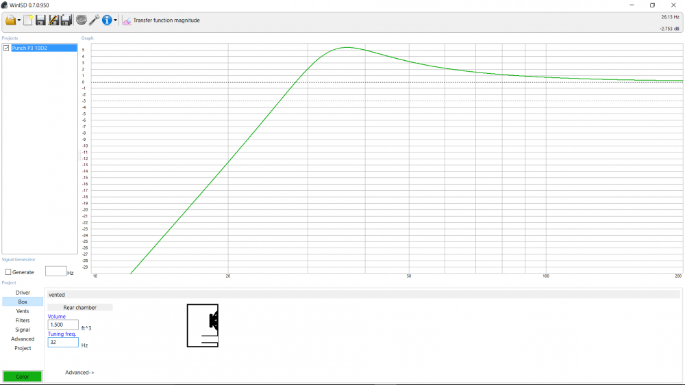

If I were going to buy that sub right there very moment, I would buy this Atrend box which is 1.5 cu. ft. tuned to 32hz.
^As you can see this sub/box combo would give you a nice slow rise from 100hz down to the mid 30s where you would peak at plus 5 or 6 decibels before you start to slowly roll off toward your f3 all the way down a 26hz.  You may think "but I don't want to roll off..." but with cabin gain it is still going to be plenty loud so don't even worry about it.  If this is not some meticulously intricate SQ system you won't even notice the difference.  And the nice thing about using this box size, you can play at your subs full rms rated power right down to 26hz without having to listen to sonic tell you no.
Hope these examples help, and if I have somehow missed the point then let me know and we can back track.
