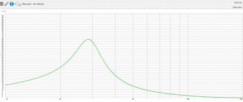

Hey guys,
I was about to re-purpose this 1.75cu 31hz slot port box (built for JL W3) for my DC XL12.  Despite the differences in these two drivers, recommended box size and tuning are very similar.  But WinISD is showing me nasty high port velocity at tuning.  This model is showing air velocity close to 50m/s at 2200rms, and doesn't drop below 30m/s until 800rms or less.
Am I missing something or do I need to get to building a new enclosure to avoid stupid amounts of port noise? Relatively new to WinISD.
Oh, and port dimensions are as follows:
Yeah, you really need to build a new box, 2200 watts into a 1.75 cu ft enclosure is a lot.  Its going to take a lot of port area.  I try to keep port velocity under 22 m/sec if it can, its not always possible, especially with high power density situations like what you have.  30 m/sec is my absolute upper limit, above that and you start losing a lot of output to port compression.  Since you already have things plugged into WinISD you should be able to figure out how much port area you will need to bring your port velocity down.  Just to get port velocity down to 30 m/sec you are probably going to end up with a very large and very long port.  Its going to need to be at least twice as big as what you have now.

Thanks.  I was hoping someone was going to pop up and tell me port velocity is a myth lol.
Yes, it is looking like I'm going to need a significantly wider port, which is also going to be considerably longer to keep tuning to 31.  Current box is 1.75net 2.35gross.  New box will probably have to be over 3cubes gross to keep my same 1.75net  with all of that porting.
In the meantime, I suppose I'll just play around with this box and see just how bad it huffs air while I plan out a new one.
