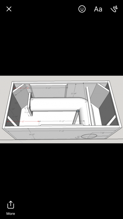

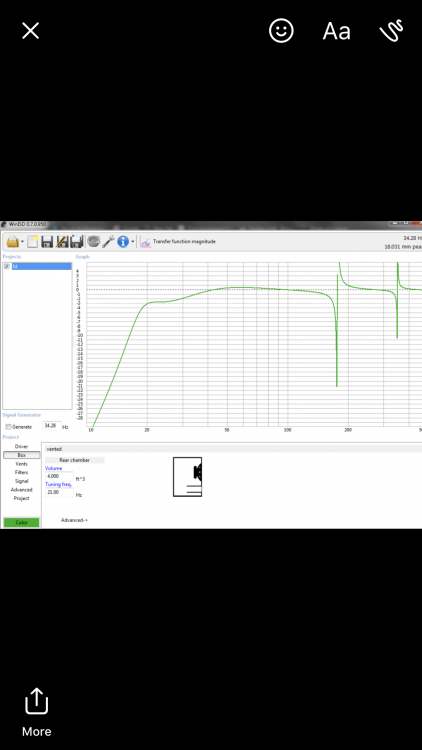

camshairtricks Posted December 12, 2017 Report Posted December 12, 2017 What ya think ? Net volume will be 4.16 the port is a 6 inch step flared 38inches long . We’re is the box pros at ?

WalledSonic Posted December 12, 2017 Report Posted December 12, 2017 17 minutes ago, camshairtricks said: Whats your port velocity like? Chevy Sonic Wall (4) 15's on 10k Build Log https://www.stevemeadedesigns.com/board/topic/209412-2015-chevy-sonicwall4-15s10klithiumlarge-case-hairpin-us-alts/ (4) Fi SP4 15's | (2) Ampere 5Ks | Active! | Arc KS600.2 & KS125.2mini | CDT Silk Domes | Silver Flute 8s | 240Ah JY | US Alts Jeep Wrangler JK (4) 8's in a 4th Order Build Log https://www.stevemeadedesigns.com/board/topic/209841-shadow-2016-jeep-wrangler-jk4th-order4-8sdc-35klarge-case-hairpin-us-alts/ IG @walledsonic

WalledSonic Posted December 12, 2017 Report Posted December 12, 2017 18 minutes ago, camshairtricks said: I want loudest as possible around 20hz even if the driver don’t like it lol and port velocity should be pretty low around 20hz with a 6 inch port I don’t intend to play higher notes You have WinISD open, I figured you could just switch the screen to "port velocity" Chevy Sonic Wall (4) 15's on 10k Build Log https://www.stevemeadedesigns.com/board/topic/209412-2015-chevy-sonicwall4-15s10klithiumlarge-case-hairpin-us-alts/ (4) Fi SP4 15's | (2) Ampere 5Ks | Active! | Arc KS600.2 & KS125.2mini | CDT Silk Domes | Silver Flute 8s | 240Ah JY | US Alts Jeep Wrangler JK (4) 8's in a 4th Order Build Log https://www.stevemeadedesigns.com/board/topic/209841-shadow-2016-jeep-wrangler-jk4th-order4-8sdc-35klarge-case-hairpin-us-alts/ IG @walledsonic
camshairtricks Posted December 12, 2017 Author Report Posted December 12, 2017 This ain’t my design some one made me this sketch I told them I wanted to use a 6 inch aero tuned at 21hz he sent my that graph
