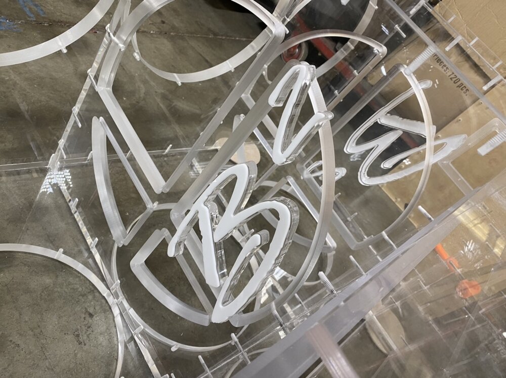

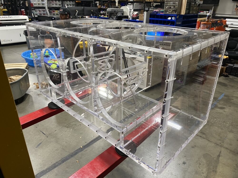

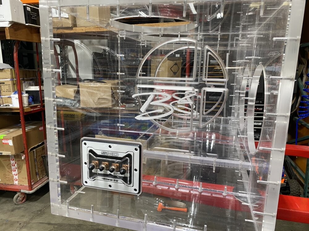

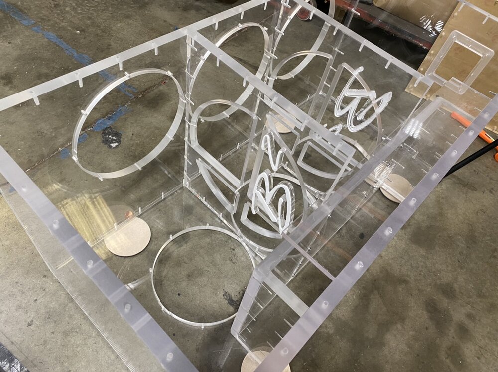

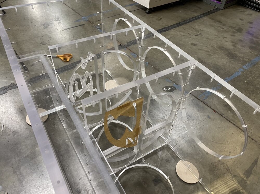

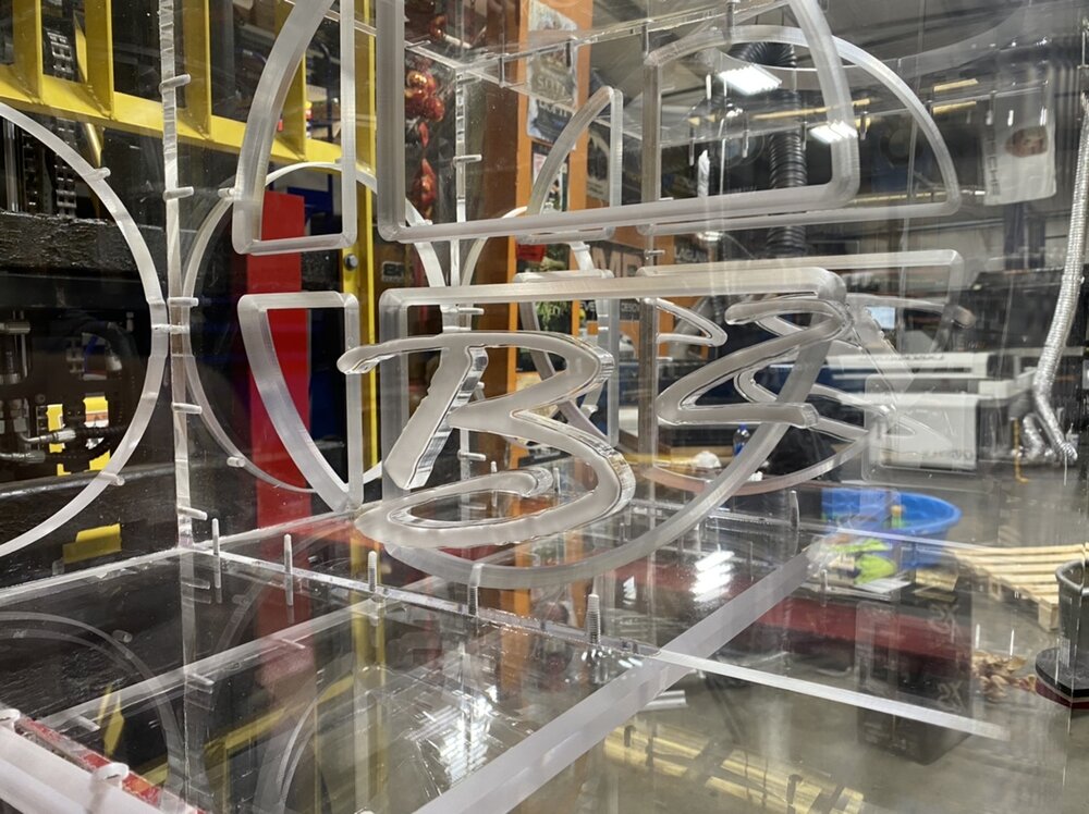

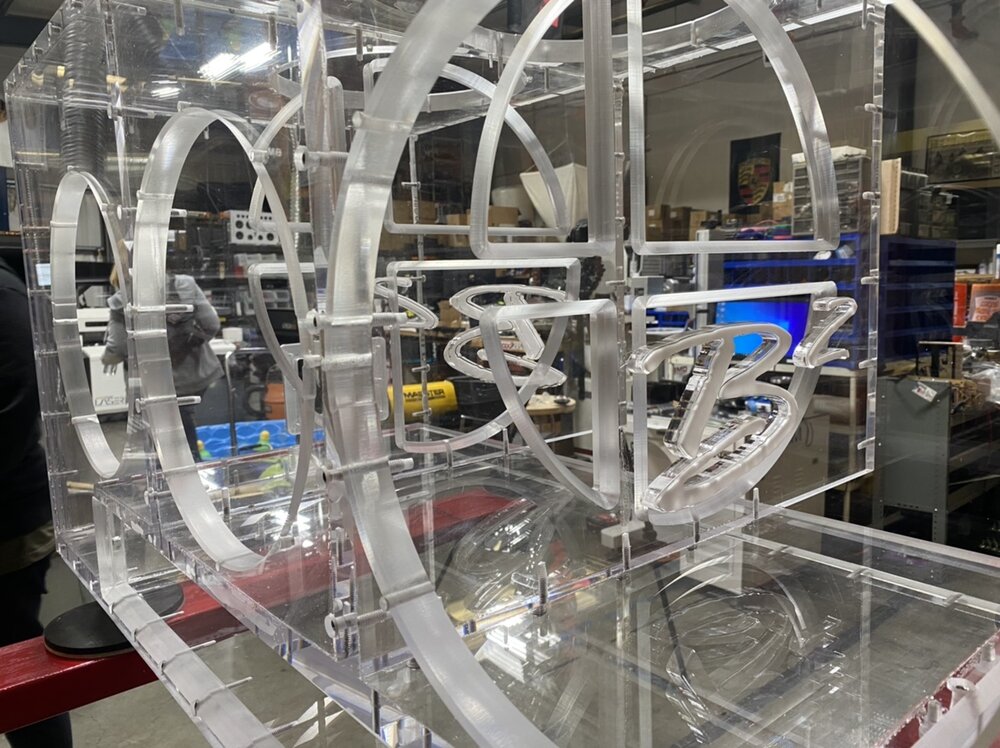

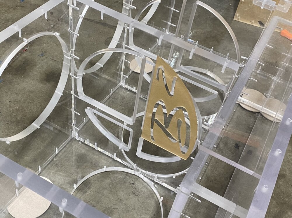

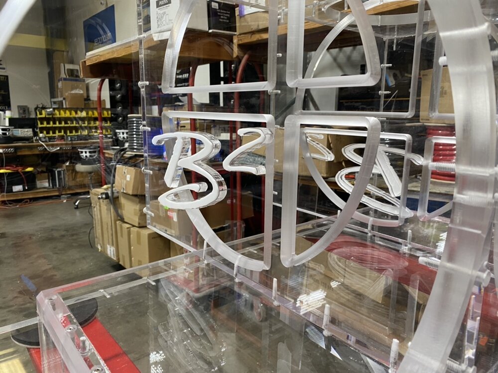

Since the B and the 2 are both two different pieces and it is important to get the placement and angle just right, i cut a slightly oversized reverse template. Something i can put in place that will guide the bigger letters to the correct position. Then the template gets removed.  The B2 logo is also bonded to the bracing with weld-on #3.  You will see what i did MUCH better in the video i am working on.  I hope to have it ready by tomorrow (the video, not the box).  The box itself still has plenty of work to be done before i can fire it up.
