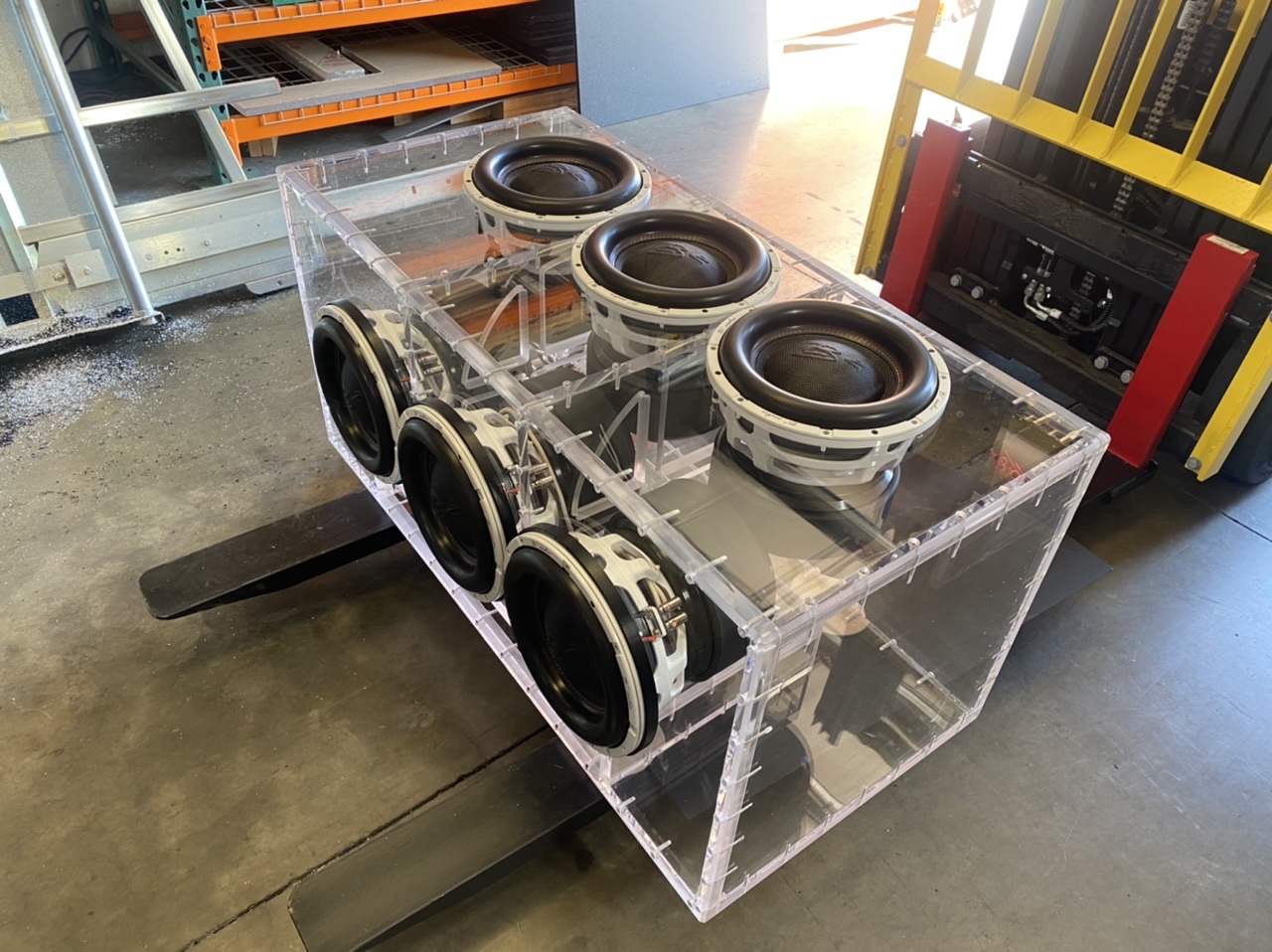

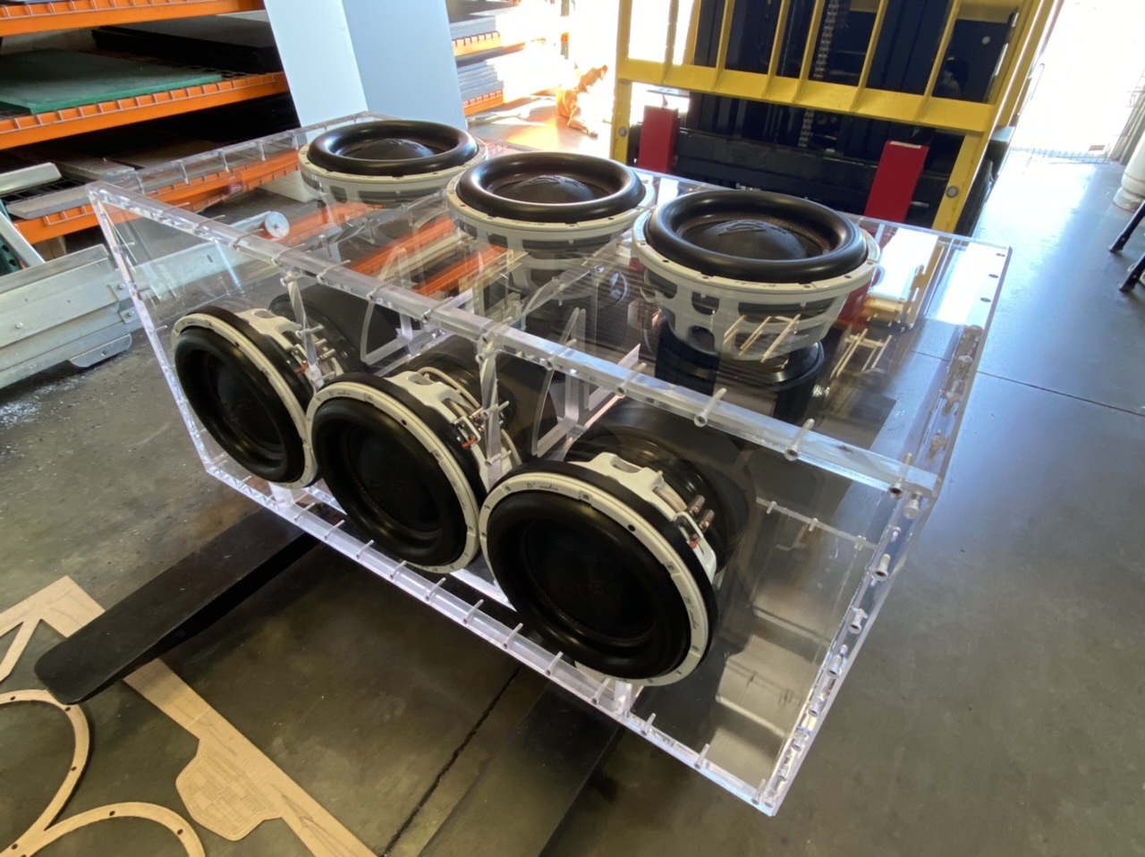

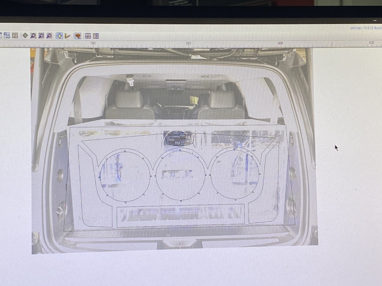

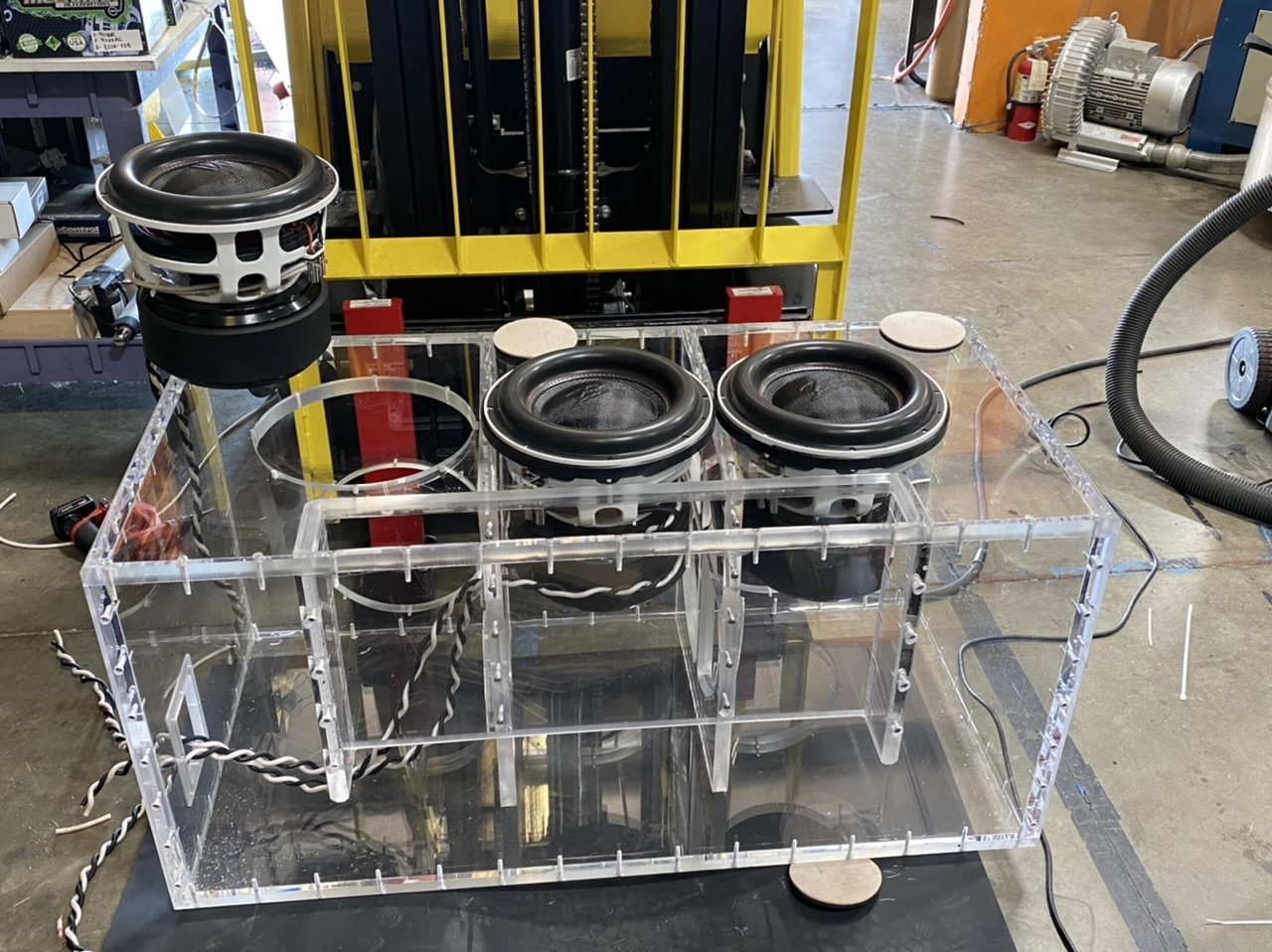

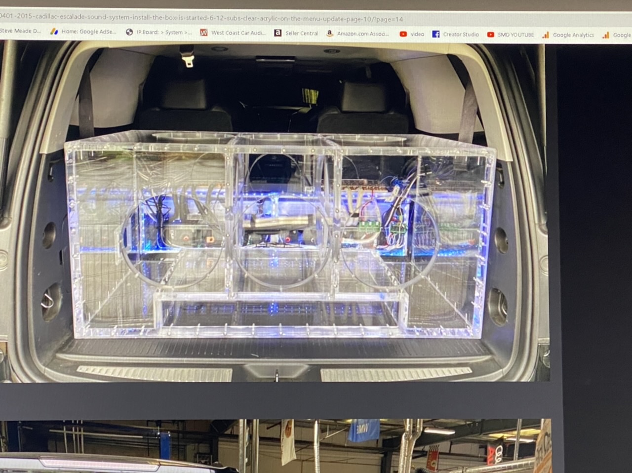

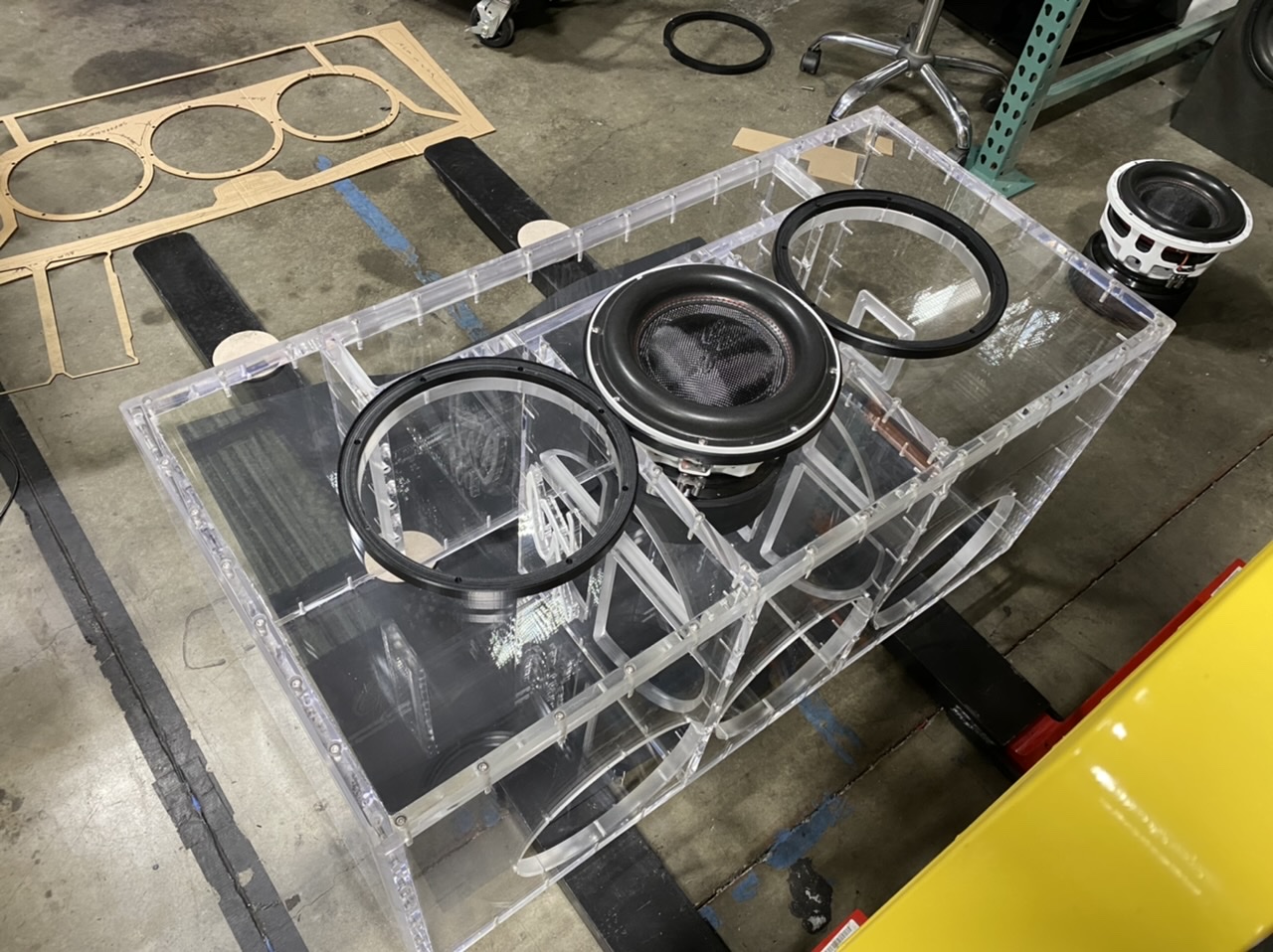

This is what i have to work with.  I LOVE that it is a clear acrylic box.  But i don't want to look at a big square box in my Escalade.  So today i put some time in drawing up some ideas.

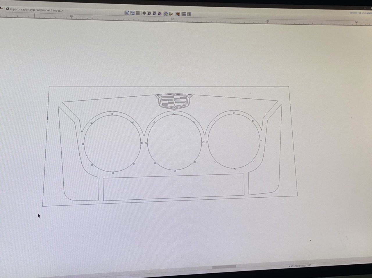

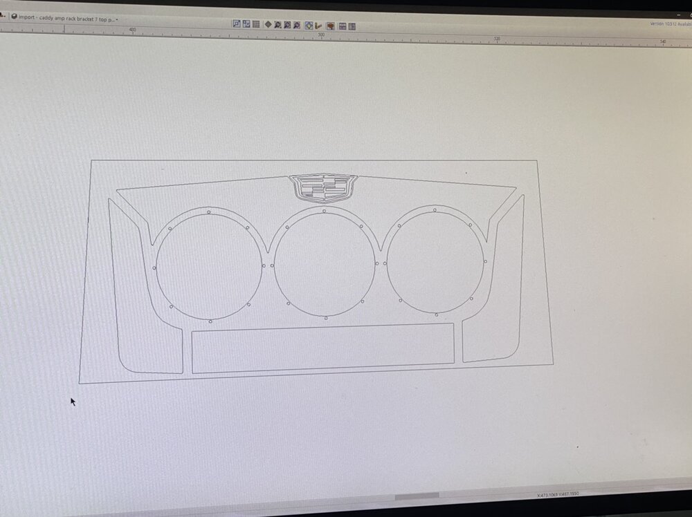

about 3 hours of drawing and this is what i have so far.  I came home to watch the Superbowl but i have this trim piece on my brain!! All i want to do is work on it but i gotta break away and take my time. I don't want to get burnt out.  But i am thinking about it as i type as the game is about to start LOL! :D
Look DEEP into this photo...at my dash.  Just trying to follow the factory lines a little bit.

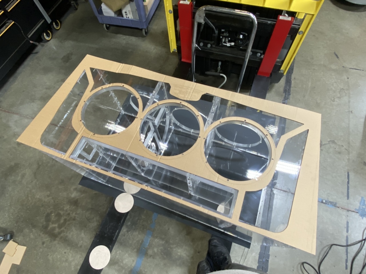

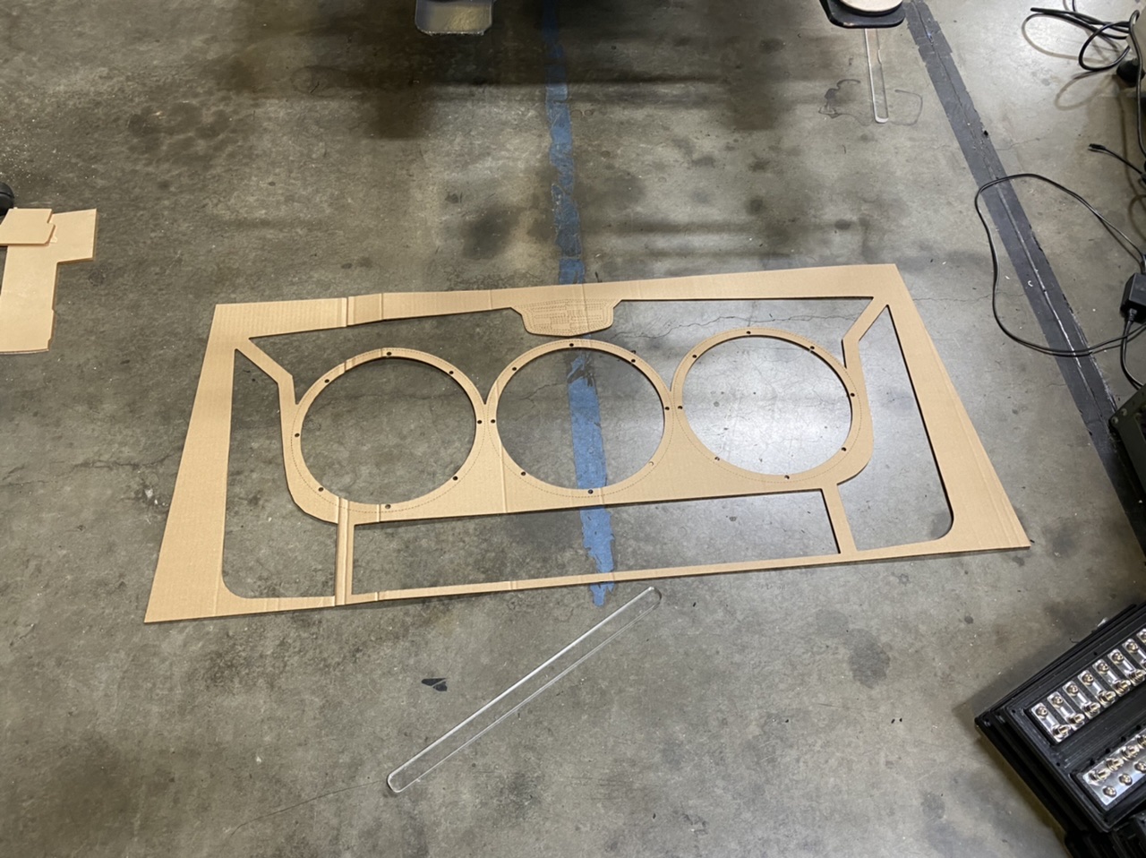

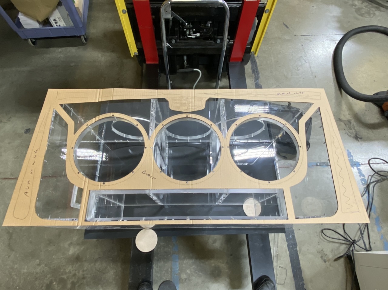

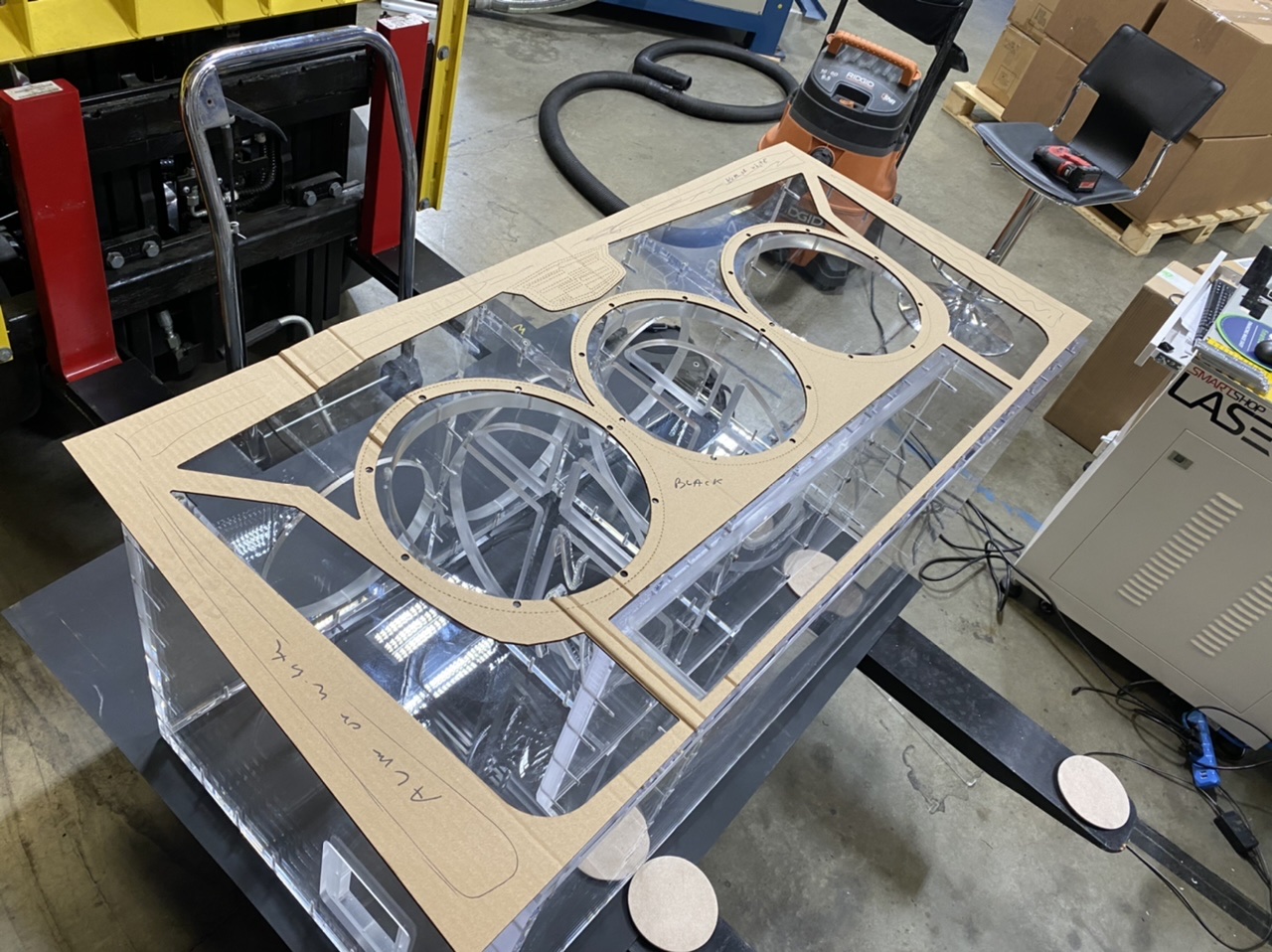

The side "flanges" of this trim totally don't match YET.  I just tossed some random flaps on them so i could draw the inard's.  Once i am happy i will go out to the truck and get some REAL templates and transfer them to the computer and then on to the real trim piece.  It will be nice and flush when done. I hope.

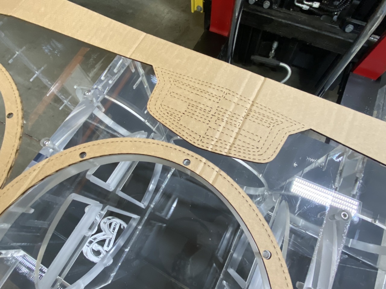

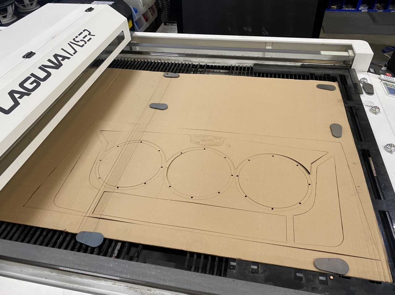

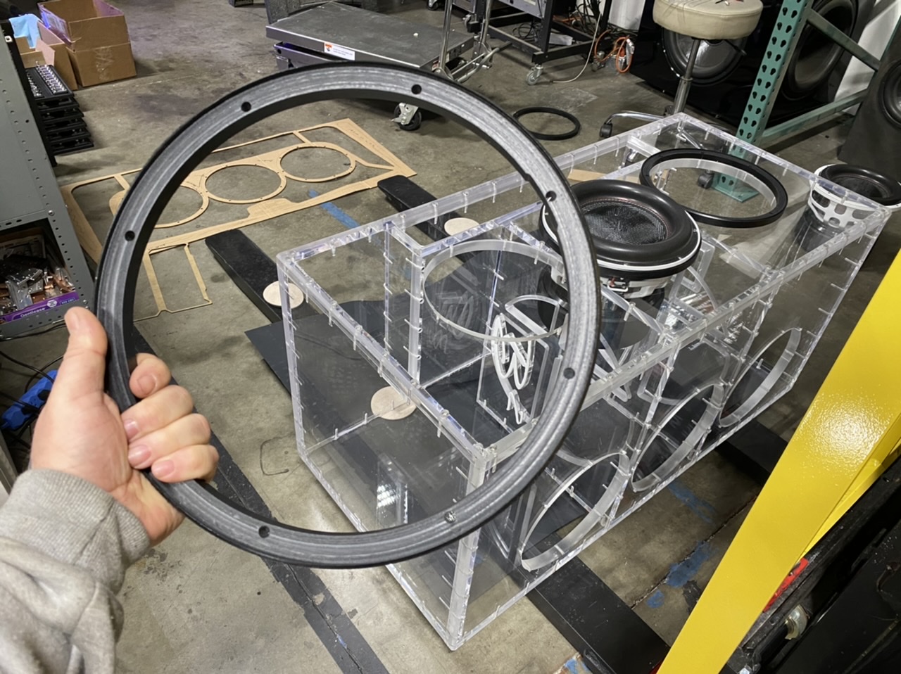

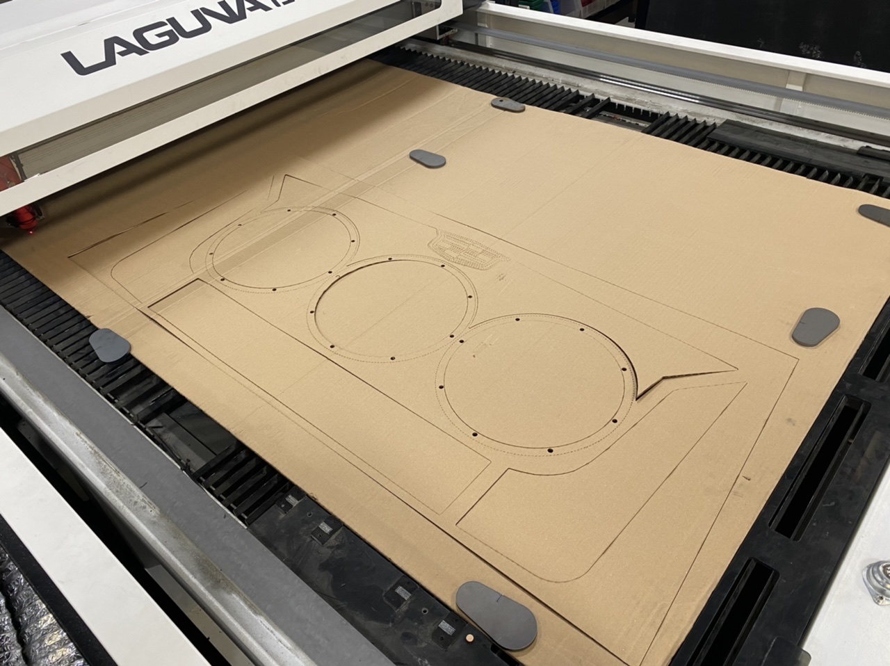

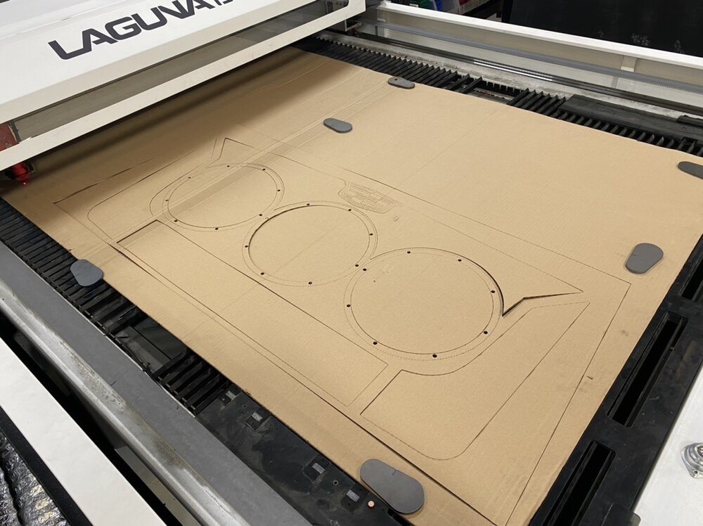

Bust out some cardboard!

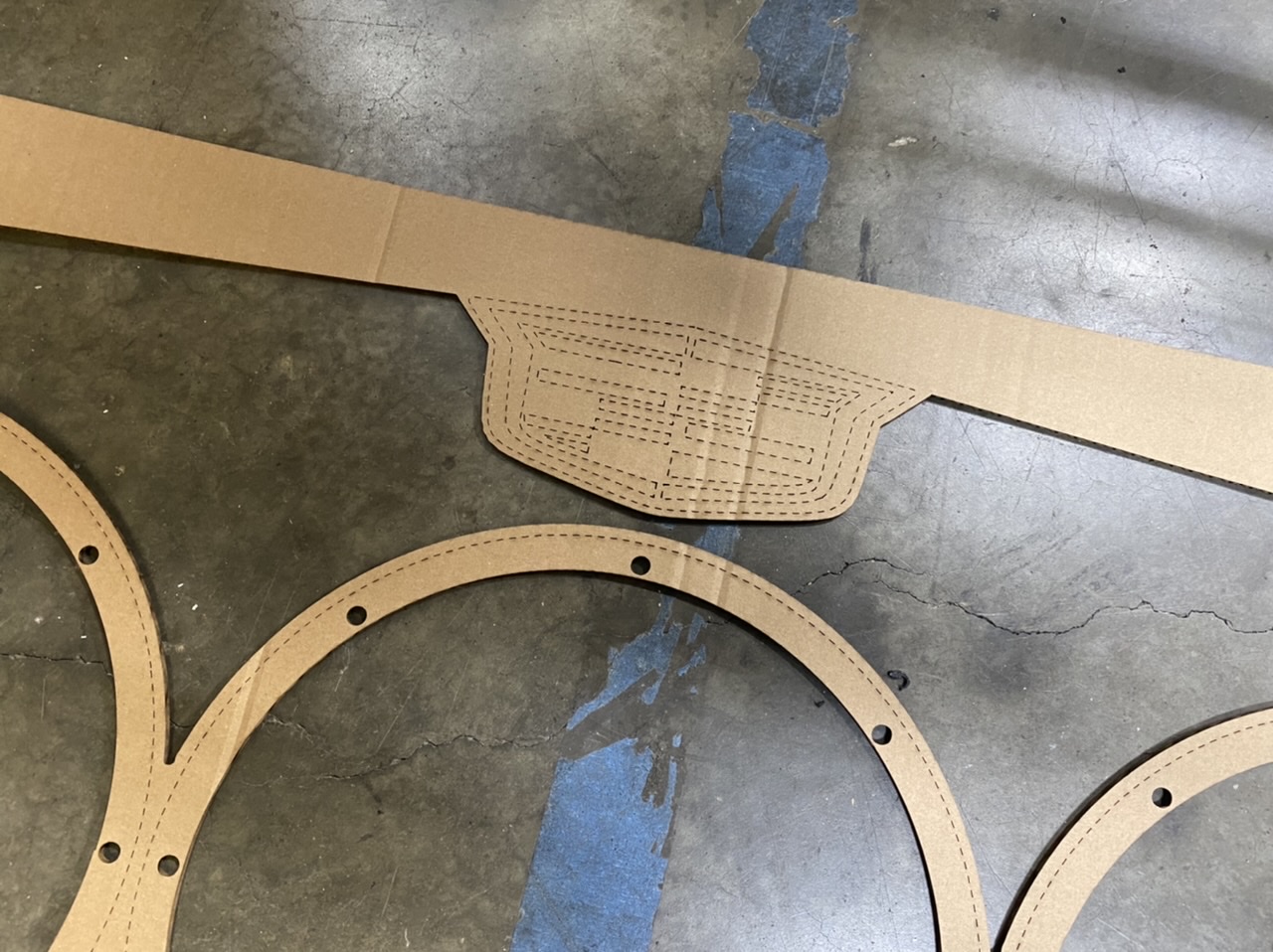

Just a perforated logo so i know where it will be and what size it will be.  When it is all said and done i am planning on doing a inlayed black and white acrylic logo here.  I will cross that bridge when i get to it though. Like i said, these are all just idea's and direction.  It is totally subject to change and it will.

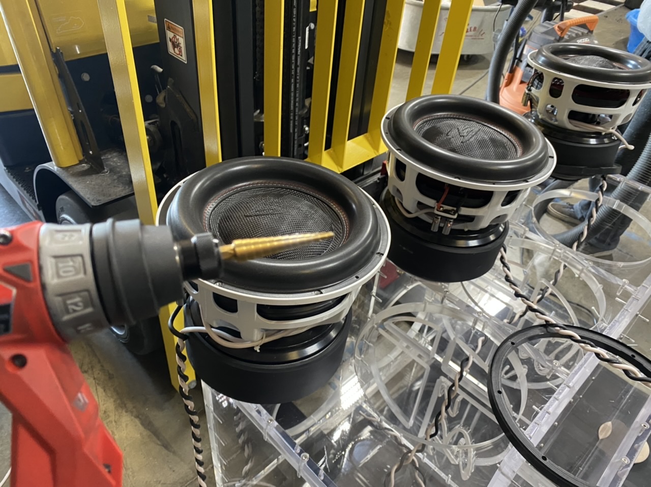

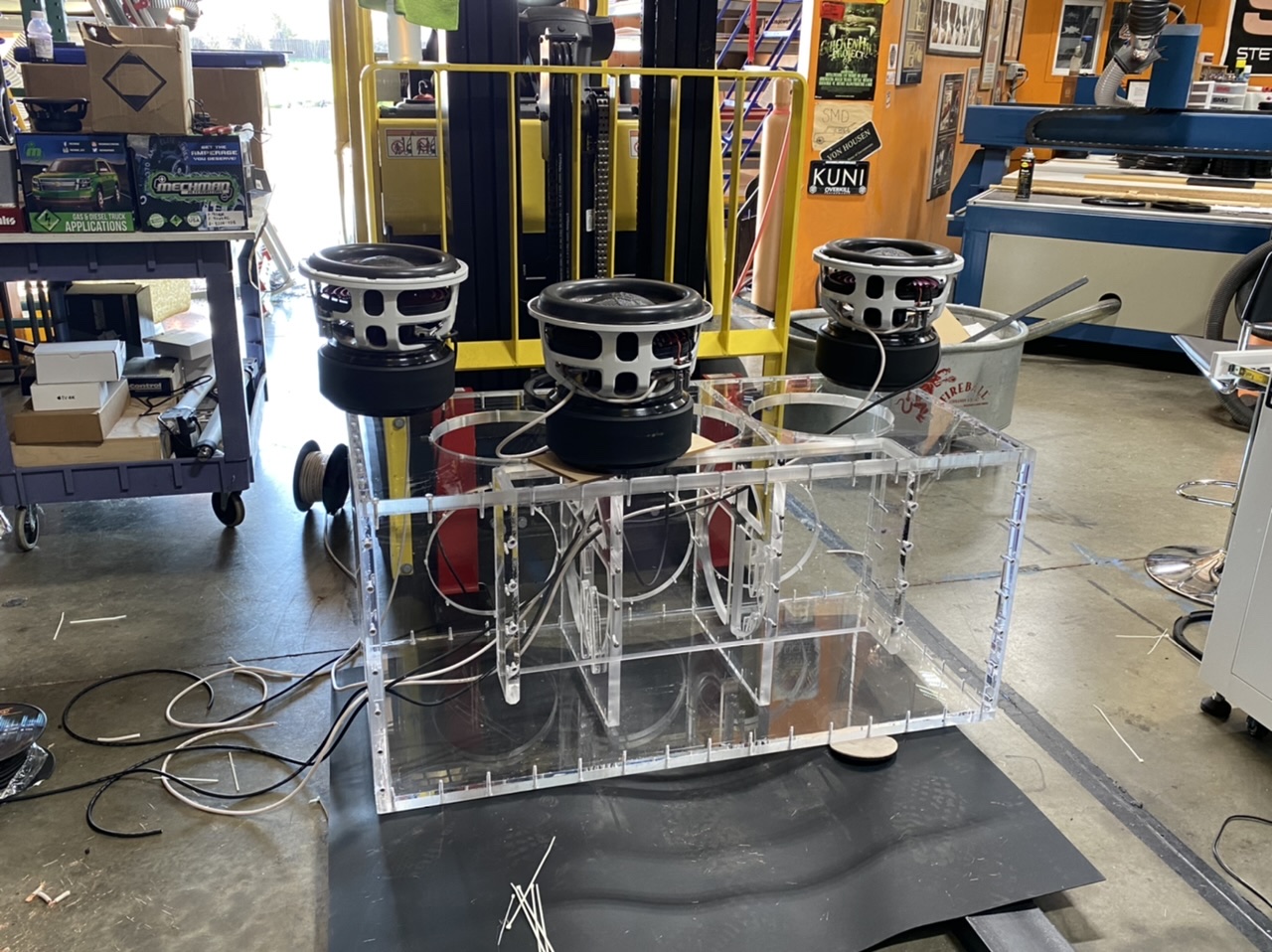

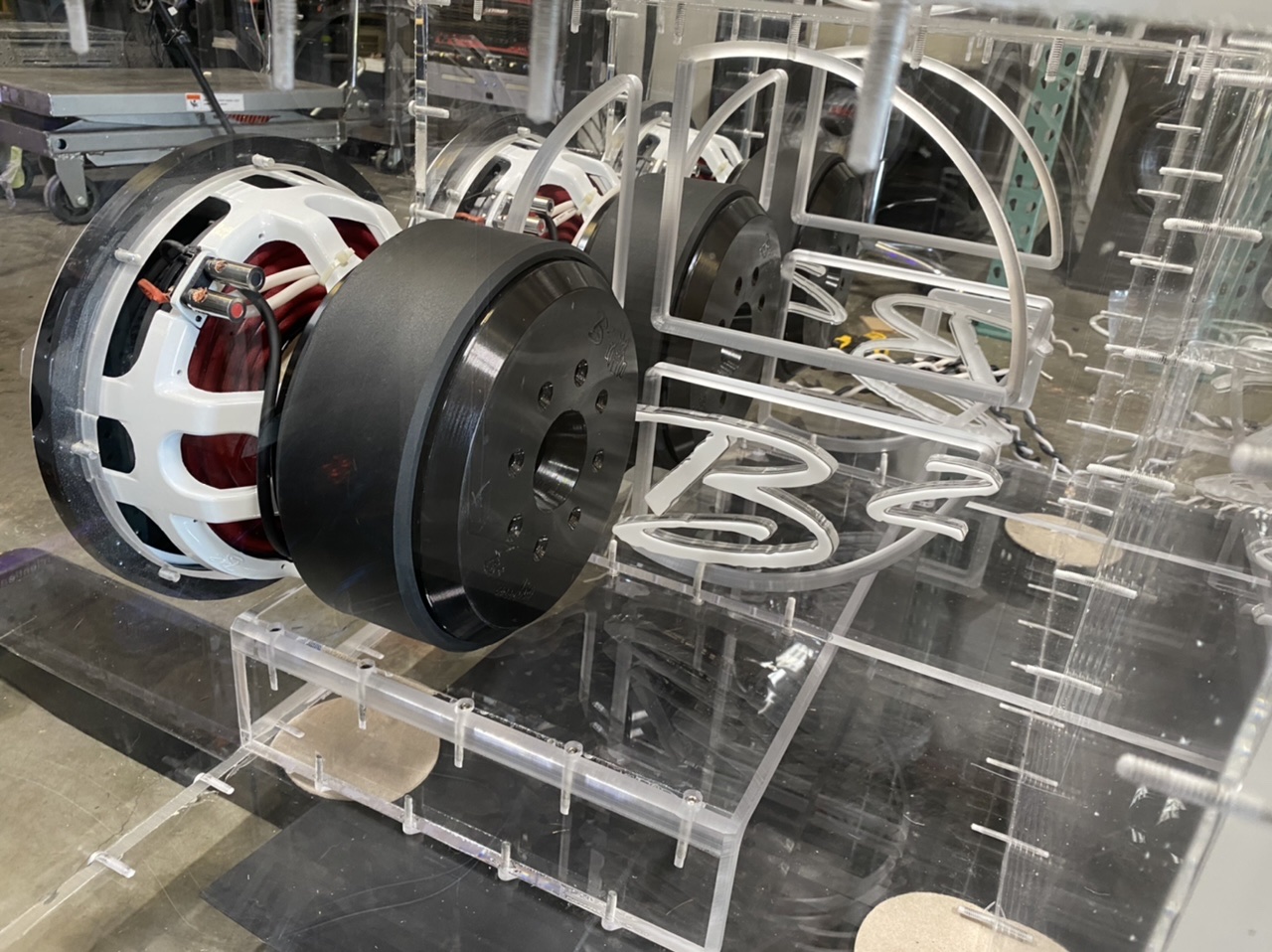

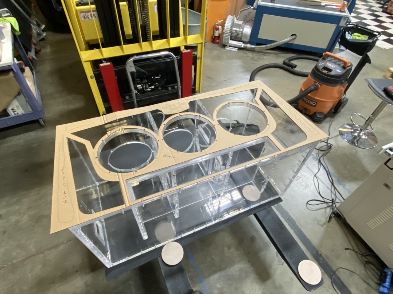

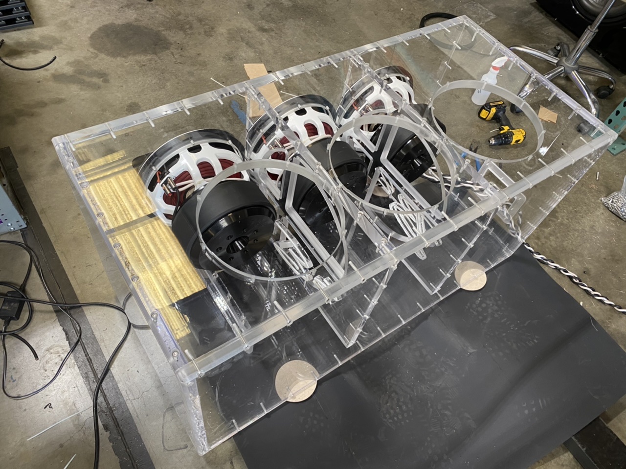

This trim will serve 2 purposes. I am going to mill out some channels on the back side of it so the LED's have a track to sit in. They will shine into the edges of the box and their ugly back sides will be covered by the trim (because they are in the channel).  Also, the subs motors just BARELY touch....i don't know how i messed that up. But the trim will also be a little spacer as well to take care of that issue. There will be LOTS of open area to see inside the box.  It will have mirrors on both sides and the bottom (from the outside aiming in through the clear panels).

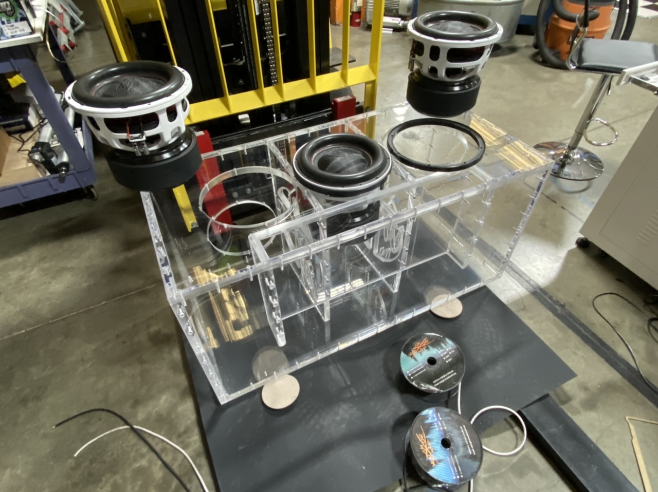

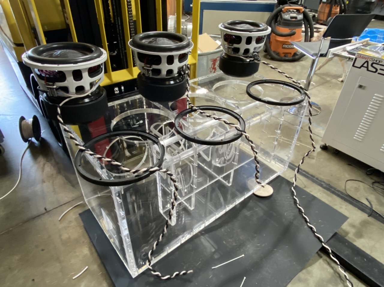

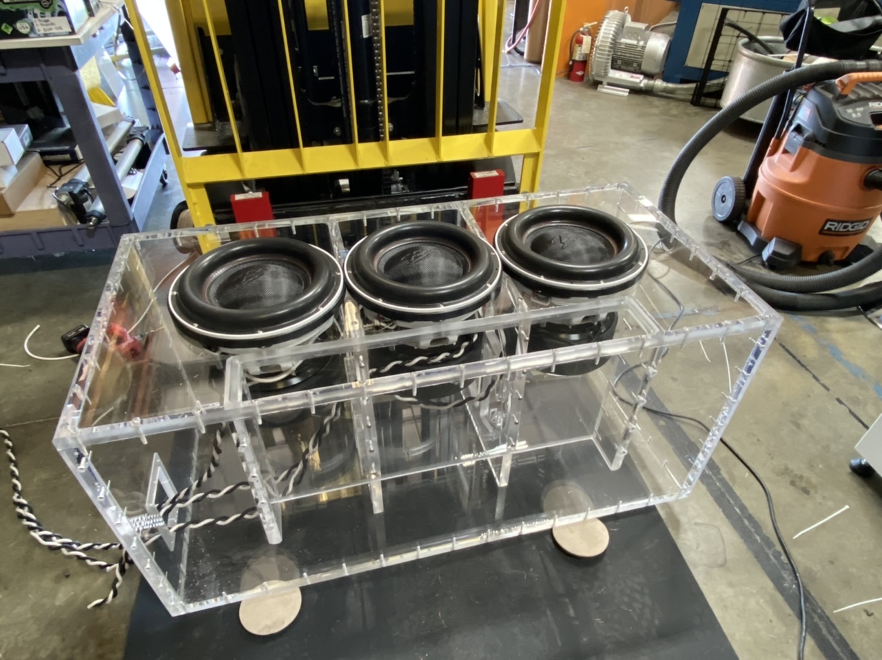

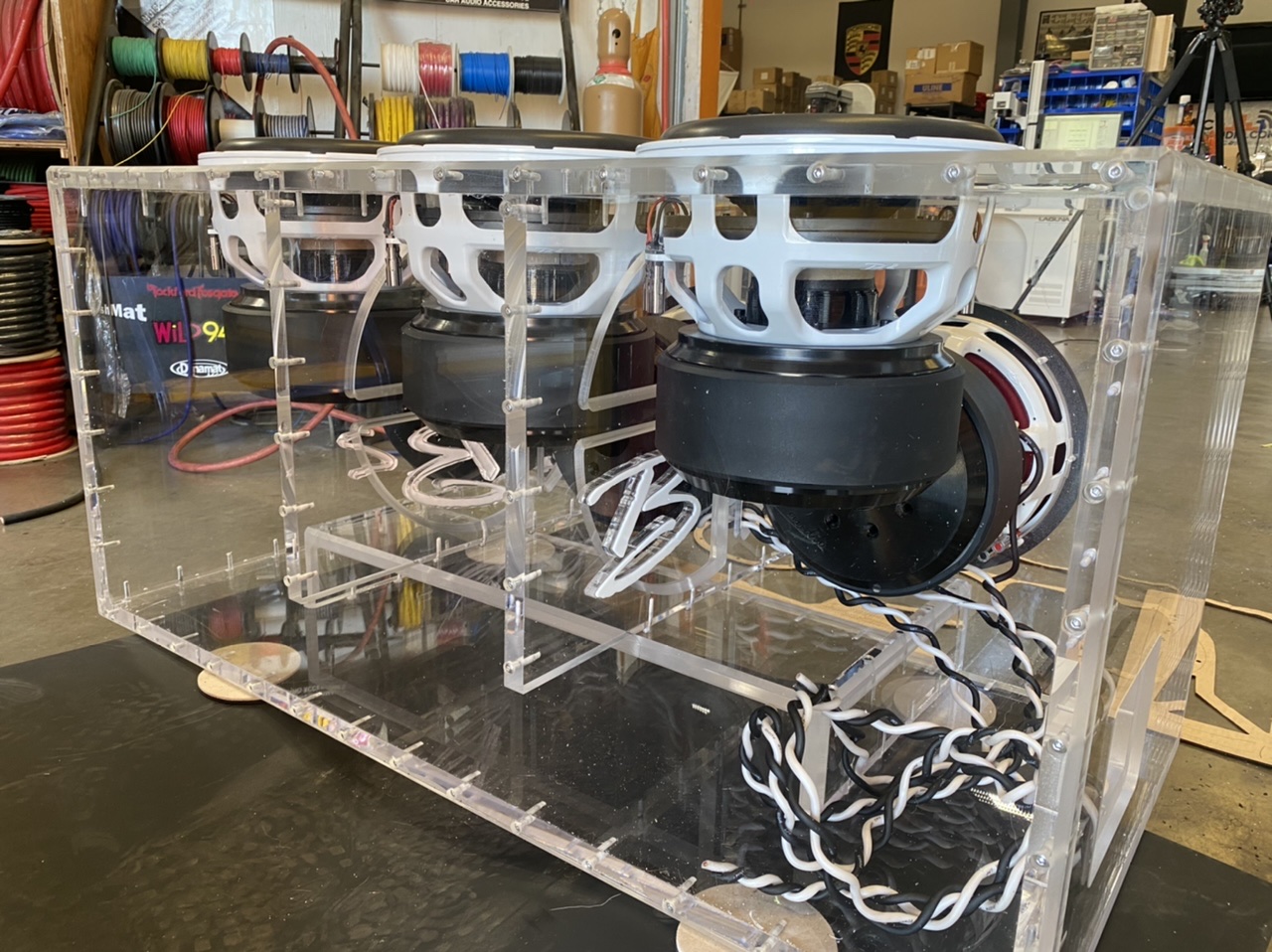

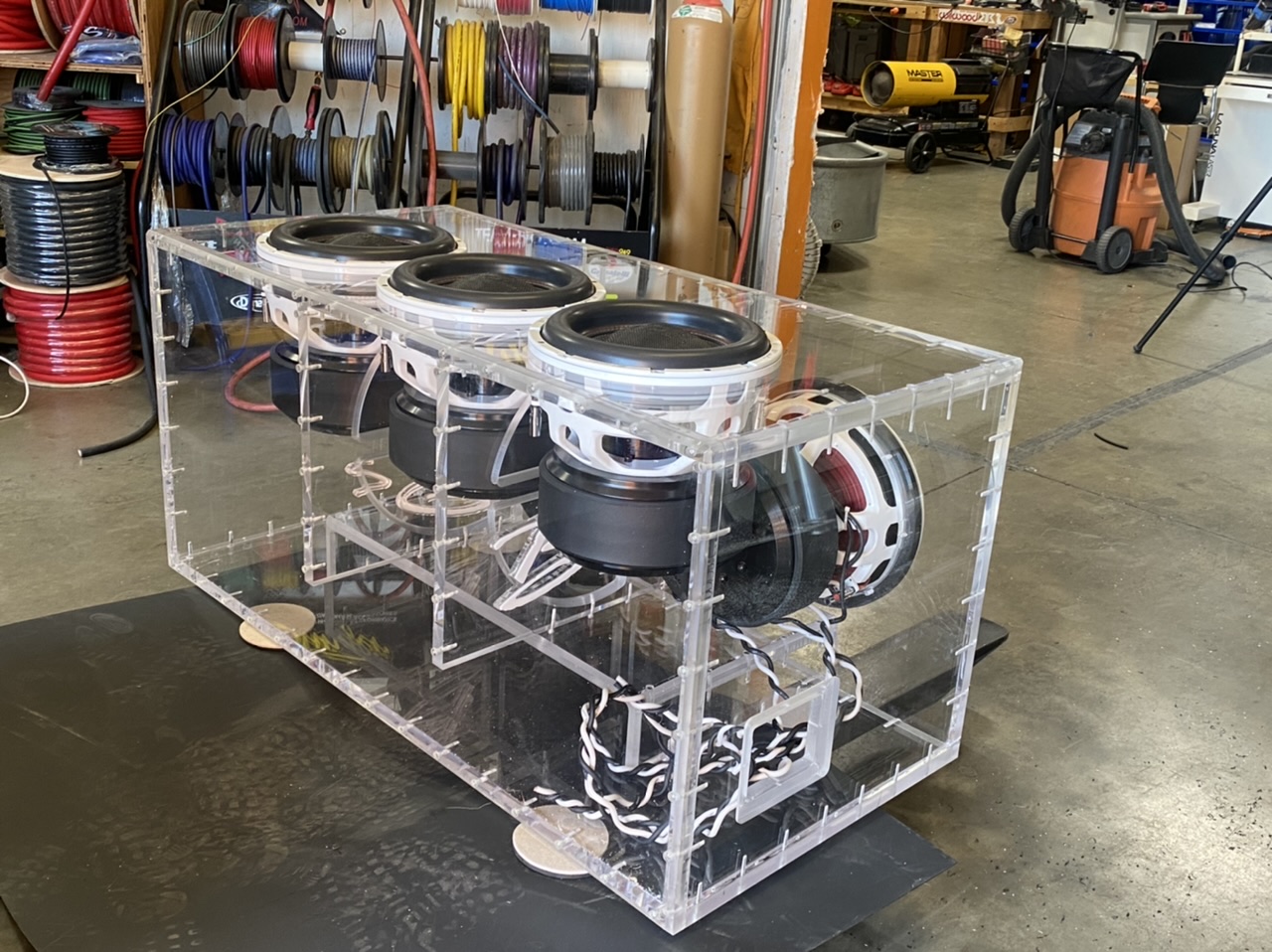

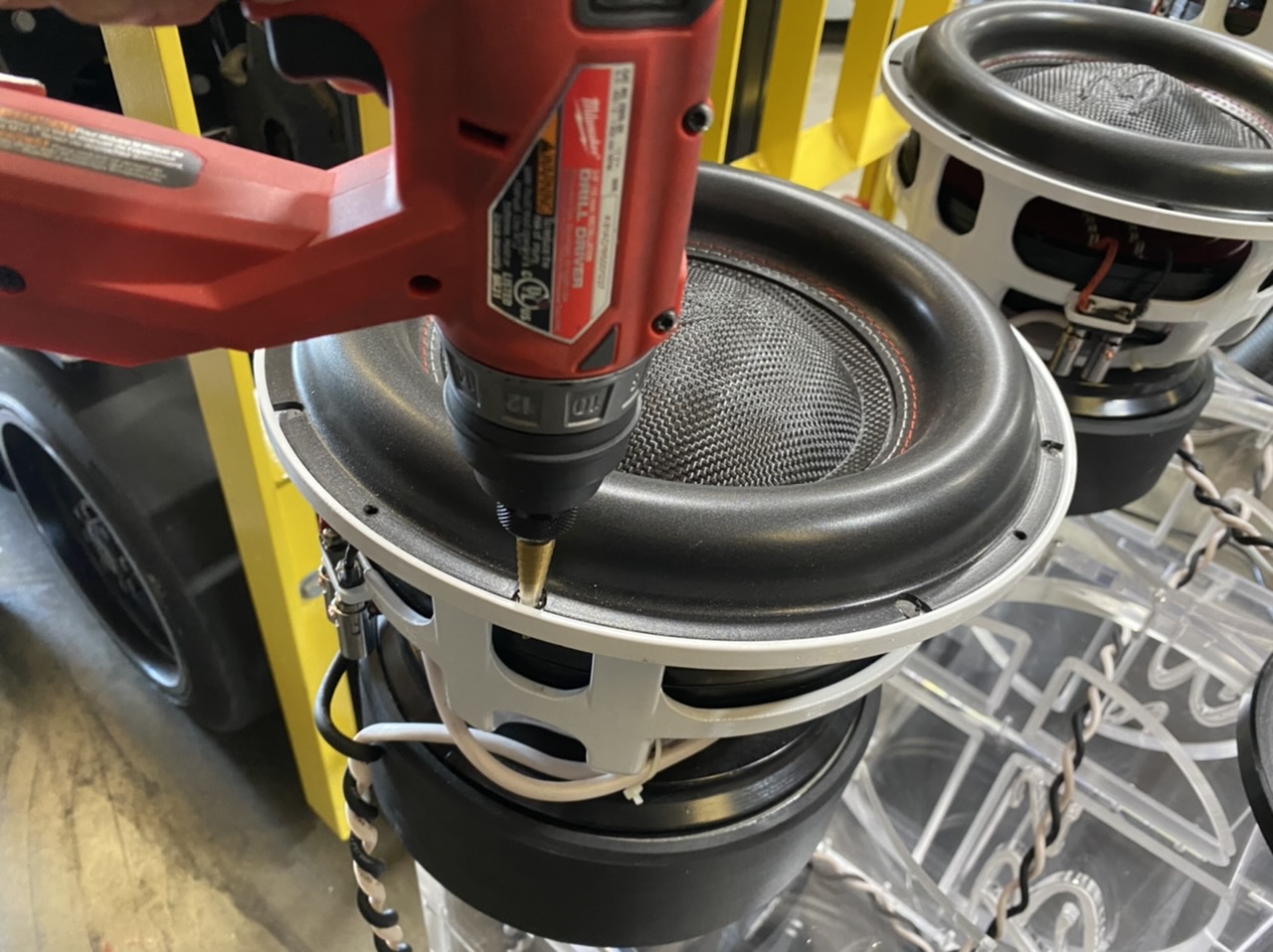

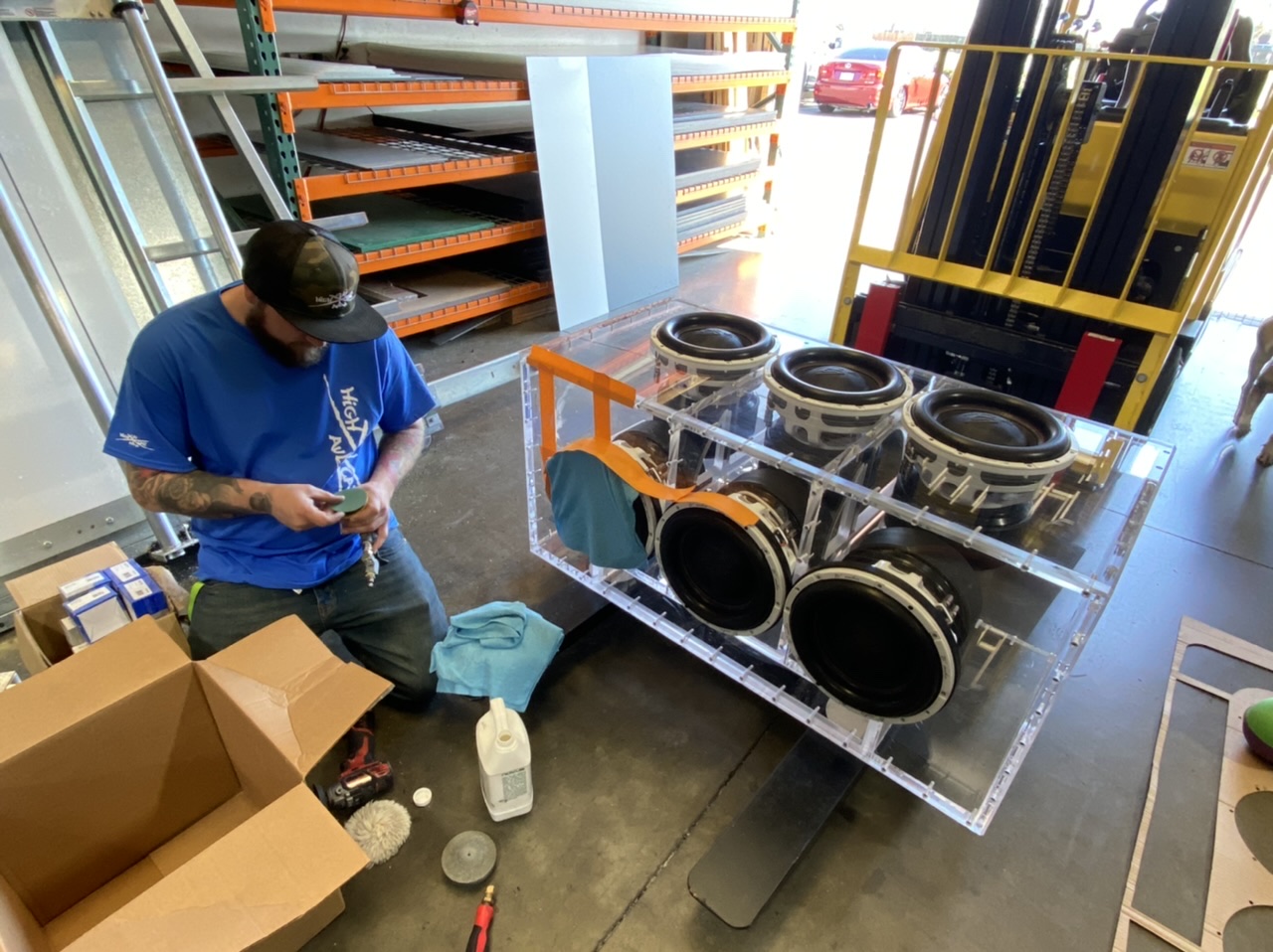

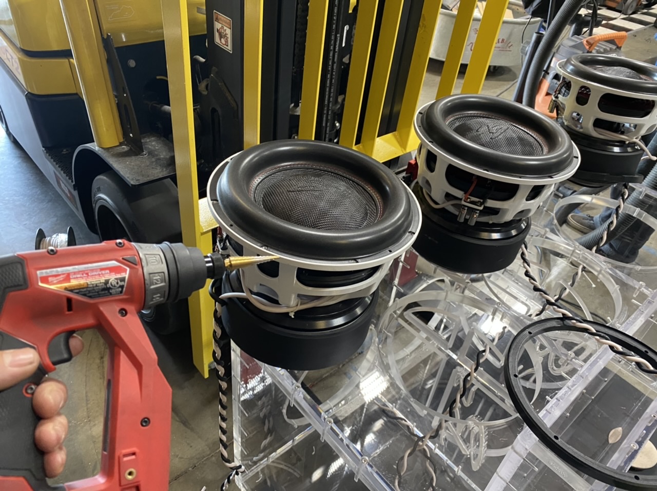

i had to make some spacers as my small miscalculation caused the motors to touch. This fixed it.

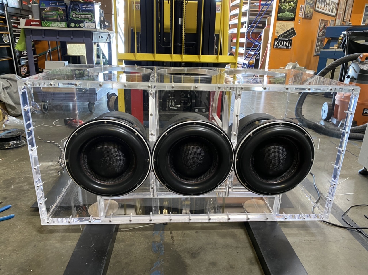

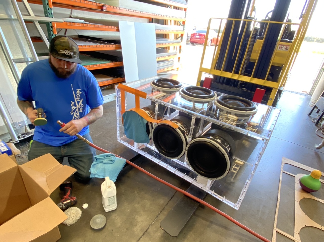

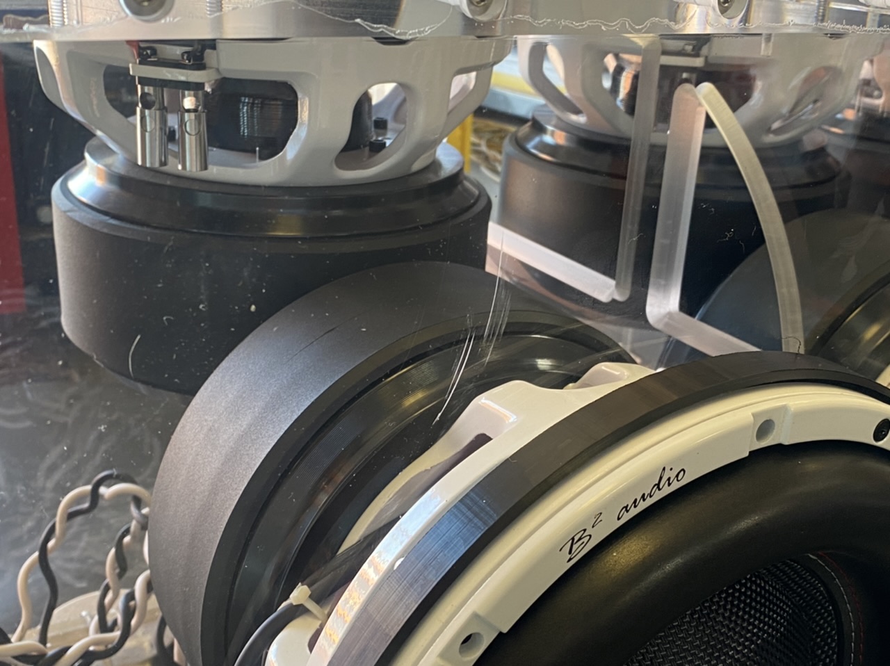

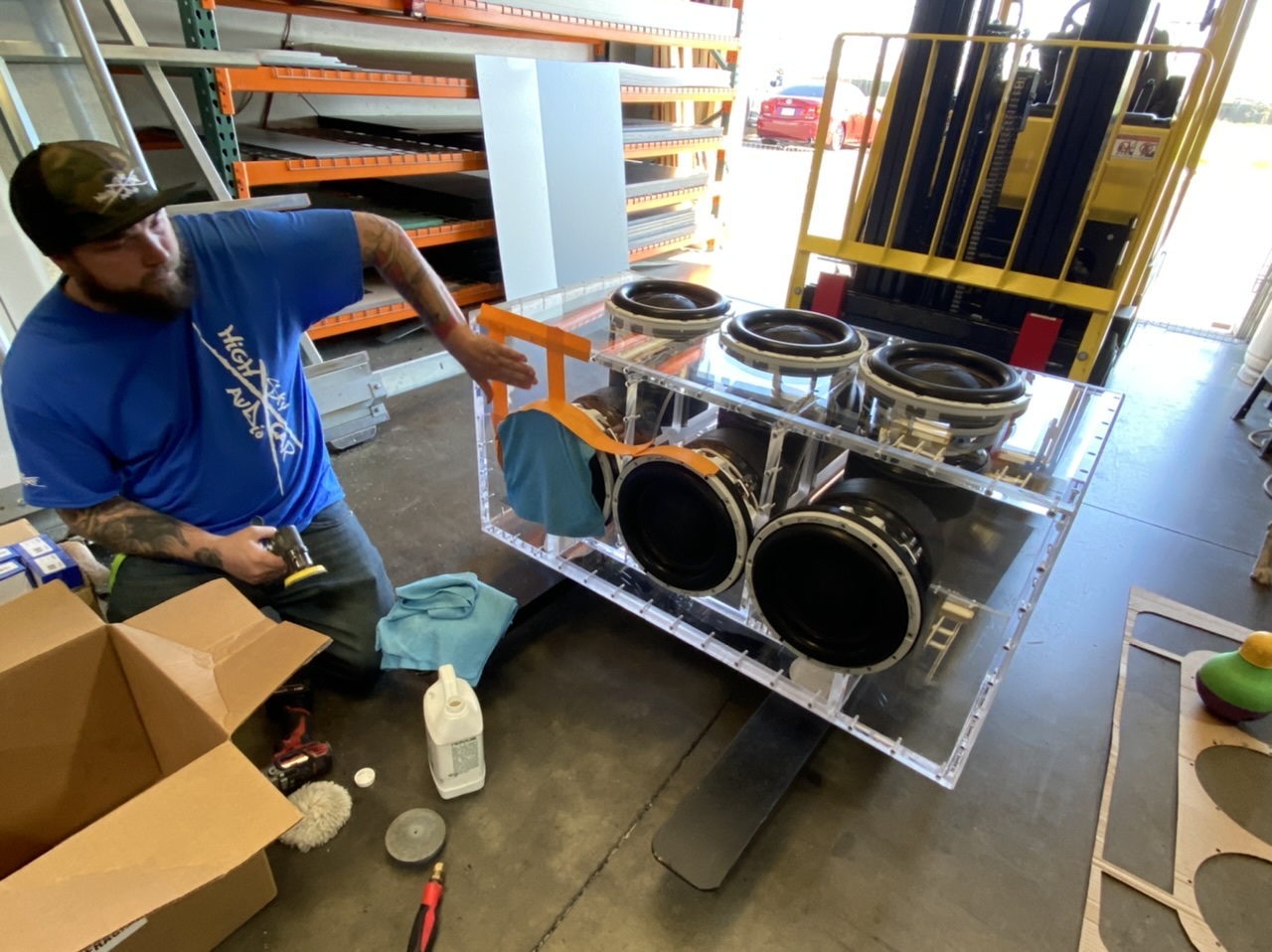

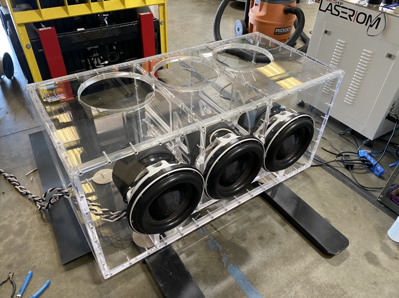

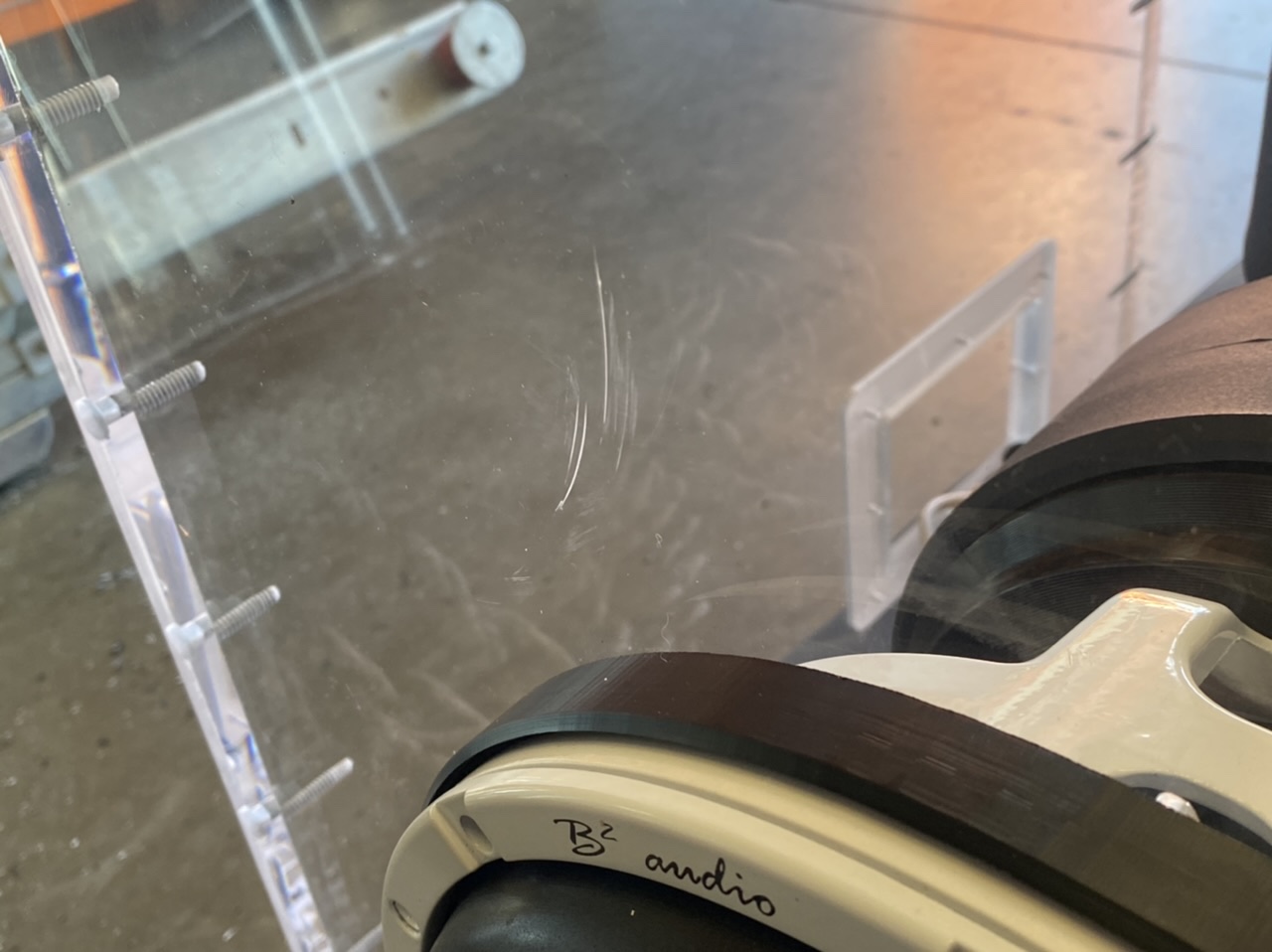

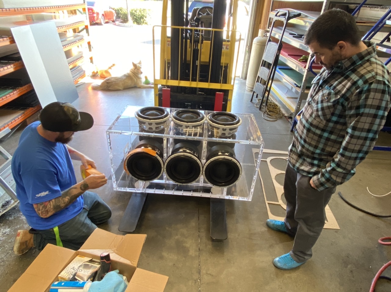

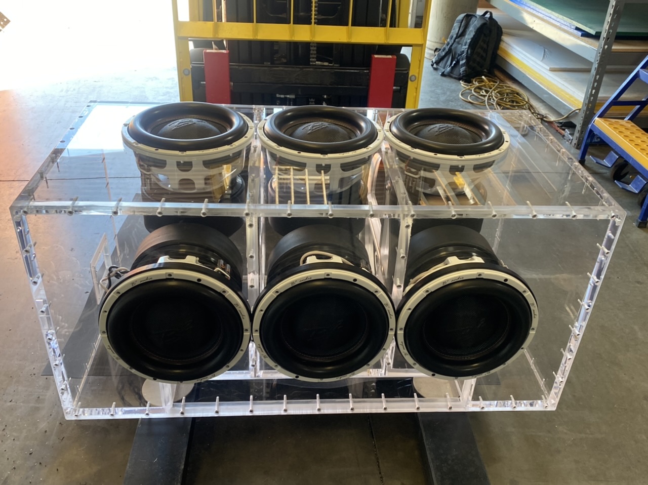

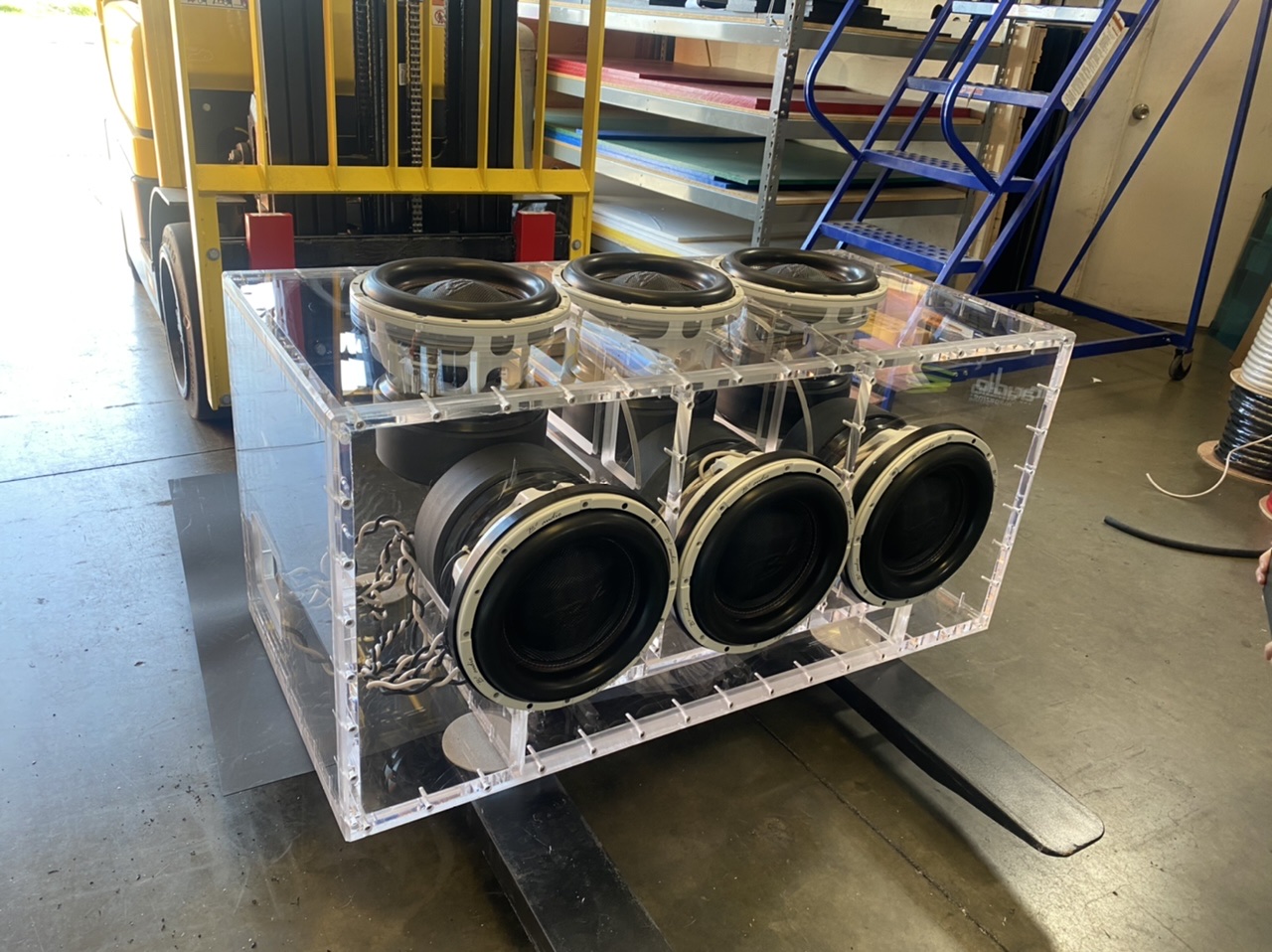

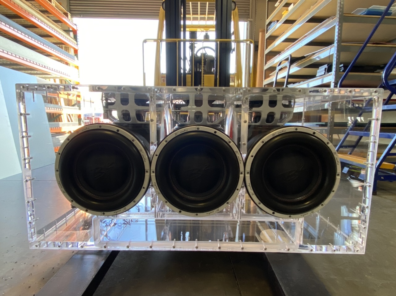

ohhh man i put a decent sized scratch right in the front of my box 😭. I called up Bobby Gately for emotional support and within 30 minutes him and the bro Colt came by and fixed it. These guys know exactly what to do since they do so many acrylic boxes. Thanks Colt! Bobby too! It came out great!
