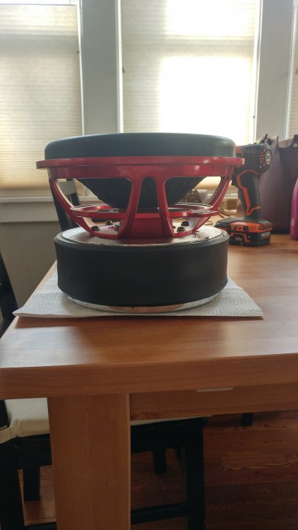

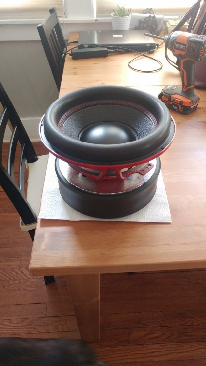

bmwking Posted February 9, 2018 Report Posted February 9, 2018 As the title says. With this little beast I'm making I want to put it in the best box to really help it shine and get an idea of what it's capable of. I'm assuming all the T/S specs change or go out the window with a frankensub, so what would be the best way to get close to figuring out what i should do? since I'm making a 10" with a ct sounds Meso 12" motor, should i just figure out the best enclosure for a meso 10" and 12" and then split the difference? Forgive my dumbs, I'm still learning Pics for... well because i'm already in love with this thing and you should be too haha

WalledSonic Posted February 9, 2018 Report Posted February 9, 2018 Thats def cheaper than an IMSG. Alternatively, you could borrow an IMSG. Michigan got plenty of bassheads. That motor looks like its gonna eat that basket alive lol Chevy Sonic Wall (4) 15's on 10k Build Log https://www.stevemeadedesigns.com/board/topic/209412-2015-chevy-sonicwall4-15s10klithiumlarge-case-hairpin-us-alts/ (4) Fi SP4 15's | (2) Ampere 5Ks | Active! | Arc KS600.2 & KS125.2mini | CDT Silk Domes | Silver Flute 8s | 240Ah JY | US Alts Jeep Wrangler JK (4) 8's in a 4th Order Build Log https://www.stevemeadedesigns.com/board/topic/209841-shadow-2016-jeep-wrangler-jk4th-order4-8sdc-35klarge-case-hairpin-us-alts/ IG @walledsonic
