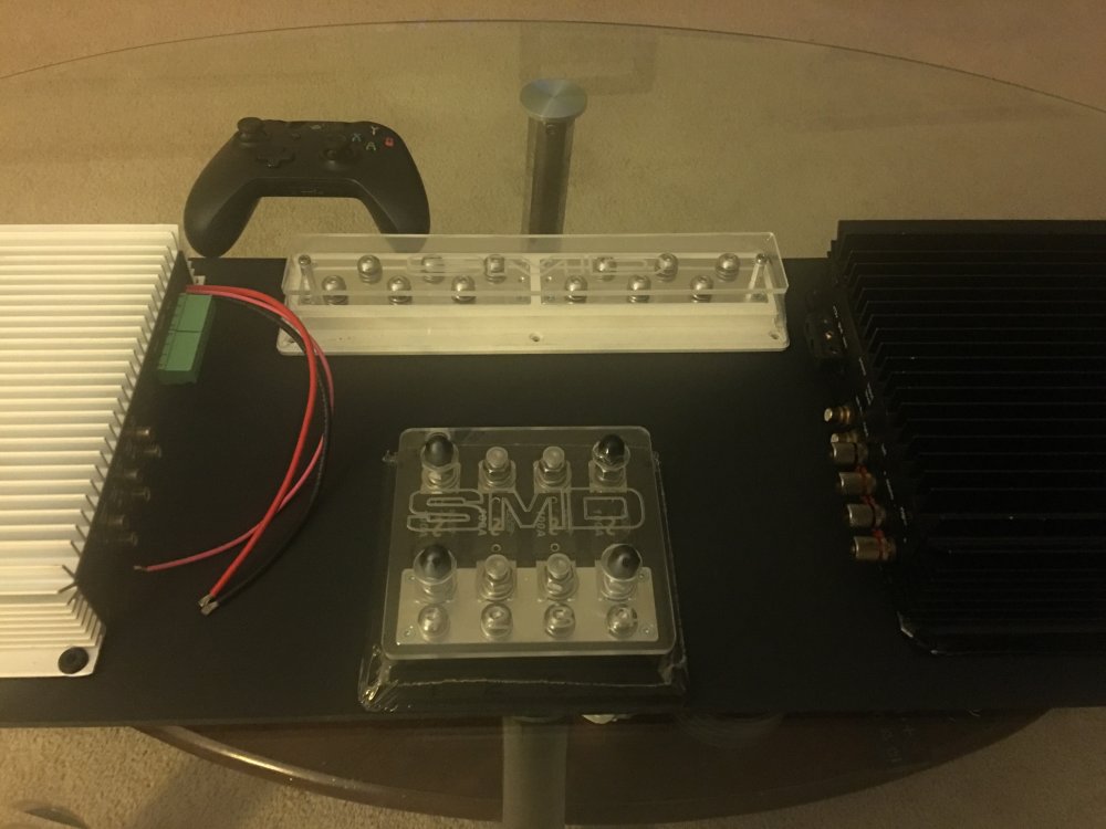

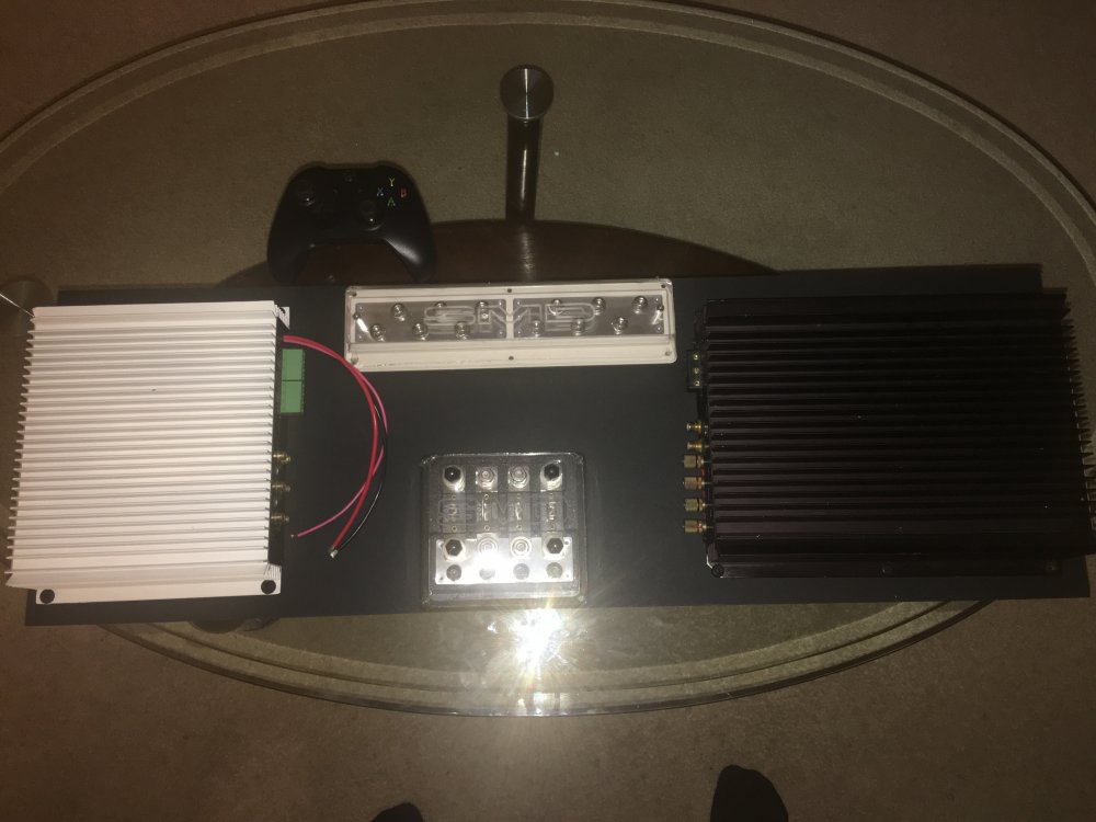

06RTCharger Posted April 8, 2018 Report Posted April 8, 2018 So i bought a half power and half ground smd distro block, AND bought the quad anl fuse holder. Thinking i would run a 1/0 pos-neg from my battery to the halfNhalf block, then run positve runs to the fuses then from the anl fuses to the amps? There will be one more amp later for the sub. But i dont need that positive half of the distro right? Because i have the anl fuse distro. Fuck i over complicate things, sorry. Just tryna lay this simple amp rack out. Also i have a doule anl distro for under the hood. One fuse for the alt charge wire and the other fuse for the run going to the back of the truck.

06RTCharger Posted April 8, 2018 Author Report Posted April 8, 2018 Yah see i dont think i need the dual power distribution either. Its a smaller build. One highs amp for the 2in wide-range drivers in the dash. One mids amp for the 6.5 in the door and one sub amp(not purchased yet). I will only have one run of 1/0 coming from the single front battery to the amp rack, one power one ground. So ill have a dual anl under the hood, one quad anl at the amprack. All i need after that is a ground distro for the amprack, no need for another power distro right? I just ordered a single (6spots) SMD ground distro off the amazon store. Probably sell this halfNhalf block later.

Skullz Posted April 8, 2018 Report Posted April 8, 2018 Over thinking no, getting too much, maybe. The only trick you need to do is buy what you need, and only what you need, anything more is overkill and wasting money you could have spent elsewhere. Pencil and paper drawings will help you get a visual and idea on what all you need, plus it allows you to look back at some of the ideas you had running through your head at any given time. 01 Ford focus ZX3 Pioneer AVH-X491BHS PPI PC 4800.2 Morel Maximo 6.5" x2

06RTCharger Posted April 8, 2018 Author Report Posted April 8, 2018 9 hours ago, Skullz said: Over thinking no, getting too much, maybe. The only trick you need to do is buy what you need, and only what you need, anything more is overkill and wasting money you could have spent elsewhere. Pencil and paper drawings will help you get a visual and idea on what all you need, plus it allows you to look back at some of the ideas you had running through your head at any given time. Lol yah i think i got more than i needed. When i drew out plans, i was drawing the power block AND the anl block in my plans lol. Just a lil lack of car audio knowledge, still a noob but im learnin. I knew my plan was wrong when i had it laid on my table like that in the pic, and i was thinking about all the connections there would be just for power. Thats when i realized i might not need the power block half of that distro. So i could go with a smaller block just for grounds.
