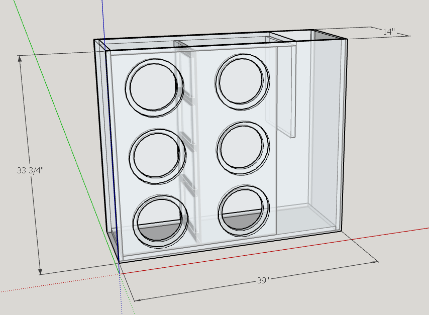

Would something like this work?
Its 6.78 cu ft net (DB Drives recommendation) tuned to 33 Hz with 100 sq in of port area.
Builds:
thank you and yes it would but could it be turned to where the subs were as close to the bottom same face they are on now and the port at the top middle facing the same direction as the subs.  if not then could the port be put in the middle and 3 subs on the left and 3 on the right with the port facing up.   ( i have ocd and like stuff symmetrical.)
doing it as pictured the subs would face the rear and the port would face up.  would this be an issue or will it utilize the back of my kia soul or would it kill it.
